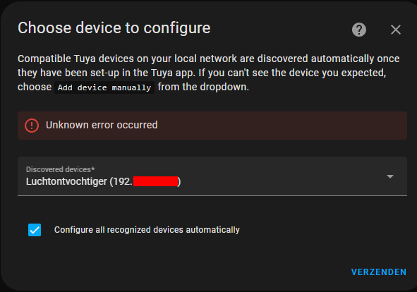

When I choose “Configure all recognized devices automatically” I get this error, this only applies to this device, the lamps and smart plugs work normally.
If I continue without “Configure all recognized devices automatically” I try “Discover device entities automatically”, but then I get an “error”

Should be fixed on master you can download master version if you want to test.
Go HACS → Local Tuya → On top right corner click on the ⋮ and choose redownload then select master

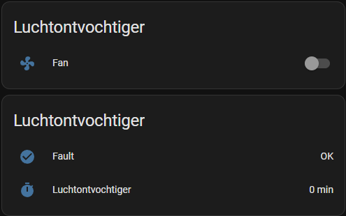

I can now do “Configure all recognized devices automatically” and no longer get an error message, but I am missing some entities because my lovelace cards are not good.
This is what I get now:
But this is what I get when I install the original Tuya integration:
