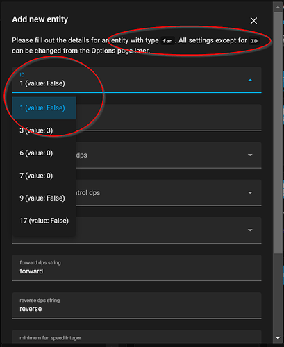

I am back again with my fan controllers and local tuya. I got it all set up and working right but then I later realized two fans were not working correctly despite them all being the same. I went through the setup and removal of these two problematic fans multiple times and I finally noticed something different but I don’t know what’s causing it in 2/6 fans.
First, all these controllers were bought at the same time about 3 years ago. They’ve all worked the same all this time. It’s only in the Local Tuya app that I’m having an issue. The fans otherwise work fine and as long as I don’t want to control fan speed, technically the fan controller still works (on/off).
This is what I noticed:
On a successfully running fan:
it says at the top editing an entitiy with DPS 1 and the fan speed control dps is 3 (value: 2). This configuration works flawlessly on 4 fans. No problem here.
Now, move onto the Bedroom and Den fans and when I try to set them up, they BOTH look like this every time despite them being the same device:
You’ll notice that at the top of this one, it recognizes it as a fan, but then doesn’t give me the option for 3(value: 2) which is required to give me the fan speeds.
I don’t understand why only these two are having issues. It’s consistent every time I set them up. Do you folks have any ideas or know where I might look to determine the cause/why it’s reading these similar devices differently?
long shot … on the Tuya app … is there a firmware update for the other 2 fans?
I just confirmed that all 6 fans are on the most recent/same firmware and tried installation again. Same results.
more long shots … there was a recent update to Local Tuya that broke some of my fans … and I had to re-install … did you do the update?
I think that’s the update that caused a few of my fans to break, I reconfigured them and copied them down and I thought they were working for a few days (despite me noticing the difference in the setup) and then realized some days later that the setups were behaving differently.
So I am on the most recent local tuya. Today, trying to fool with it and clicking too much I clicked ‘restore defaults’ in the API Explorer which I idiotically thought would be basic settings. No, wiped them out of Tuya completely; no worries, I readded them, they now have a new ID and local key but I still get the same results on both of these and none of the others.
