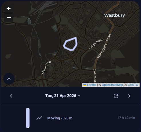

Quite often my card doesn’t show the start / end of my journey. See picture. I started and ended the route at ‘Home’, which appears in my Places location history, but is not shown in the timeline card.
Note that the moving duration is shown as 17 hours when in reality it was about 10 minutes!
I can confirm this buggy behavior
@LarryAlly, @stefan1982 That’s weird and shouldn’t happen, have you manually updated the stay_radius parameter?
Could you raise this as an issue in the Github repository, and then follow the instructions here to enable debug mode and send me the logs?
I haven’t updated the stay_radius parameter.

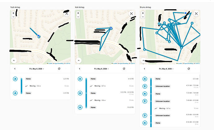

I just started using this project to track our cat's. And finally I get to see what they do all day. We have one male cat that roams allot, micro-distances just a few km around the house but multiple directions.
I have few questions I was not able to figure out can I make the map wider have bigger view as then I click on the timeline markers the map zooms out.
Any possibility of having an arrow overlay to show the path of travel, and 3rd question would it be possible to see numbers on the map way points that would simply show order of traveled point. All these feature are really geared to a "pet tracking" mode.

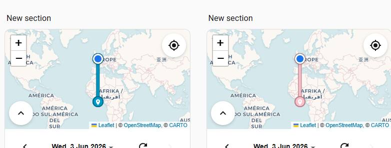

Sometimes the location reported by the watches is Latitude: 0, Longitude: 0.I guess this happens when it couldn't lock a location. So my timeline has jumps to that spot in the Equator. I am attaching a picture:
For some reason the default HA Map card shows the timeline fine without the jumps to the (0,0) points.
I see there is a mention of max_reasonable_speed setting but it doesn't show in the visual editor. I added in the YAML code but made no difference (maybe I am not using it well?).
There are no planes capable of moving at that speed from England to (0,0).
How could I fix that or is that something that could be fixed in the code?
Thanks

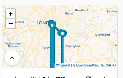

Here is another picture. I am new user and can only attach one per post.

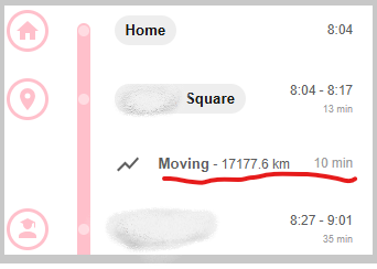

Says it moved 17177 km in 10 minutes.
And last one. All those lines go down to (0,0)
Could you follow the instructions in the repository for debug mode and send me the results? The fact that these points don't show up in the default HA map makes me think there's a slight error in the implementation, maybe it doesn't actually report 0, 0 but rather undefined or unknown.
I sent the email. Hopefully you have received it.
I have received it, but indeed I see the values are actually reported as [0, 0] not as anything else. In that case I'm afraid this is an issue on the SEtracker integration rather than in this card, and it should be fixed upstream, not in this card. The latest release does implement an outlier detection algorithm, but I'm afraid it won't fully solve your case, as there's a lot of reported [0, 0] points and I think there's actually a chance your regular data points will be seen by the algorithm as outliers rather than the [0, 0] points.

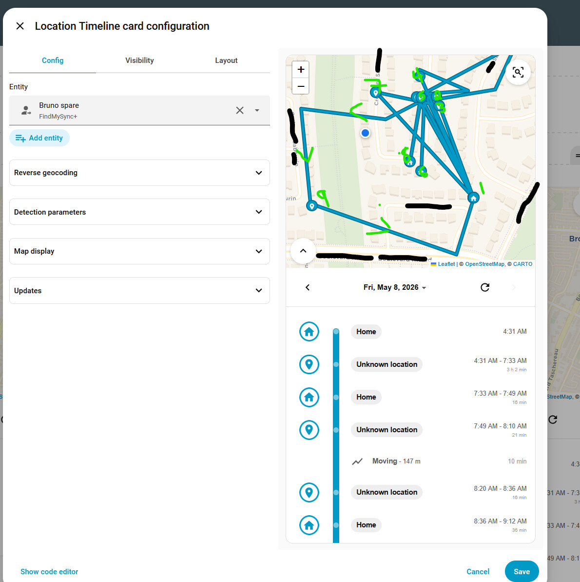

@konewka17 Before I create a feature request I thought I would ask if there was an easy way to accomplish this with card_mod or similar.
I have tried to inspect the elements for the location markers to distinguish between the start, and end locations but can’t see any differences that I can target with CSS.
I’m looking to color the last (and maybe first) location on both the timeline and the map as it is hard to distinguish where the person is at visually on the map.
Any ideas?
