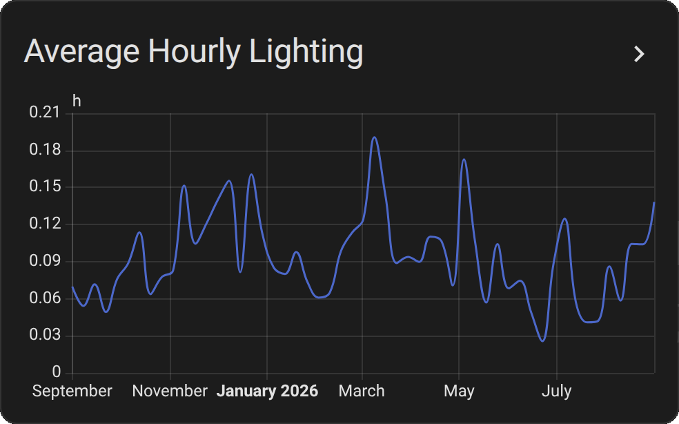

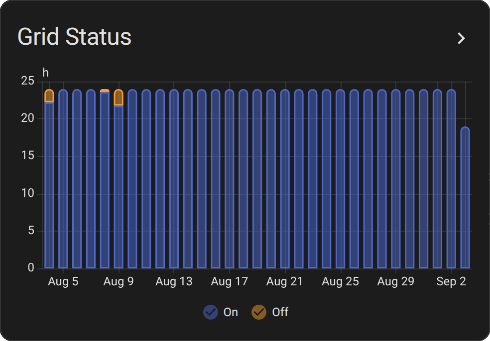

  • Discrete Statistics Card produces fully functional charts, with all states, in a few clicks
  • Also draws with the stock statistics-graph card: change for totals/averages over days/weeks/months

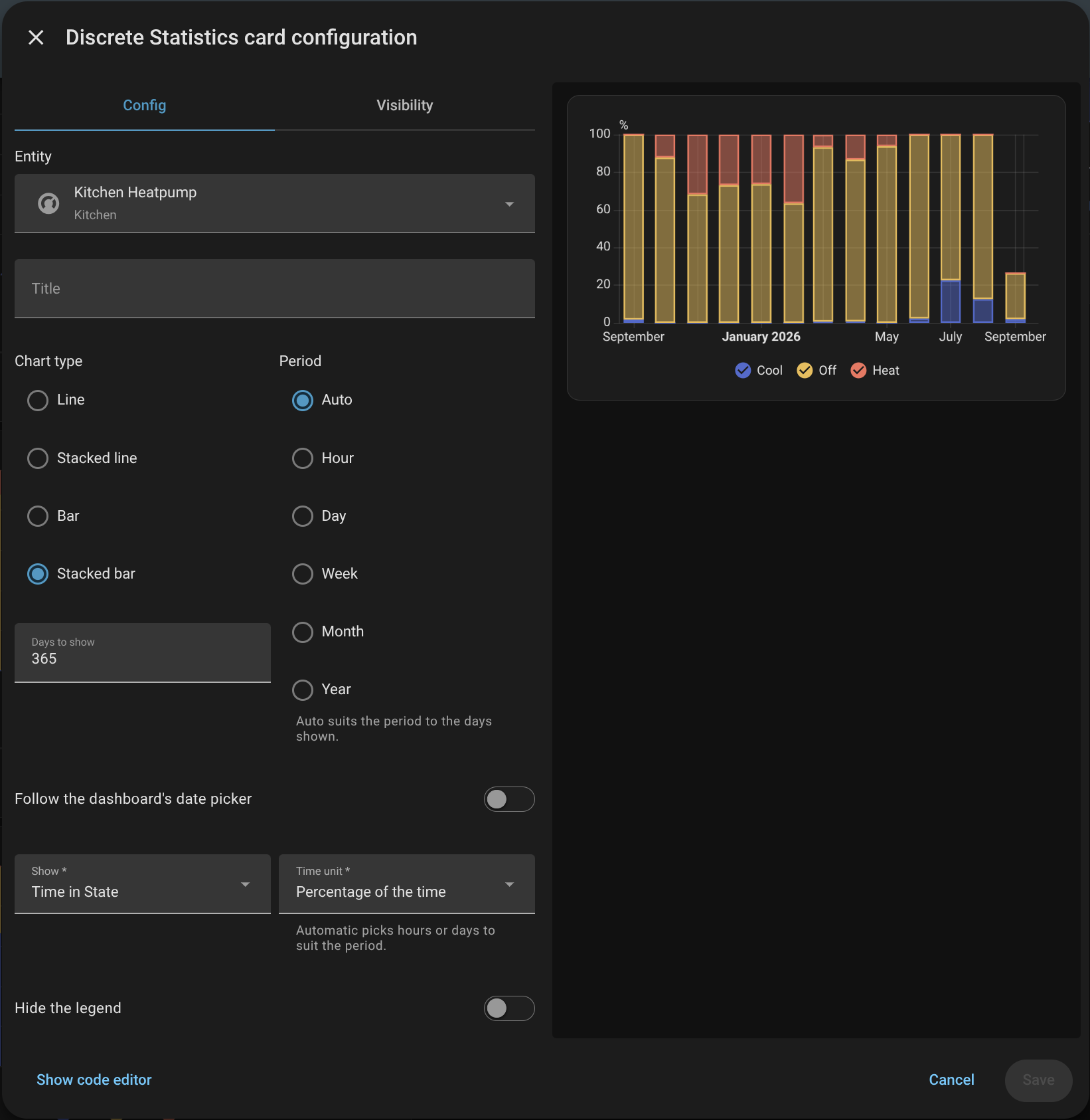

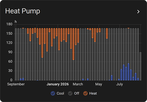

Yes - if you have a single enum you want to track over time, this will work perfectly. You can track the duration in each state and the number of times each state was activated over all history. Use the Statistics Graph card for now, and I’ll likely add a custom one to make config simpler (with Statistics Graph you have to manually add an entry for each state - but if the states don’t change this is a one-time job).
I added a custom card, that’s based on the Statistics Graph card, but makes it much easier to build charts for entities with many states. You only need to select the entity from the list (it will show only configured entities that generate discrete statistics), and it will pull in all states (even new ones as they appear).

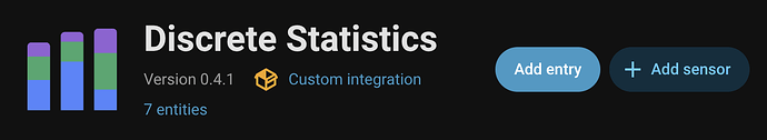

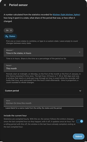

Open an entry on the integration page and choose Add sensor:
Add sensor

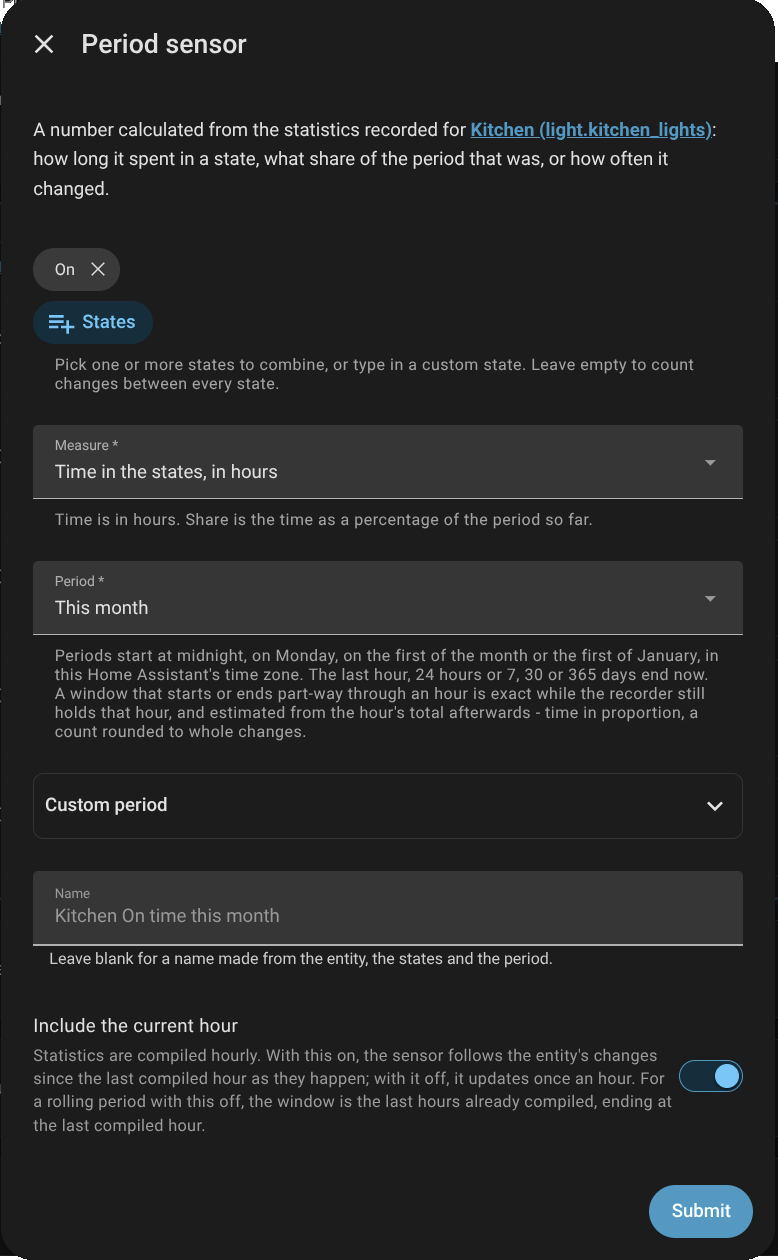

  • States — one or more (added together), picked from the states the entity has recorded, or typed in.
  • Measure — time in hours, share of the period as a percentage, or number of changes into the states.

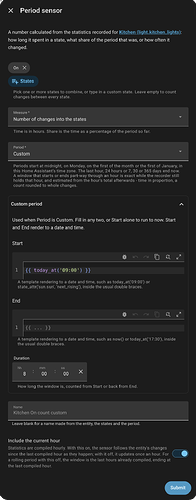

  • Period — today, yesterday, this/last week, month, year, all time; the last hour, 24 hours, 7, 30 or 365 days; or a custom window from start/end/duration
    templates, exactly as history_stats takes them ({{ today_at(‘09:00’) }}, {{ state_attr(‘sun.sun’, ‘next_rising’) }}).
  • Include the current hour — statistics are compiled hourly; with this on, the sensor follows the entity’s changes since the last compiled hour as they
    happen, so “time on today” is live to the second.
The sensor dialog
A custom window

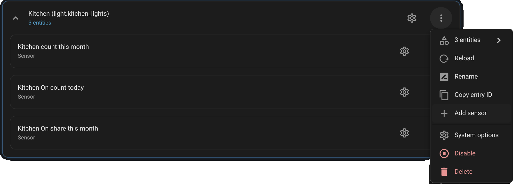

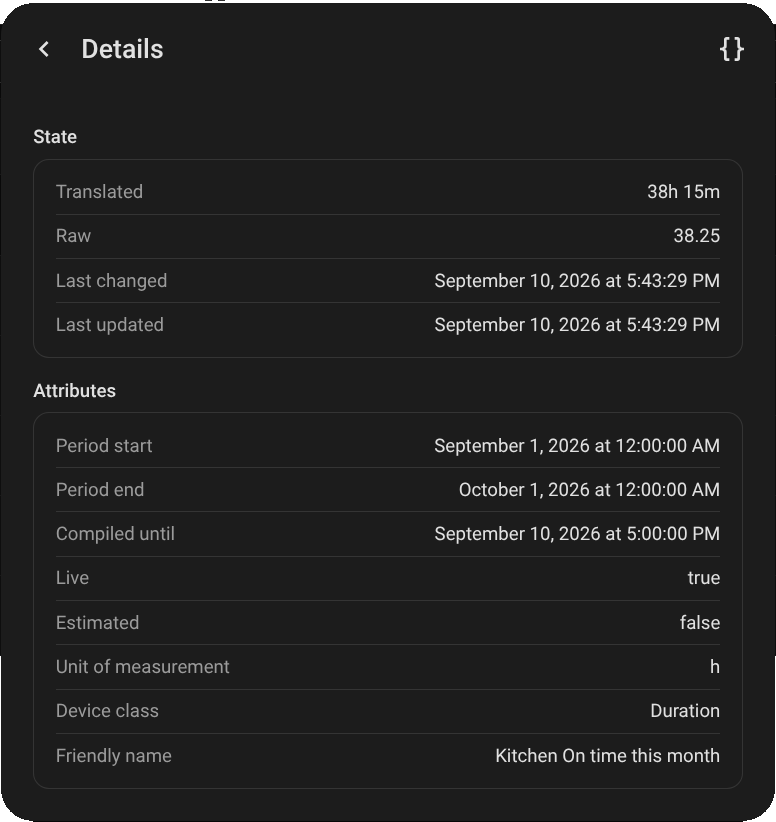

Each sensor is an ordinary entity — tiles, automations, templates — with period_start, period_end and compiled_until attributes. Sensors are attached to the
entry, so deleting one deletes it; the entry itself still has no entities of its own.

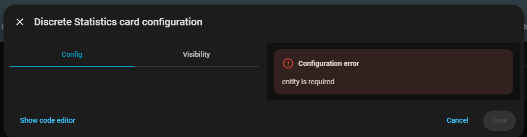

When I try and create a card, I am seeing this (on HA 2026.8.3). I can see the statistics for my entry in the stats page.
I also cannot get my head around the resolution it records by default.

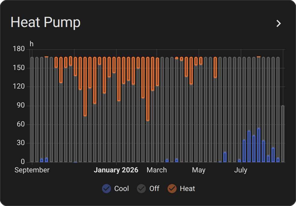

So for heating, I want to see further back than the standard 7 day for when the heating was on and for how long. Will this just show the same entity in history for longer?
You need to do a crtl-shift-r (hard refresh) in your browser after you restart HA with the new integration to refresh the cached javascript.
The history view will not extend past the default 7 recorder days (it looks at raw state changes), but the Discrete Statistics card will look back forever (once the statistics are built).
You also need to add an entry in the integration page, to actually record the statistics.

Actually there was a bug. Try 0.4.2 - and you should be able to create a new card.

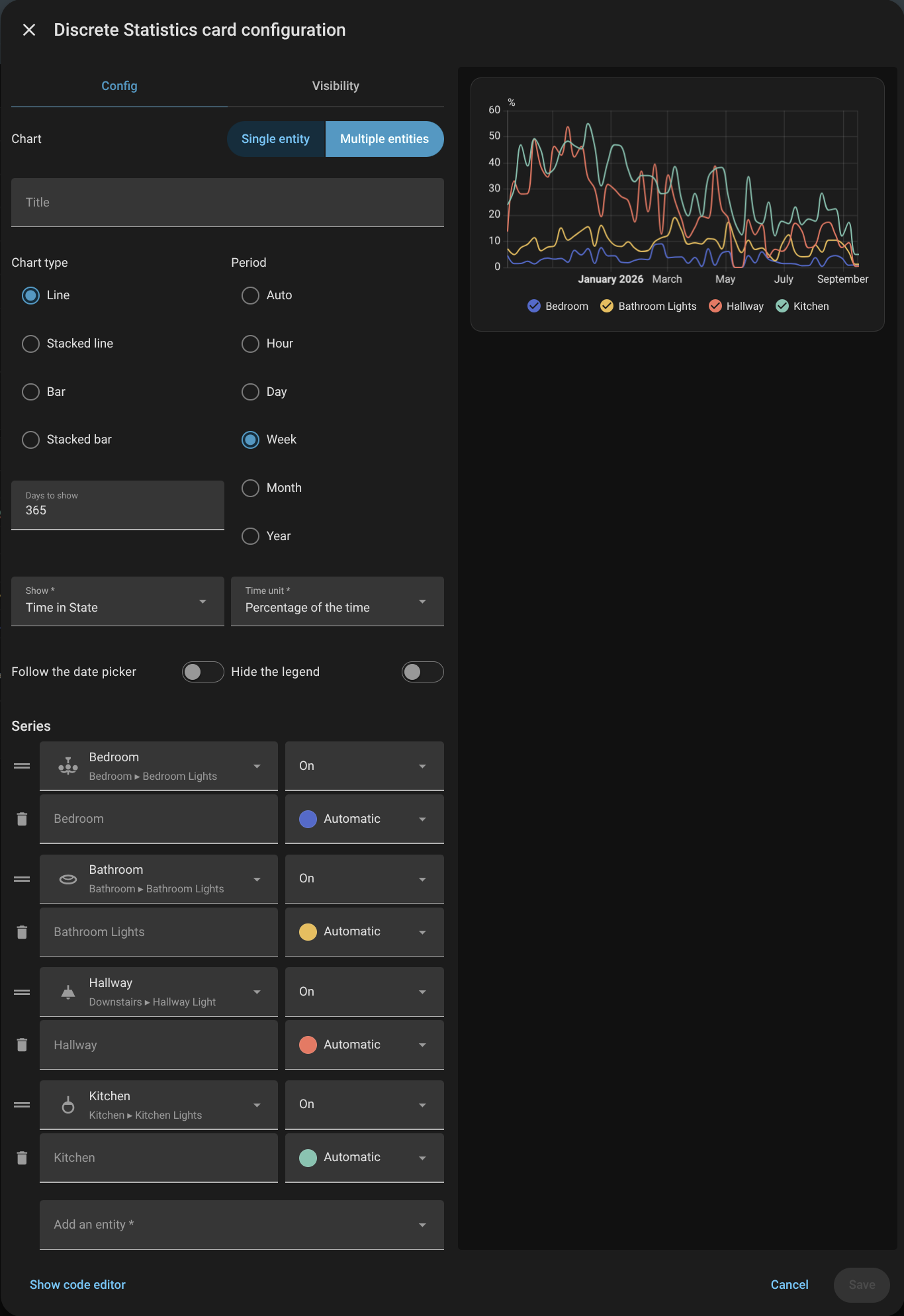

New release adding a multi-entity version of the card. It allows showing the same (or similar) state from multiple entities side-by-side (or stacked):
