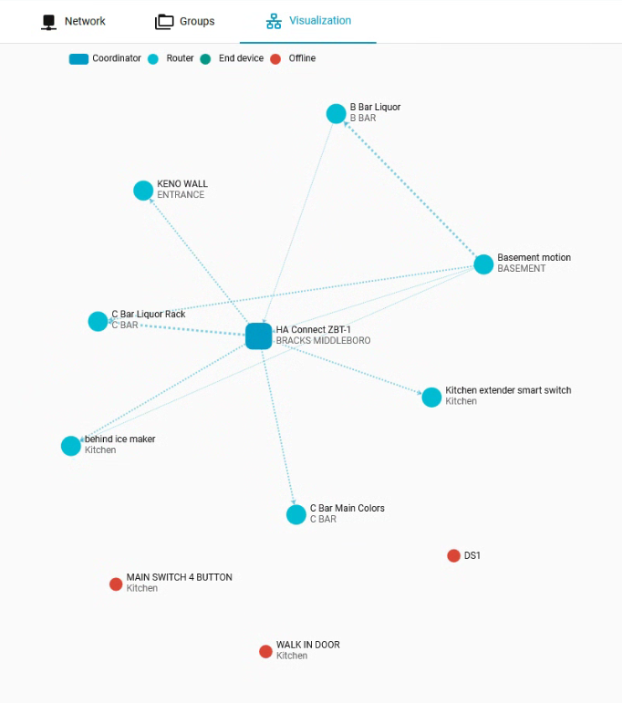

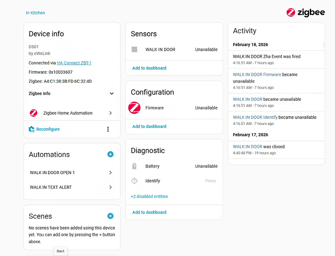

lately I am losing zigbee devices off the network, the zigbee stuff is fairly new to me and I have only started using them when i switched to HAgreen

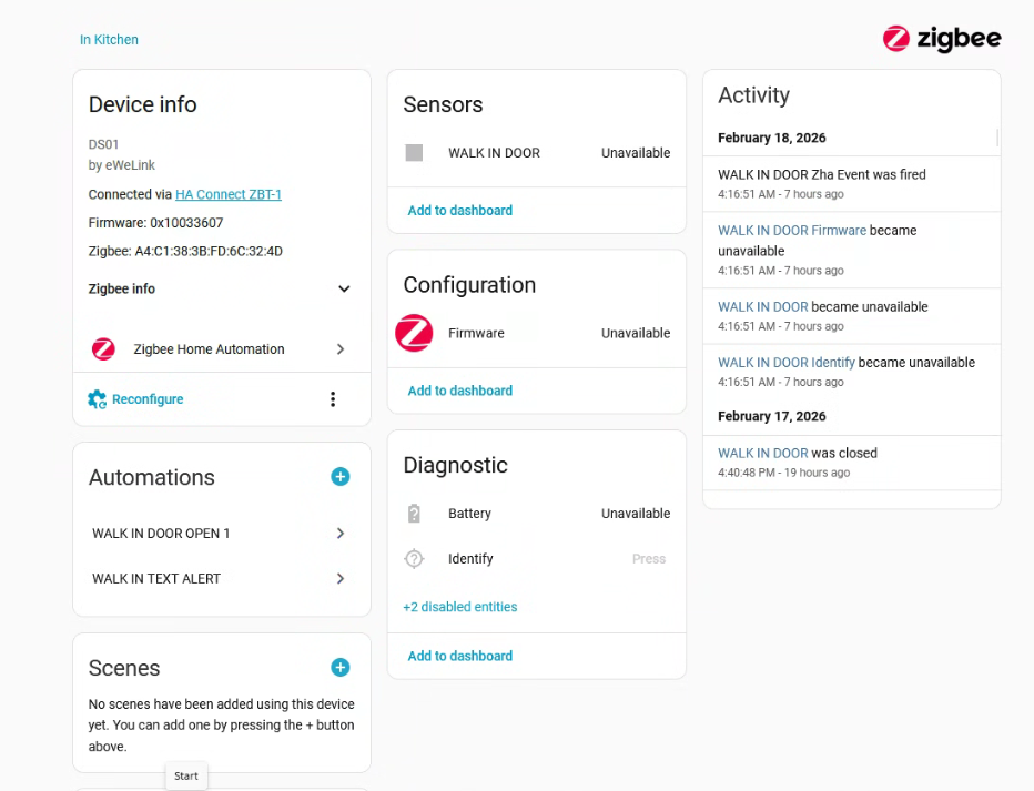

I have tried a few places to search but not even sure how to word the issue to research it, I have one of these running the whole back end of a very busy restaraubnt and one device im losing is the walk in cooler door sensor (with workers who cant remebr to close rthe door!)

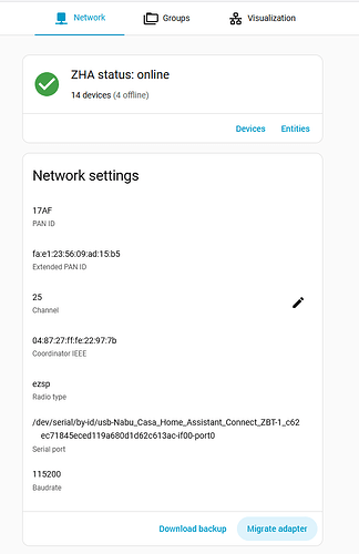

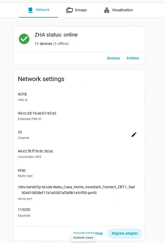

I saw one post about setting the zigbee network to channel 25 that slightly helped
In visualization I have devices not showing connections no matter how many reboots I do, some still work, most dont

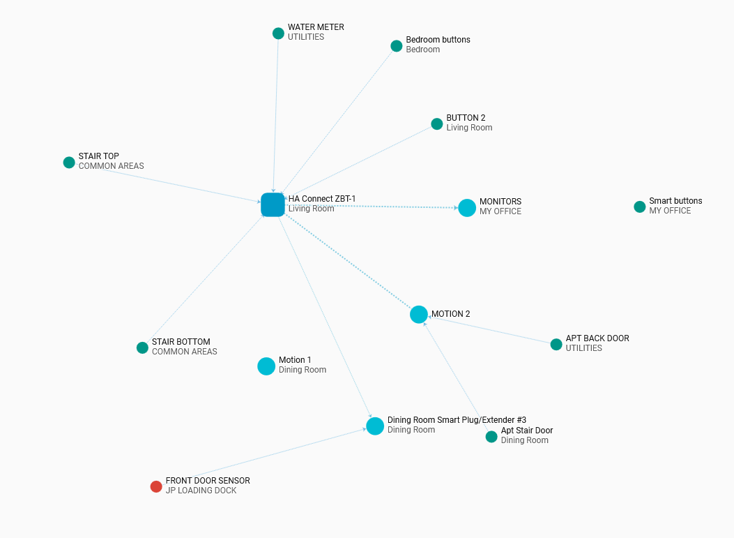

location1
![Screenshot 2026-02-18 110539|666x500]

Location 1
#2

location1 #3
location 1 #4

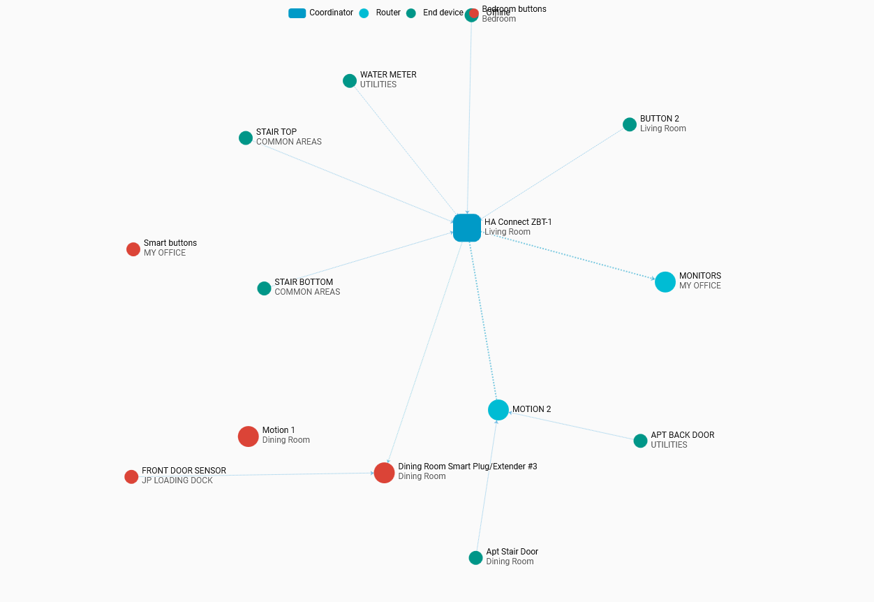

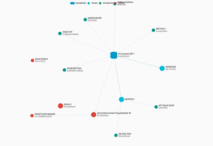

Location 2 #1
Location2 #2

yes thats one of the ones I have followed, But I have some devices that i put right by the main zigbee usb adaptor (the small blue dongle on usb extension cable commonly bought with the HAgreen) and it still adds just fine according to HA but still shows no response like its not even there. after working flawlessly for about a year now
also Location 2 #3
Its looking like im just possibly losing some signal. I have had location 1 for a little over a year now and no real changes but for both locations ill just start with more thirdreality smart plugs to act as boosters

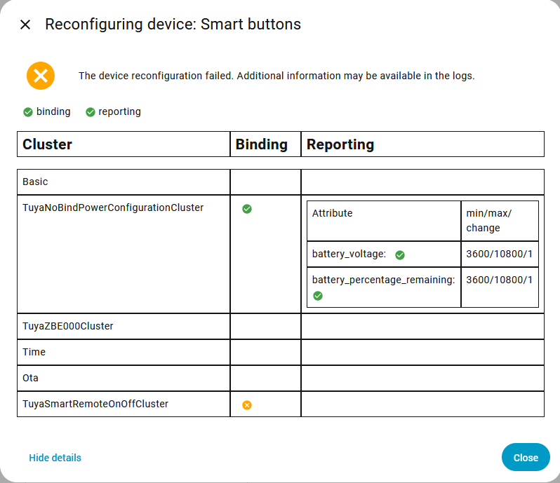

Also on this screenshot, smart buttons on the right show no connections but are now working again
but button2 which has been in the same place for about a year shows connection but does not work at all (had a “button1” as well that was replaced with bedroom buttons when it stopped)
same with “motion1” its working as it should but shows no connections
Location 1 you don’t have enough router/repeater/mesh nodes.
Location 2 you have the nodes but those end devices are not able to reach so there is something blocking/reducing the signal between them and the nearest repeater.
Those are your two issues I spot right away from the images you have provided.
In the case of the dining room smart plug extender, swap it with a different one

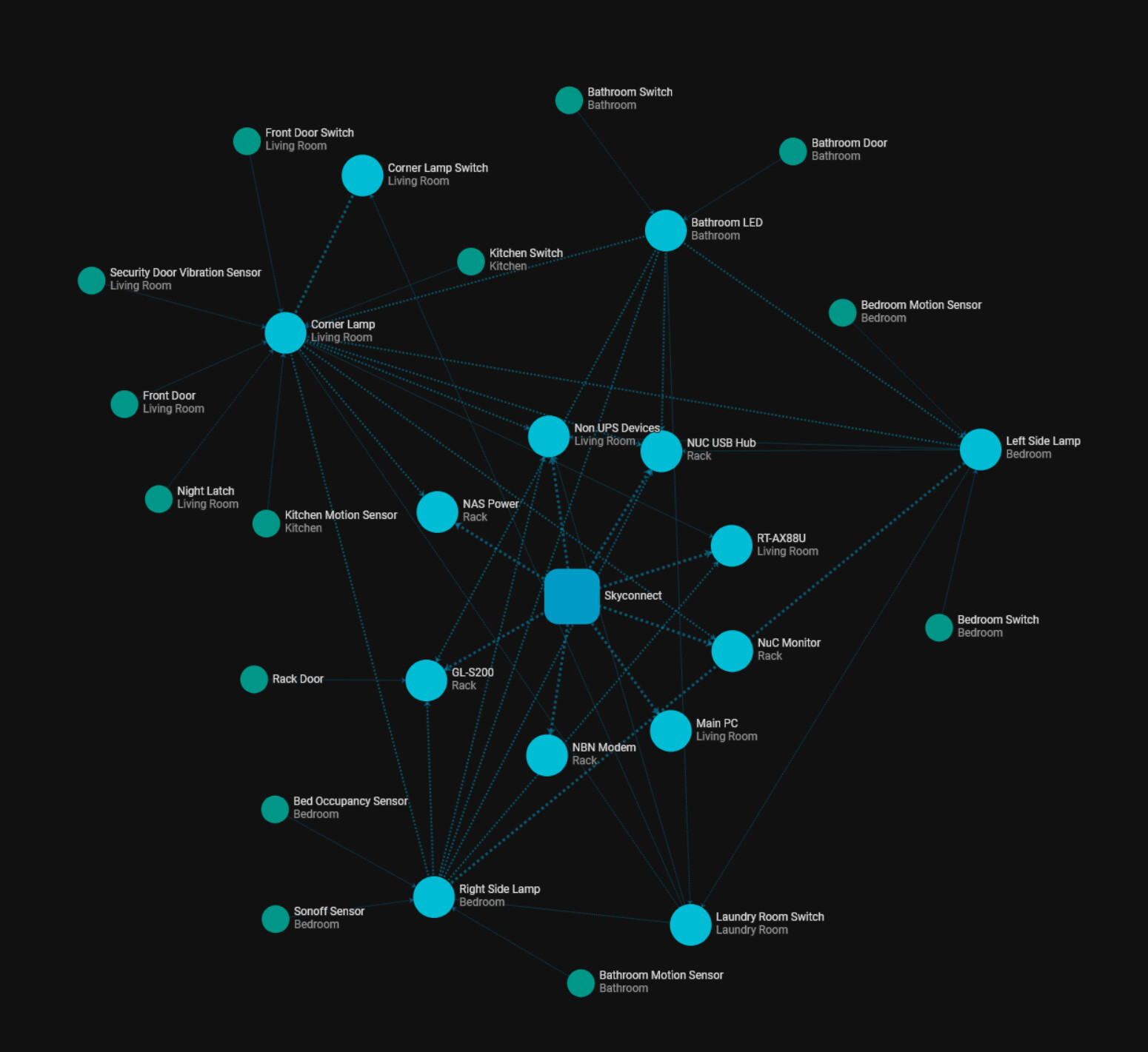

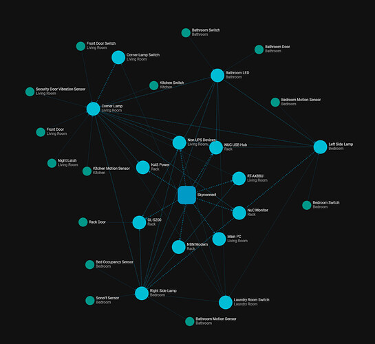

Also certain smart bulbs and led strips can act as repeaters, my hue bulbs and led strip do this.
Here is my setup and an example of what a proper mesh should look like:

Let’s pick one location as a start.
What’s the zigbee channel # you are using for your zigbee mesh network?
And what are the wifi channel #s you are using in the same space?
based on another post that suggested settings its set to 25
not sure on any of the wifi, my buddy that does IT has those all setup theres 6 of them scattered throughout the warehouse
Then you probably have seen the graph in this article, that if your zigbee channel is at 25, you will want to move your 2.4GHz wifi channels to only 1 and 6, for better chance to fight interference. Talk to your IT guy and they should know what to do.
Also, consider install the WiFi Analyzer app, or something similar, on your phone, to survey around your warehouse and see whether there are any noisy / strong hotspots or APs near you at 2.4GHz channel 11.
