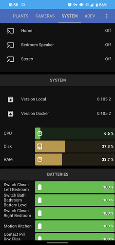

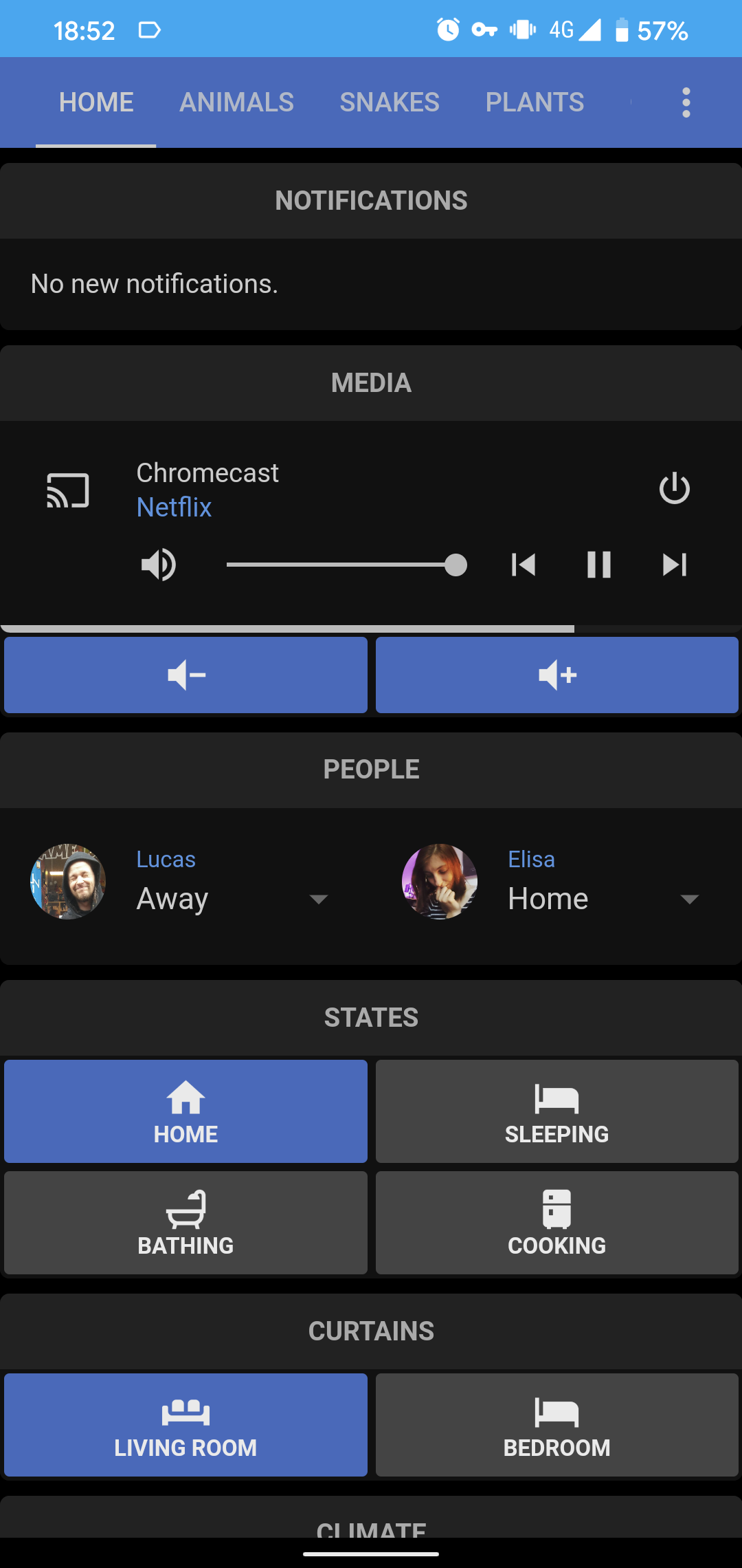

I use vertical-stack-in-card to add a header using button-card.
I use decluttering-card to make a template for my headers, so it’s a bit tricky to share the code. But it’s basically a button-card at the top and then whatever cards you want inside a vertical-stack-in-card.
