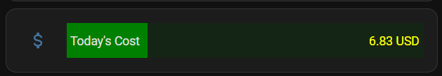

Here is what I’m using:
type: custom:config-template-card
entities:
  - sensor.energy_cost_4244_today_string
card:
  type: custom:bar-card
  max: 30
  severity:
    - color: Red
      from: 21
      to: 30
    - color: Orange
      from: 11
      to: 20
    - color: Green
      from: 0
      to: 10
  entities:
    - entity: sensor.energy_cost_4244_today
  card_mod:
    style: |
      bar-card-value {
        color: yellow;
Which renders as:
Try
          - type: custom:bar-card
            title: prefix
            entities:
              - entity: input_number.test_level_1
            card_mod:
              style: |
                bar-card-value:before {content: "$ "}
This worked like a charm!! Thank you so much :slight_smile:
