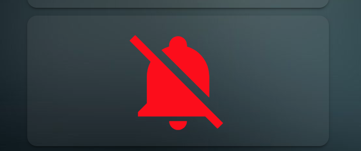

Question; I was trying to simplify a button setup for alarm state which was previously quite complicated. I would expect below to also show the text (show_name=true) but does not show it. Did I miss anything?
type: 'custom:button-card'
entity: alarm_control_panel.ha_alarm
icon: 'mdi:bell'
action: more_info
show_state: false
show_name: true
state:
- value: disarmed
color: 'rgb(255, 0, 0)'
icon: 'mdi:bell-off'
- value: pending
color: 'rgb(251, 210, 41)'
icon: 'mdi:security'
- value: armed_away
color: 'rgb(0, 255, 0)'
Hi @Tyfoon,
Edit: just released 0.3.0 which includes it.
Note that your config is not valid anymore for action, please check the new documentation (it’s now in the tap_action YAML object)
This feature is not yet part of the latest release (0.2.0) even though it has been merged into master. It’s going to arrive soon
In the meantime, if you want you can use the button-card.js from the master branch.
Cheers.
