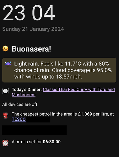

I have a dynamic sidebar on my home view, which is inspired by https://github.com/matt8707/hass-config/blob/f836da87f5d4dced111c4fbea709adbdcebc95fd/sidebar.yaml
The sidebar includes info such as cheapest petrol in the area, what meal is on the planner tonight, etc.
In my sensor template I’ve set up anchor tags eg <a href="/lovelace/recipe">Latest Recipe</a> in order to add contextual information.
The config is all in place, I’ve set up all the anchors - I just can’t get them to work on the front end. I’ve the card set to tap action: none, and I can’t have the tap action just do one thing because there are a number of these contextual links.
I can see that css is set to disable pointer events, but when I turn them back on I can see the ripple effect but the links dont actually do anything.
Has anyone had luck getting anchor tags to work in a custom button card?
