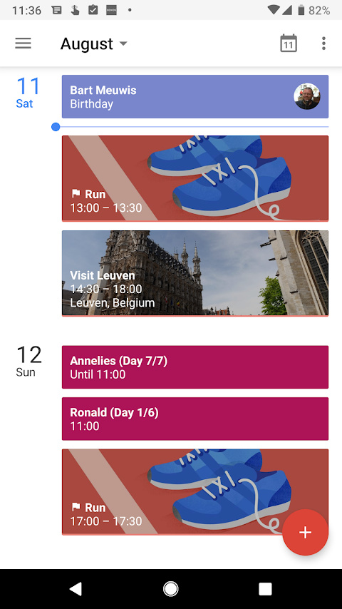

BTW. What is the purpose of slider on top of card? I can’t move it.
Ok, hint taken, I’ll make it optional: you are the second person who asks me :slight_smile:
It gives you the progress throughout the day, it is based on the standard google android calendar.
What do you think? Keep it, make it optional, …
Didn’t realized that is day progress bar. Currently I have only all day events in my household calendar. Need to play with other type of events.

The progressbar is now optional:
configure it using: showProgressBar: false on the same level as entities.
