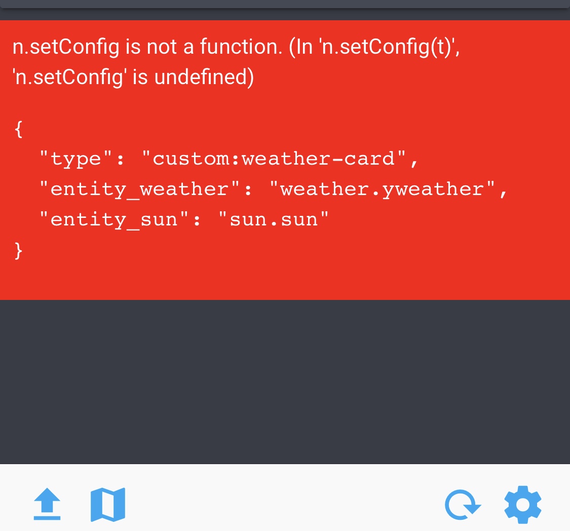

Hey arsaboo not sure how i can get the app. I have reinstalled the app but still seeing the code error in red. Might be a ios thing… I´m running version 1.1.1 on IOS
anyway, i stumbled on your github! really nice setup you have
Seems like this is not only related to the Google calender component, i get the same error when adding
This is my config:
resources:
- url: /local/dist/google-calendar-card.js?v=2
type: js - url: https://use.fontawesome.com/releases/v5.2.0/css/all.css
type: css - url: /local/custom_ui/weather-card.js
type: js
- type: “custom:weather-card”
entity_weather: weather.yweather
entity_sun: sun.sun
Where did you save the google-calendar-card.js file? I suspect the path is incorrect.

Issue solved
I had to add,
frontend:
javascript_version: latest
