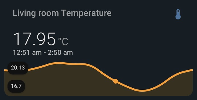

I’ve added a mini-graph-card and set the name to Living Room, when ever I click the graph for additional details it changes the name to living room temperature. Anyone know how to set the name when selected?
Post a screenshot with this changed name.
And show where you changed the name to “Living Room”.
type: custom:mini-graph-card
entities:
  - sensor.living_room_temperature
card_mod:
  style: |
    ha-card
     {background: transparent;
     border-style: none;
  1. You posted an unformatted code. It does not have indents which are crucial in yaml.
  2. Avoid posting picture containing unrelated things which only distracts. There are plenty of tools like MS Paint to get rid of unneeded info.
  3. In short:
    – if “name” is defined on a card level - it will be displayed when a graph is NOT selected;
    – if “name” is defined on an entity level - it will be displayed when a graph is selected.
I don’t seem to have the option to insert code on my phone, anyway I’ve update the code and the pictures; hope you are less distracted now and maybe able to help.
As it was explained here:
Test with this:
entities:
  - entity: sensor.living_room_temperature
Thanks for the suggestion, unfortunately that didn’t work.
“bad indentation of a sequence entry”
