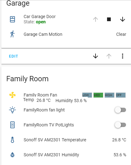

i’m trying to add a custom cards to one entity. Ex:
Ceiling Fan
using custom card for the speed control and i also want to add custom secondary info card as well to this entity. Under the fan control i want to display the temperature of the room using the custom secondary custom card?

If you use the button card you will lose the fan controls the way you have them now.
That’s why I built/modifieds my fan control row Lovelace component (as pictured in my post above). I tried the button card and just didn’t care for the way it looked.

Here is an example using the custom card for secondary info:
- type: entities
title: Living Room
show_header_toggle: false
state_color: true
entities:
- entity: sensor.livingroom_smoke_alarm_status
type: "custom:secondaryinfo-entity-row"
secondary_info: "Battery Level: [[ sensor.smoke_co_alarm_1_battery_level.state ]]%"

I don’t have that exact configuration any more since it was so long ago but this is functionally equivalent:
- type: entities
title: Computer Room
state_color: true
entities:
- type: custom:secondaryinfo-entity-row
entity: light.computer_room_ceiling_light
secondary_info: "Room Temperature: [[ sensor.computer_room_motion_temperature.state ]]"
- type: custom:fan-control-entity-row
entity: fan.computer_room
name: Computer Room Fan
customTheme: true
reverseButtons: true
