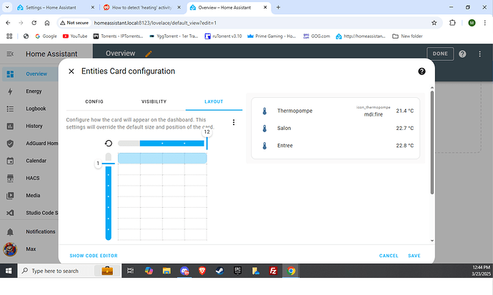

Hello everyone.
First time poster, long time reader.
I have a template sensor, that changes icon on state from climate entity.
this is working fine.
I’m trying to get that icon to be displayed in a multiple entity row.
This is where it gets tricky, I can’t figure out how to retrieve the data from the sensor. Well, I can get the data, but instead of displaying the actual icon, it displays : “mdi:fire”
Any help appreciated :slight_smile:
Thanks !
type: entities
entities:
  - entity: sensor.thermopompe_current_temperature
    type: custom:multiple-entity-row
    entities:
      - entity: binary_sensor.icon_thermopompe
        attribute: icon
  - entity: sensor.thermo_salon_current_temperature
    entities:
      - icon: |
          {% if is_state("binary_sensor.icon_salon", "on") %}
            mdi:fire
          {% else %}
            mdi:void
          {% endif %}
I’m just trying to get the Icon to be displayed, and not the the string.
Getting string on Thermopompe
Getting nothing from Salon, i just copied the template hoping it would work
Thank you all !

If hvac_mode of my heathing device is set to “heat”
then I want an icon (mdi:fire) to be shown on the line, before the temperature.
this will let me know that the said device is working.

Thank you very much for your time !
This is SOLVED !
type: entities
entities:
  - type: custom:multiple-entity-row
    card_mod:
      style: |
        div.entity:nth-child(1) state-badge {
          {% if is_state("binary_sensor.icon_thermopompe", "on") -%}
          --card-mod-icon: mdi:fire;
          {%- else -%}
          --card-mod-icon: mdi:void;
          {%- endif %}
    entities:
        icon: true

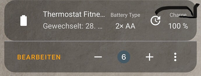

Hello, would like to set the button to the right of the charge value, can anyone help me? Best regards
type: entities
entities:
  - entity: sensor.heizkorper_batterie
    icon: mdi:battery
    name: Thermostat Fitnessraum
    secondary_info:
      entity: sensor.heizkorper_battery_last_replaced
      format: date
    style: |
      .entity:not(.state)>div {
        color: var(--secondary-text-color);
    state_header: Charge
    entities:
      - entity: sensor.heizkorper_battery_type
        styles:
          width: 80px
          font-weight: bold
          text-align: right
      - entity: button.heizkorper_battery_replaced
        type: button
        icon: mdi:update
        styles:
          width: 20px
          font-weight: bold
          text-align: right
        tap_action:
          action: call-service
          service: button.press
          service_data:
            entity_id: button.heizkorper_battery_replaced
          confirmation:
            text: Bist du dir sicher?
Set the main entity to hidden (see docs of the mukti entity card) and add it again as additional entity at the place, where you want to see it.
Thanks a lot, i will try!

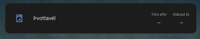

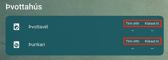

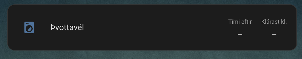

Can someone help me style the header lines? I want them a little bigger. I’m unable to target them with CSS and haven’t seen any examples here or in the card mod thread for multiple entity row.
I can change the color with
styles:
    --secondary-text-color: white
but not the size or weight.
You can only do it with cardmod. Go to the main cardmod thread - 1st post - fantastic link at the bottom - multiple-entity-row.
Yeah I’ve been through every example there but haven’t found a single one that touches this particular element.
This was incorrect, there are indeed samples there of styling this text, they just don’t work for me, don’t understand why. I use card_mod heavily, but when it comes to this card it’s like I’m just unable to target things at all.
Here’s something I copied from the card_mod thread, it does nothing on my end…
type: entities
entities:
    entity: sensor.washing_machine_time_remaining
    icon: mdi:washing-machine
    show_state: false
    entities:
      - entity: sensor.washing_machine_time_remaining
        style: |
          .state.entity {
            color: magenta;
          .state.entity span {
            color: cyan;
      - entity: sensor.washing_machine_finish_time
Answered here: 🔹 Card-mod - Add css styles to any lovelace card - #8940 by Ildar_Gabdullin
