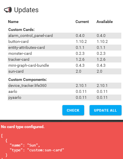

Same issue here as @mclaudiopt . Used custom updater.

Same here. Have tried both with custom_updater and with local and get No card type found.
My entity shows as sensor.time_utc not time_date.time_utc and my time and date are set up under sensors not as a component, possibly that is why it does not work?
It could be a problem with the release. I’ve made another one and I hope it will eliminate the problem with “No card type configured”
