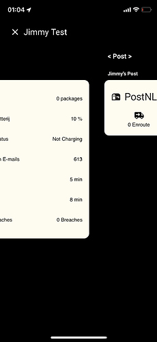

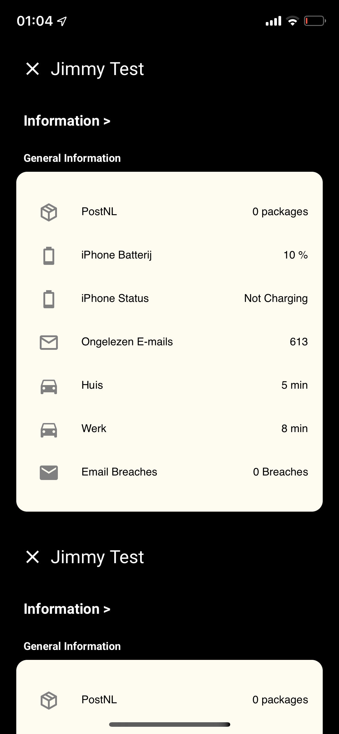

@Bram_Kragten and @thomasloven I use your swiper card and I try to use it in a popup card. Now the cards will display fine, but it takes from 2 to 5 seconds to be able to swipe on an iphone x (it is scrollable but it will hang halfway the animation). Once it is loaded after those 2/5 seconds it will work perfectly fine, until you close the popup and open it again.
The swiper card does not do this on a regular view. I have tried it with different configs and I even switched to browser-mod to see if that would be any better (and actually it has a little bit but only when the card is bugging like the screenshot)
As you can see in the screenshot it is bugging (it shows the card twice!) but funny thing is, when the card does this it will work immediately, most of the time.
If it shows it the way it should be, the screen will hang halfway for a few seconds like this:
This problem only occurs with the swiper card on a popup card (be it via popup-card or browser-mod, they both have similar results). It works perfectly fine with any other card. Any ideas?

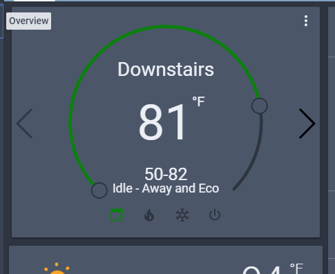

I am trying use swiper card with slider cards. Is it possible to disable draggable and use only navigation?
Thank you for answer.
@Nesty, here is the code I use for my thermostat cards. I tap the arrows to change between the up and dowstairs tstats. Look at the parameters specifically.
          - type: custom:swipe-card
            parameters:
              centerInsufficientSlides: true
              navigation:
              slidesPerView: 'auto'
              spaceBetween: 0
              nested: true
              allowTouchMove: false
            cards:
              - entity: climate.downstairs
                type: thermostat
                style: |
                  ha-card {
                    margin: 0px 4px 4px 4px;
              - entity: climate.upstairs
                style: |
                  ha-card {
                type: thermostat
How it looks:
Thank you! allowTouchMove: false is the magic :smiley:

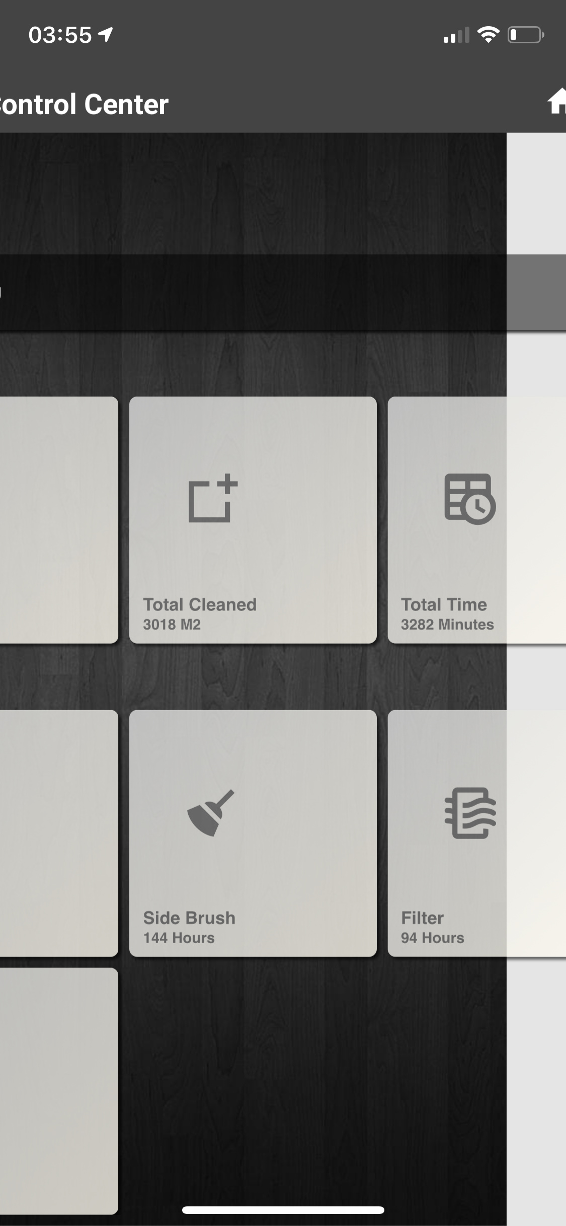

@Bram_Kragten I know it is still a beta, but I would like to mention that the swiper-card doesn’t work with HA 0.101.x as of yet. See screenshots below what I mean. I have tried to remove everything but the swiper-card and it seems the swiper-card is causing this problem (when commenting the swiper card it works perfectly fine). It also works fine with older versions (and the current stable version).
Like I said it is still in beta, though I still felt I should mention it as it might be something breaking.
This is what it should actually look like:
