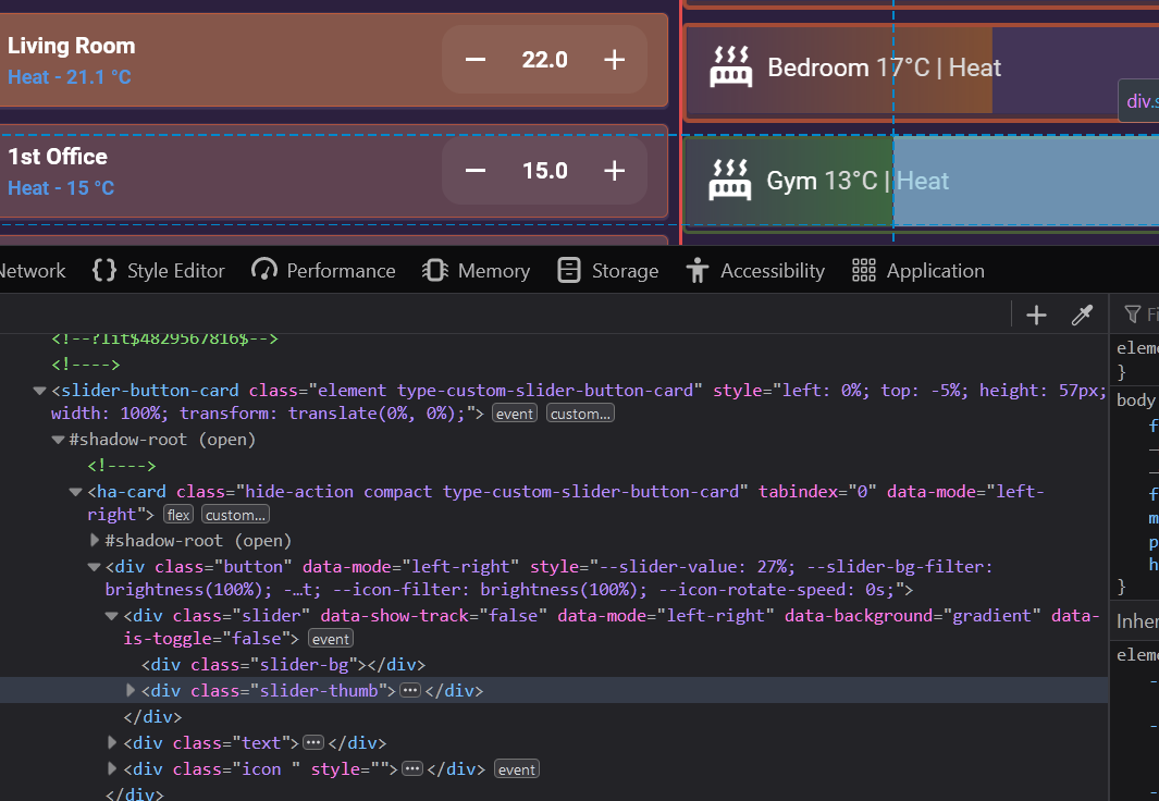

i have slider cards that id like to include but obviously its a conflict as i cant slide the slider cards on the swiper card as it swipes… the… card ![]()
is it possible to not swipe the card if im on a slider card ?
ive tried adding the noSwipingClass for slider, slider-bg-slider-thumb but nothing stops it
