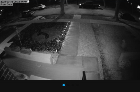

Here’s my bug… it’s been happening since I tried this card. The Scrollbar or balls will always go outside the card. Sometimes after 10 minutes, sometimes after 20.
this is how i want it… and then it will move to this and mess up all alignment. not to mention i can’t change the color of the balls.
type: custom:swipe-card
parameters:
  slidesPerView: 1
  spaceBetween: 0
  start_card: 1
  grabCursor: true
  followFinger: true
  pagination:
    type: bullets
    hide: false
    draggable: true
    snapOnRelease: true
  - type: picture-entity
    show_state: false
    show_name: false
    camera_view: live
    entity: camera.front_door_medium
    show_state: false
    show_name: false
    camera_view: live
    entity: camera.back_alley_east_medium
    show_state: false
    show_name: false
    camera_view: live
    entity: camera.back_alley_west_medium
    theme: Mushroom Square
    show_state: false
    show_name: false
    camera_view: live
    entity: camera.side_enterance_medium
swipe
