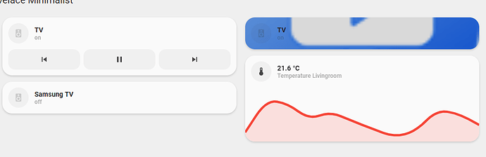

When you press the Play button from the control keys, the television turns on. But it doesn’t do anything else.
I wanted to use this but that didn’t work either.
https://ui-lovelace-minimalist.github.io/UI/usage/popups/popup_media_player/

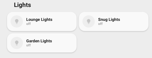

Also, how do you group your cards together with titles?
I’ve been adding a ‘blank’ card to get empty spaces.
- type: "custom:button-card"
color_type: blank-card
