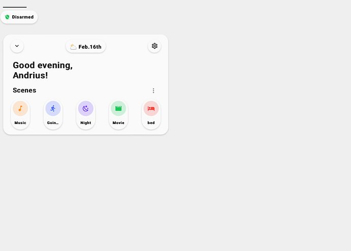

@andriuskr Than this UI card
    - type: horizontal-stack
        - type: custom:button-card
          template:
            - card_welcome_scenes
          variables:
            ulm_weather: "weather.openweathermap"
            ulm_time: "sensor.time"
            icon_pill_1: "hue:bulb-group-sultan-lightstrip-off"
            icon_pill_2: "hue:room-lounge"
            icon_pill_3: "phu:ls-sultan-iris-group-v2"
            icon_pill_4: "hue:room-dining"
            icon_pill_5: "fapro:party-horn"
            name_pill_1: "Uit"
            name_pill_2: "Avond"
            name_pill_3: "Avond1"
            name_pill_4: "Eten"
            name_pill_5: "Test"
            entity_pill_1: scene.alles_uit
            entity_pill_2: scene.avond
            entity_pill_3: scene.avond_1
            entity_pill_4: scene.eten
            entity_pill_5: scene.test
            color_pill_1: yellow
            color_pill_2: blue
            color_pill_3: purple
            color_pill_4: green
            color_pill_5: red
@andriuskr this wilbe the outcome

Cannot figure out, why new welcome message shows bad welcoming message. It shows Good evening in the morning
Thanks a lot
