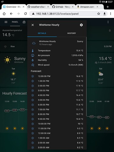

Hi there,
As you can see in the screenshot weather-card-chart is using the icon âclear-dayâ all the time, no matter what time of the day. Shouldnât that be âclear-nightâ for the night time?
Anything Iâve done wrong?
(Yes, itâs sunny all the time here, I live in Florida
Thanks,
Truwolf
Answering to my own post in case somebody has the same problem âŚ
I installed the NWS integration and I am now using the kfin_hourly entity and I now see the moon when itâs a clear night
Still need to figure out the icons for âcloudy nightâ but itâs definitely progress.
