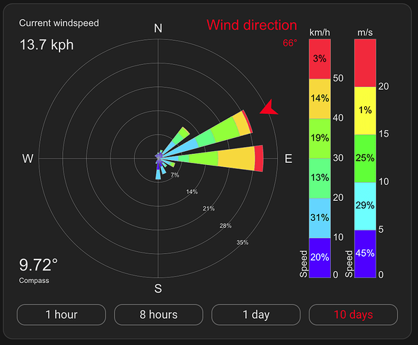

Great work! Mine looks like this:

Released version 1.16.0
Finally, the long time ago requested feature, time range buttons.
Active button color and background color can be configured.
Other styling can be changed with cardmod, the button have uniek ids.
data_period:
  log_measurement_counts: true
  period_selector:
    location: bottom
    buttons:
      - hours: 1
        title: 1 hour
      - hours: 8
        title: 8 hours
      - hours: 24
        title: 1 day
        active: true
      - hours: 240
        title: 10 days
