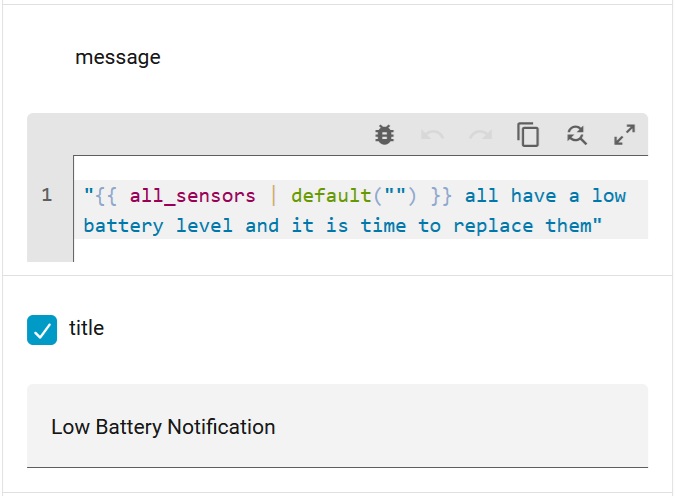

  message: >-
    "{{ all_sensors | default("") }} all have a low battery level and it is time
    to replace them"

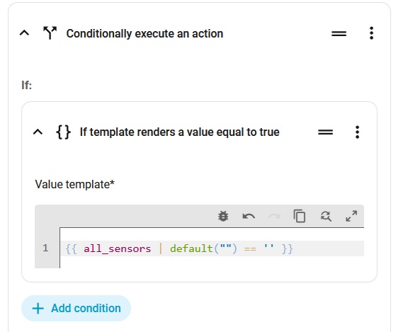

6 - This is an “if / then + else” action
This example is if you would like to receive a okay confirmation message if there are no batteries to report and if there are batteries to report it will list them.
You just replace the sensor name to the one you would like to use.

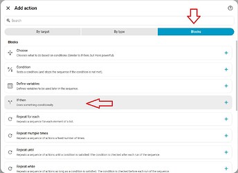

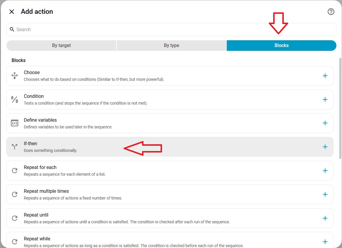

First we select a ‘If-then’ action. Click ‘+ ADD ACTION’, then click on blocks and select If-then action.
Then add the condition by adding in a template condition to check if there are any sensors to notify. Click ‘+ ADD CONDITION’, then type ‘template’ and select it. Then add the code below.
Note: See example 5 above for condition explanation.
{{ all_sensors | default("") == '' }}

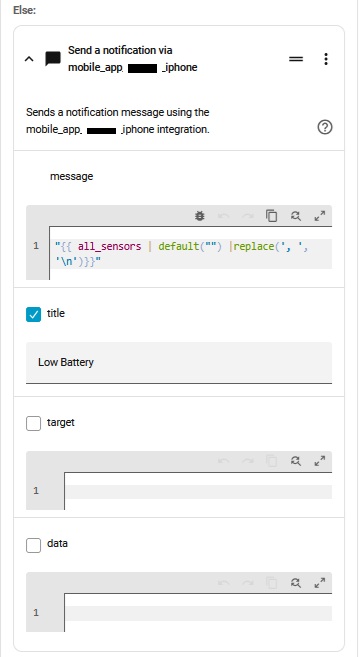

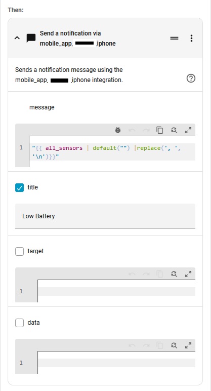

If the condition was true (no sensors to report) then we send this okay confirmation message. In ‘Then’, Click on ‘+ ADD ACTION’, then type ‘notification’ and select the notification you would like.
If the condition was false (sensors to report) then we send this message with all the sensors that have low battery level. Click on ‘Add else’ then ‘+ ADD ACTION’, then type ‘notification’ and select the notification you would like.

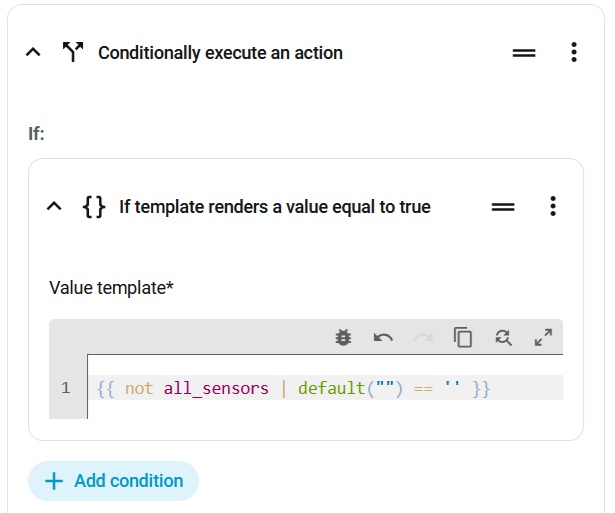

7 - This is an “if / then” action
This example is if you would like to receive a message only when there are low battery sensors to report.

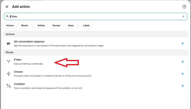

First we select a ‘If-then’ action. Click ‘+ ADD ACTION’, then start typing ‘If-then’ and the action will pop up… select it.
{{ not all_sensors | default("") == '' }}
If the condition was true (sensors to report) then we send this message with all the sensors. In ‘Then’, Click on ‘+ ADD ACTION’, then type ‘notification’ and select the notification you would like.
NOTE: If there was no sensor to report then we wouldn’t get a message.
