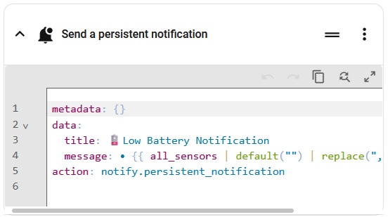

  1. In the custom actions, click on the ‘+ ADD ACTION’ button
  2. Then start typing ‘notifications’. You will see the notifications options pop up. Select ‘Send a persistent notification’
  3. Then click on the 3 dots and select ‘Edit in YAML’.
  4. Copy the code below and paste it in as shown below. Replace the ‘all_sensors’ with the sensor you would like to use. You can also change how you would receive this message by using a ‘If-then-else’ or a ‘If-then’ action. In another FAQ I show you how to do this, Click Here. In the FAQ link example 6 = Shows you how to receive a ‘Okay confirmation message’ and example 7 = Shows you how to receive a message if there are batteries to report. The below example will just report every time it runs.
metadata: {}
  title: 🪫Low Battery Notification
  message: • {{ all_sensors | default("") | replace(", ", "\n• ") }}
action: notify.persistent_notification
  1. Click save and your done :tada:. Next time the automation runs you should receive a notification in the UI.
