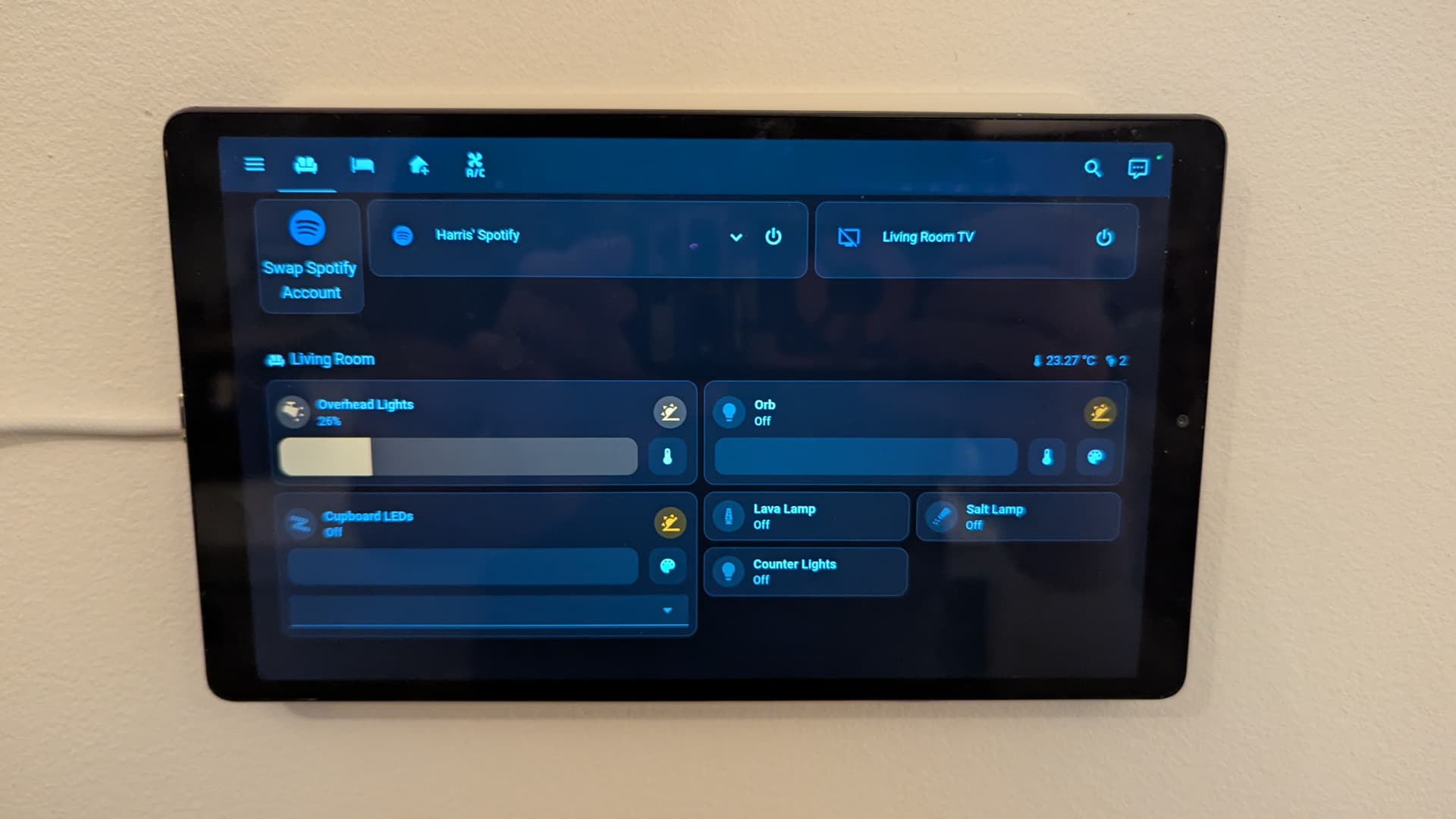

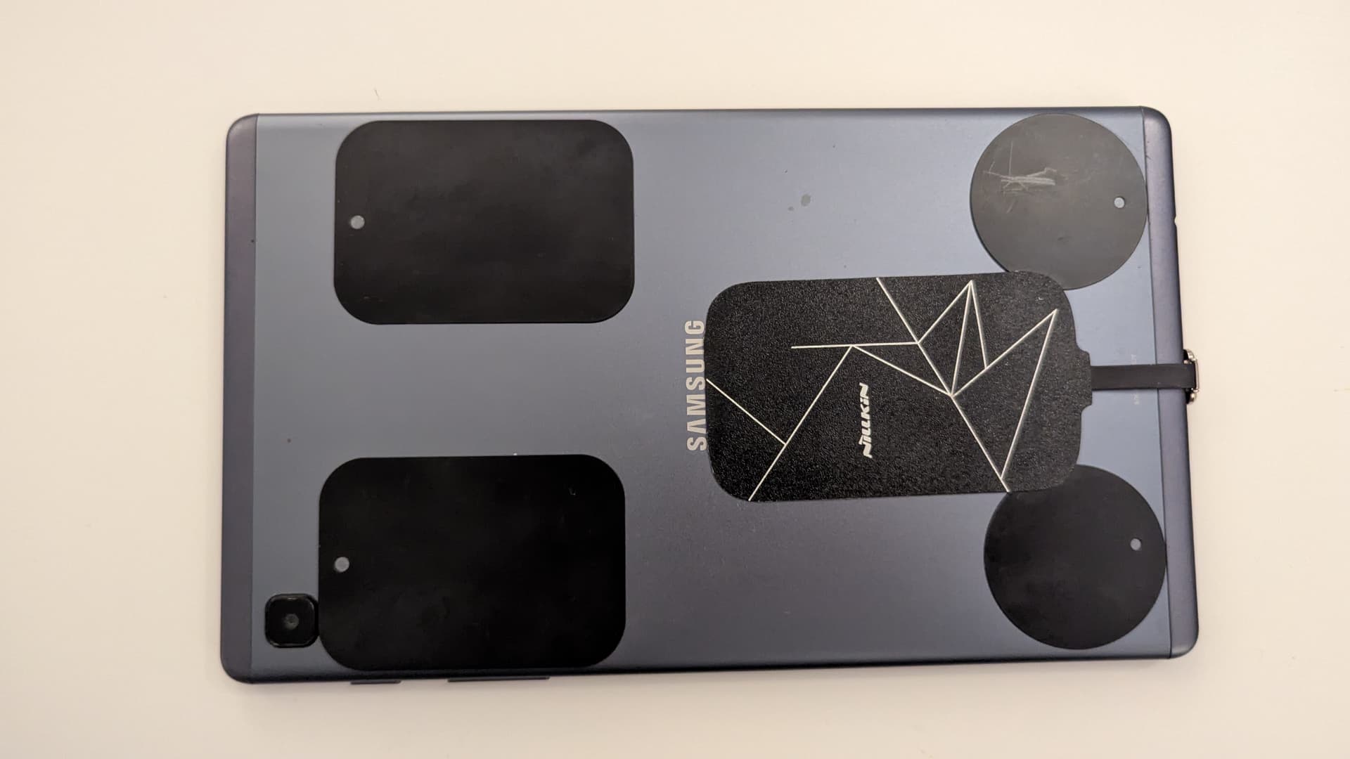

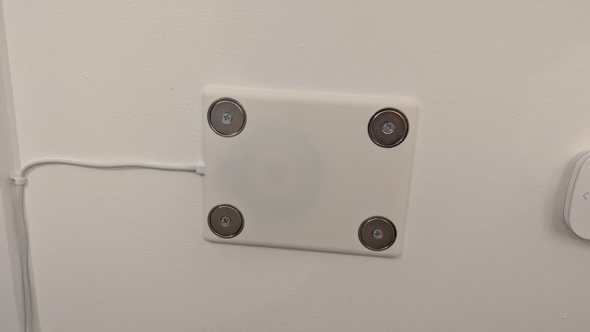

Hello! Inspired by an old post I saw here, I re-purposed an old Samsung Tab A7 Lite as a wall-mounted HomeAssistant dashboard!
For the STL to print the mount for yourself, and more details on the components, check out my post on Printables!
