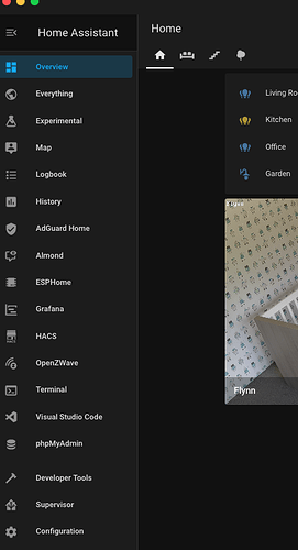

I would love to be able to manage the sidebar. E.g., re-order it, hide/remove/add items from it. (e.g., I don’t use history or map).
Those additional items annoy me personally.
Ultimately, configure items to show for each person (or define separate menus on a person level even).
