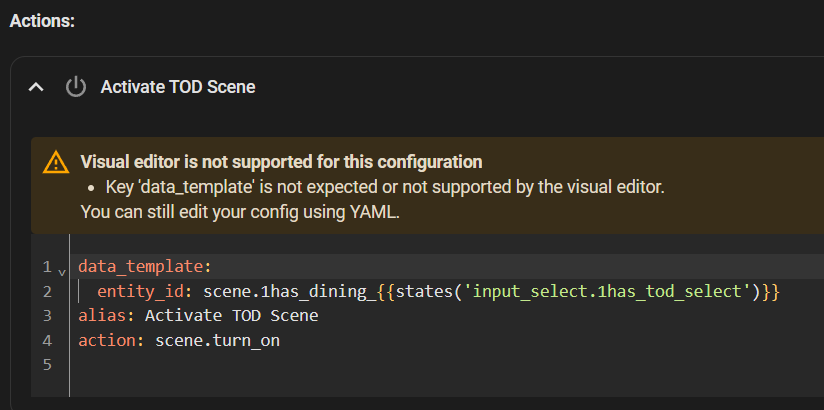

I activate the appropriate scene based on a time-of-day variable:
