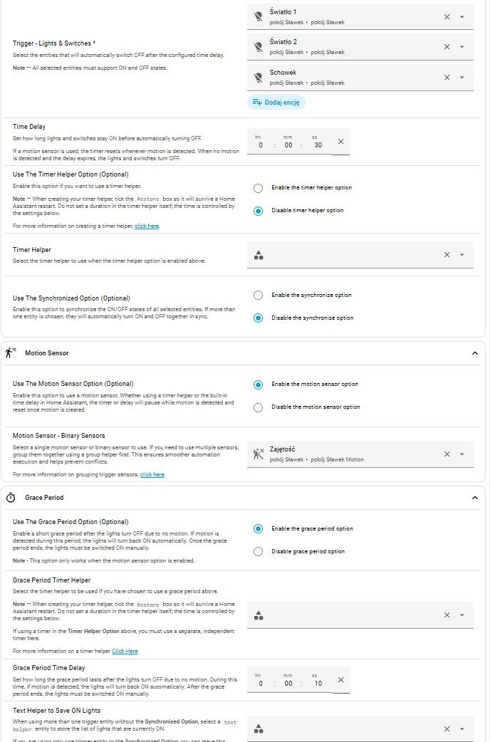

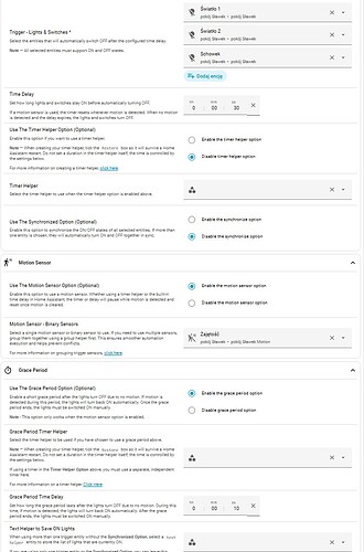

Hello, great automation.
However, I have a problem with the Grace Period.
If I have Trigger - Lights 1 light entity for 30 seconds + Motion Sensor + Grace Period for 10 seconds, the Grace Period works.
If I have Trigger - Lights 3 light entities for 30 seconds + Motion Sensor + Grace Period for 10 seconds, the Grace Period doesn’t work.
Trace timeline:
Triggered by the state of binary_sensor.pokoj_slawek_motion_occupancy at December 7, 2025 at 10:52:19 PM
Test If any of 13 conditions matches
Test If any of 9 conditions matches
Choose: No action executed
Choose: Motion detected
Stopped because an error was encountered at December 7, 2025 at 10:52:19 PM (runtime: 0.01 seconds)
Error rendering service target template: TypeError: unhashable type: ‘list’
@gordziej
You need to add the following inputs that are missing in Grace Period.
  1. Grace Period Timer Helper
  2. Text Helper to Save ON Lights
You can only use the 2 helpers in these inputs and can’t be used anywhere else.
TIP: If you click on the input and scroll down to the bottom you will see a ADD option.
Blacky :grinning:
Awesome! Thanks.

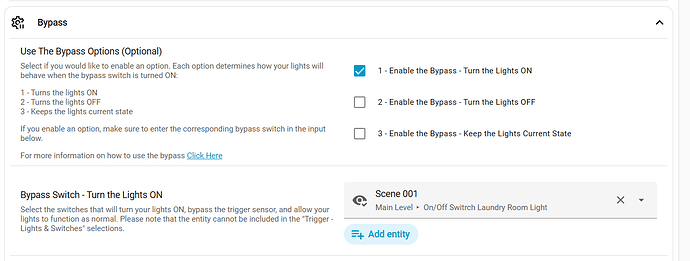

Hello Blacky, I am not able to get any Zwave Scene to work as the bypass entity. I would like to use Scene 001 Keypressed2x as the entity .
@boudrd
Scenes do not have an ON / OFF state and the bypass needs that to work. What you can do is create a toggle helper and add that toggle helper to the scene so the scene will turn the helper ON and OFF. You then use that toggle helper in the bypass.
