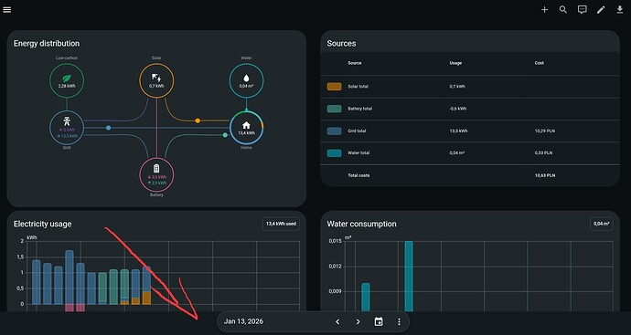

First of all, thank you so much for your hard work and brilliant theme. :grin::+1: In HA version 2026.1, there’s a problem with the new date picker overlapping with the navigation bar, which is at the bottom by default in this theme. Is there any way to fix this? :thinking:
Already reported during 2026.1 beta and fixed before it was released, update to the latest version and clear your app/browser cache.
Thank you very much, everything is indeed fixed. :grin:

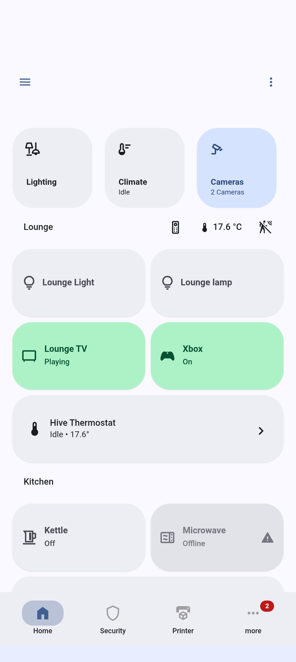

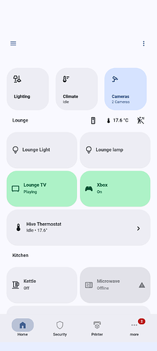

I’m hoping I am missing something here…
I cannot seem to get the background of my dashboard to switch colours.
I have the material you utilities companion installed.
But the background of my dash, is always a white colour?
Yet the status bar and bottom nav bar change colour to match the currently selected scheme from Android settings, the screenshot shows the top status bar, in the yellow like hue, but the dash background in the white
You mentioned changing the scheme in Android settings, but what about the companion module config panel settings? The module doesn’t auto-detect Android color scheme settings but that can partially be set up by the user.

Sorry, you’ve lost me a little there.
I have the companion installed. I use a simple automation to update the helper, when the OS accent colour changes, using the sensor from the HA companion app.
I double checked, and my dashboard views were not set to any theme for some reason.
Switching them to this theme changes the colours.
Still can quite get the Google Home look, but its close
Leave the individual dashboard themes set to default/none so they inherit the user theme. If you set them at the view level it overwrites the colors set by the module.

I think I may be losing the plot here…
My user theme is set to Material You.
If I set the individual dash theme to no theme, it looks like this:
If I set the dash theme to Material You, it looks like this:
The colours only ‘react’ to an OS change (via automation) when the individual dash theme is set to Material You.

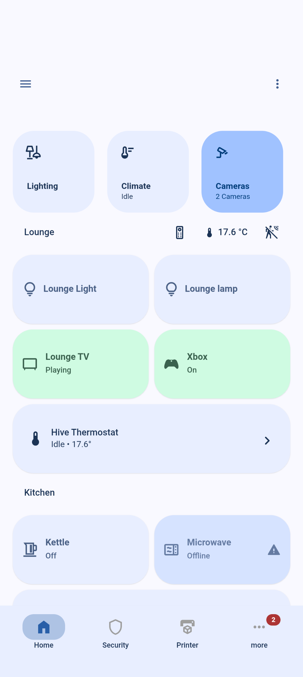

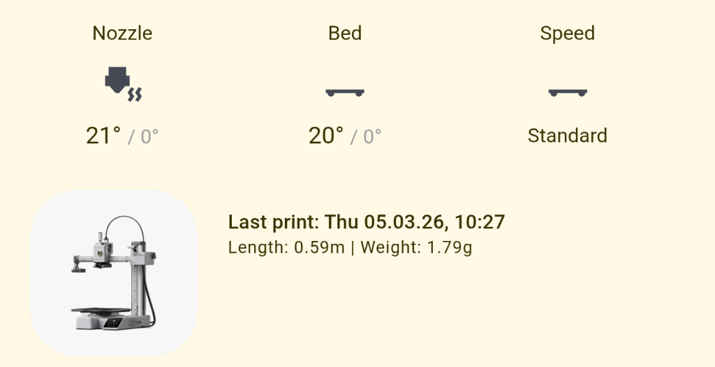

I feel like something weird is happening / is broken here if I’m honest
If I edit a card, it looks like this, note the BG colour:
But when I go back to the view, the BG colour changes:
That’s odd. Does this also happen in desktop browsers? Are you using the translucent card variant? Can you use browser developer tools to inspect the ha-card component and see where what it’s deriving its background from?
Think i may be getting somewhere…
I am using the Material You components from @ giovannilamarmora
It seems that these are using a different variable to the theme?
I created a quick test:
the top 2 light buttons, are both using Material You components
The one titled, no card_mod is ‘raw’
The one titles With card_mod’ is styled with
    card_mod:
      style: |
        ha-card {
          background-color: var(--card-background-color) !important;
The vacuum custom-button-card card has no bg colour defined in the config, so is assuming the theme variable, from the user set theme - the dash view has no theme set.
So the only workaround i can see is to add the card_)mod styling to each Material You card…
I think :thinking:
This feels (and looks) like RGB vs sRGB color space issue somewhere. See my comment on a button-card issue where I posted some information and links that may be relevant.

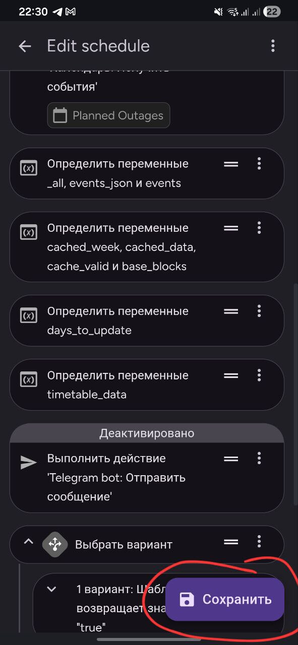

Currently, the “Save” FAB is always displayed in the automation, scene, or script UI editing. Is it possible to hide the “Save” FAB if there are no unsaved changes? This is the same as in the standard HA theme and as it was in previous versions of this theme. Thank you very much.
Yeah Material Home Components are based directly on Google Home’s components and do not use this theme’s card background colors. That being said card colors shouldn’t be different between the editor and in a view unless the card background is translucent.
That’s a bug, fixed in the latest patch released a second ago.
To my knowledge I have nothing that is translucent.
I am going to try and move away from the Material Home Components. Although they look pretty good, they seem to cause too many problems and disparities with other cards when it comes to themes.
I am having some success in re-creating them with custom-button-card, just a bit of a slog, as my styling / CSS skill aren’t great
