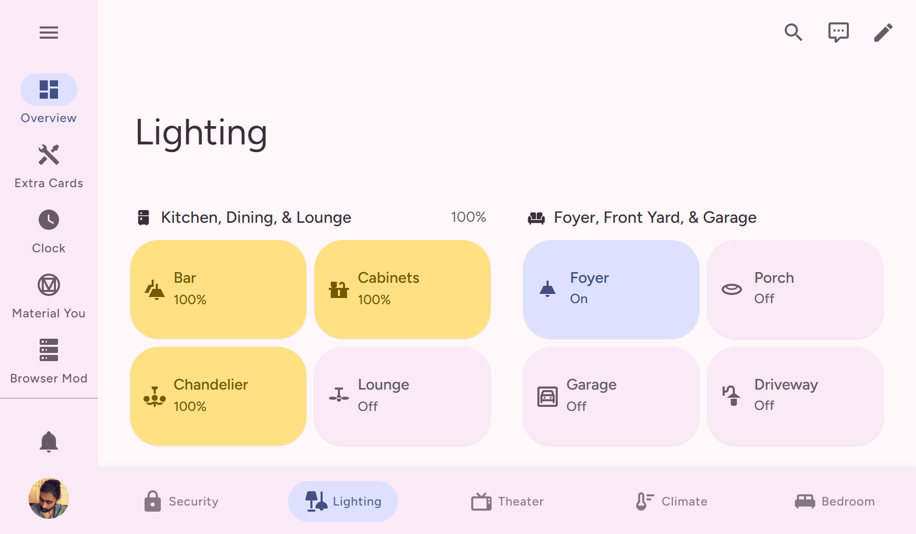

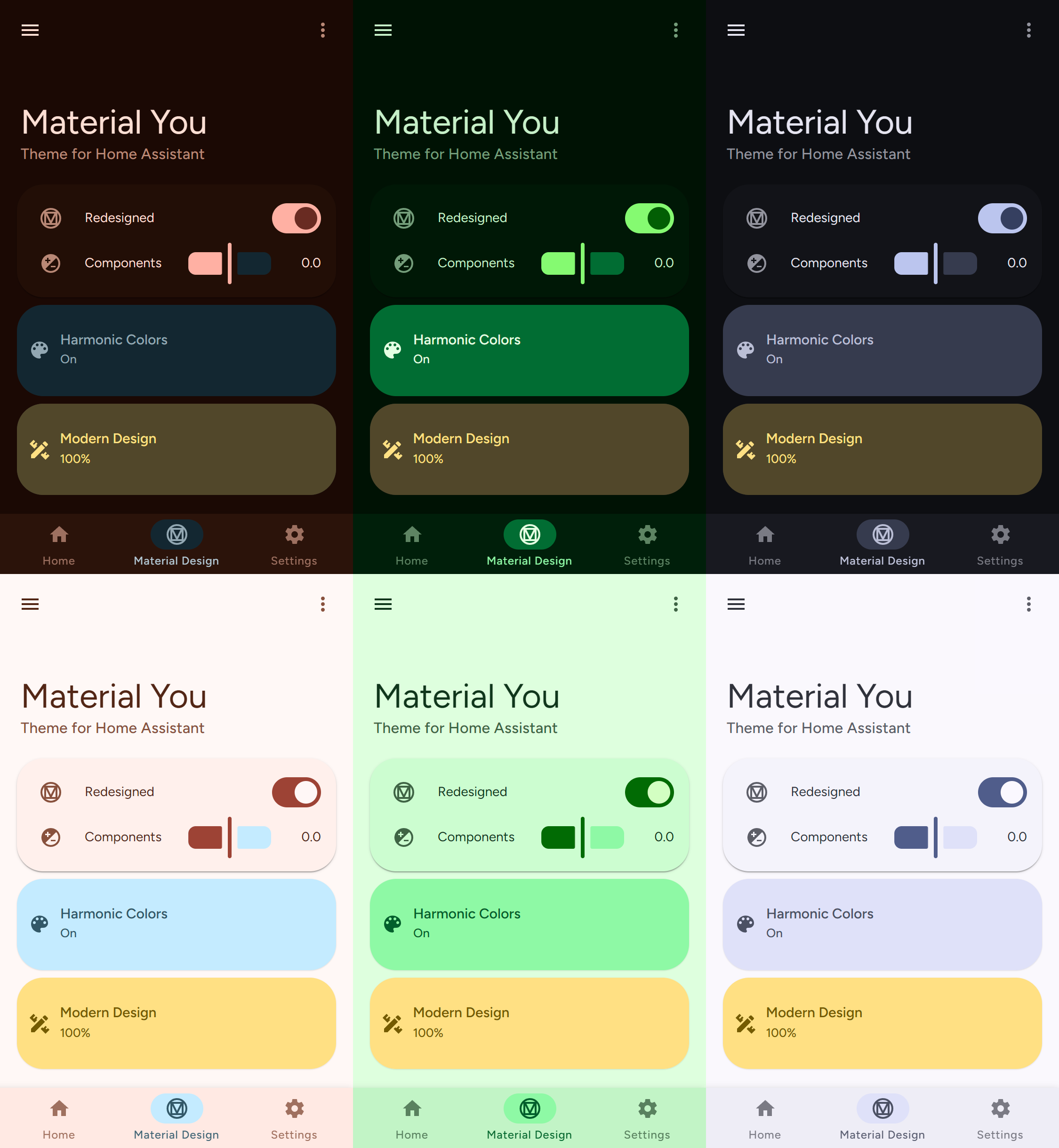

Material You Theme and Utilities- A Fully Featured Implementation of Material Design 3 Expressive for Home Assistant
I'm a huge fan of Google's Material You/Expressive design principles and how it looks on Android, so I recreated them within Home Assistant.
This theme is on HACS! Search for it under frontend repositories.
To get the most out of this theme you have to install its companion module, also on HACS.
The companion module allows you to:
  • Create custom color themes with a variety of options and schemes using both the 2021 original and 2025 expressive color specifications.
  • Inject custom styles into Home Assistant's components to follow the Material Design 3 specifications, making Home Assistant 100% Material Design 3 specification compliant.
    • Or disable this and just use the custom color theming.
  • Change the default card type to one of four varieties.
  • And more!
Material You, Now With Expressive Specifications
While creating this theme I did find that the CSS for some of the tile cards (notably fan and alarm control panel) are a bit weird and not custom theme friendly. While most tile features add transparency affects to disabled-color, some tiles share their “off” background color with the icon which makes hard to separately theme the two without using card-mod at the card level. It would be nice if all tile features used the transparent disabled-color method for their backgrounds so they could be better themed.
