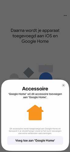

i cannot connect with google home
any idea what else i can try?
