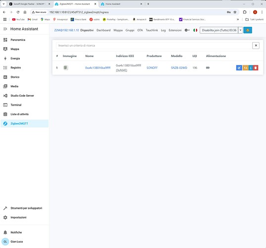

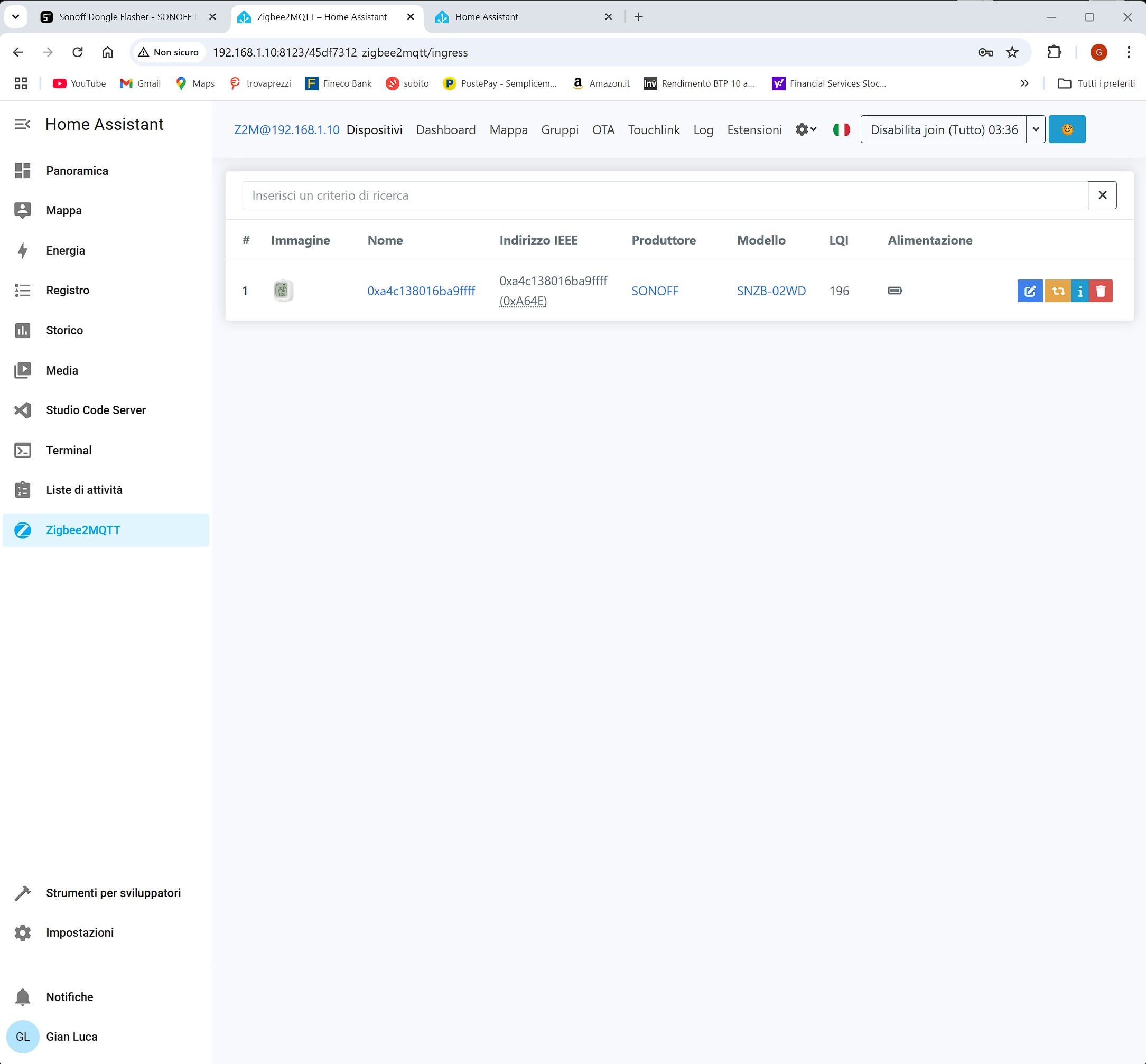

  1. I installed and start ZigBeeToMQTT and tried to pair a ZigBee 3.0 device. The device was recognized and everything worked fine and smothly.

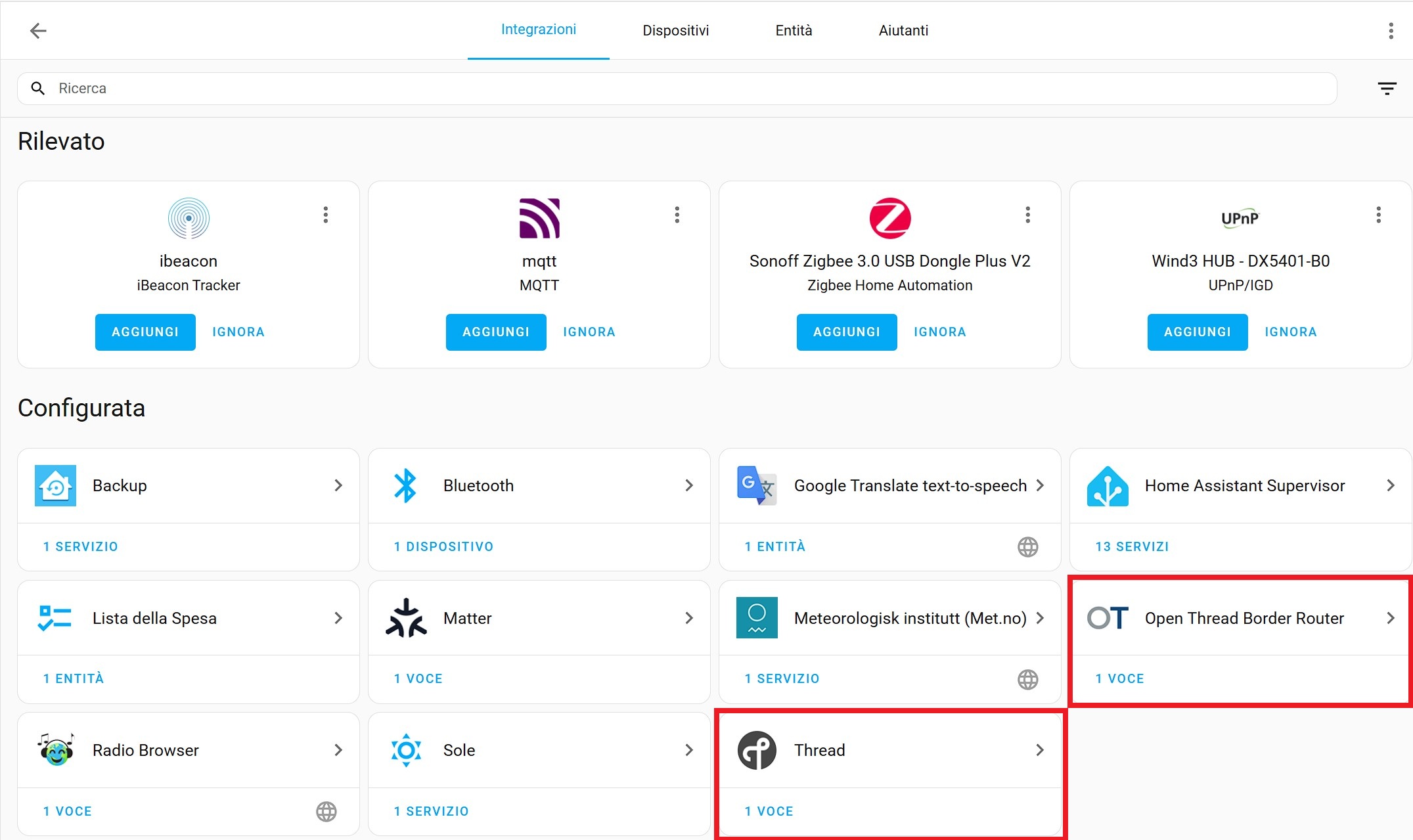

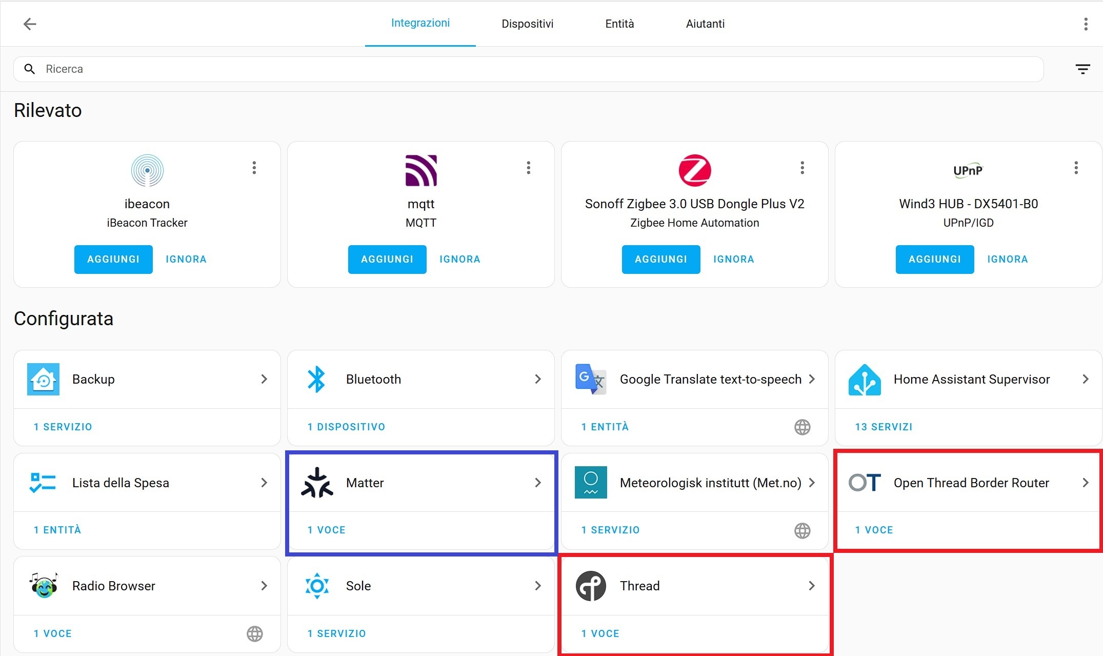

  1. After i have installed the Silicon Labs Multiprotocol Add-on, Home Assistant automatically recognizes both “Thread” and “Open Thread Border Router” under Settings → Devices and Services → integrations, and configures them automatically. I don’t have to do anything.
  1. i installed the Matter Integration under: Settings → Devices and Services → integrations → Add Integration

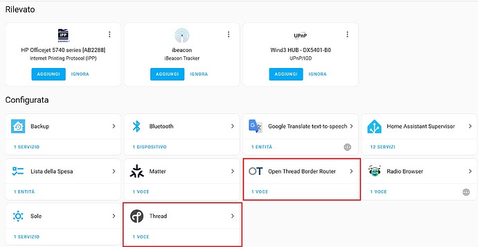

Issue A:

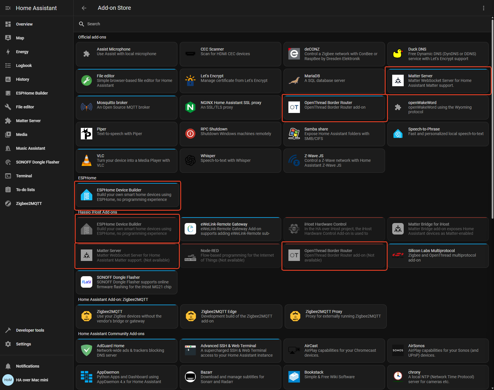

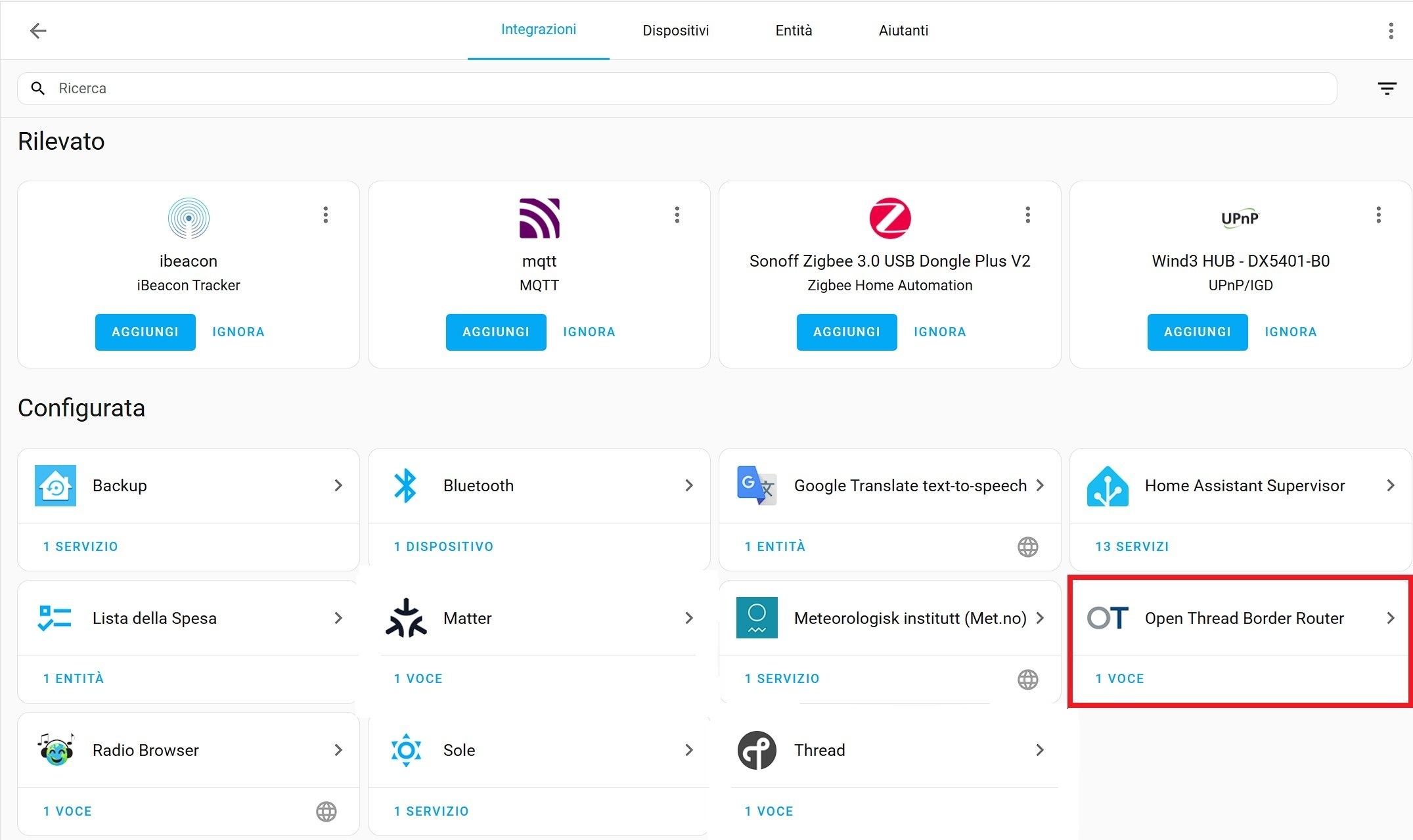

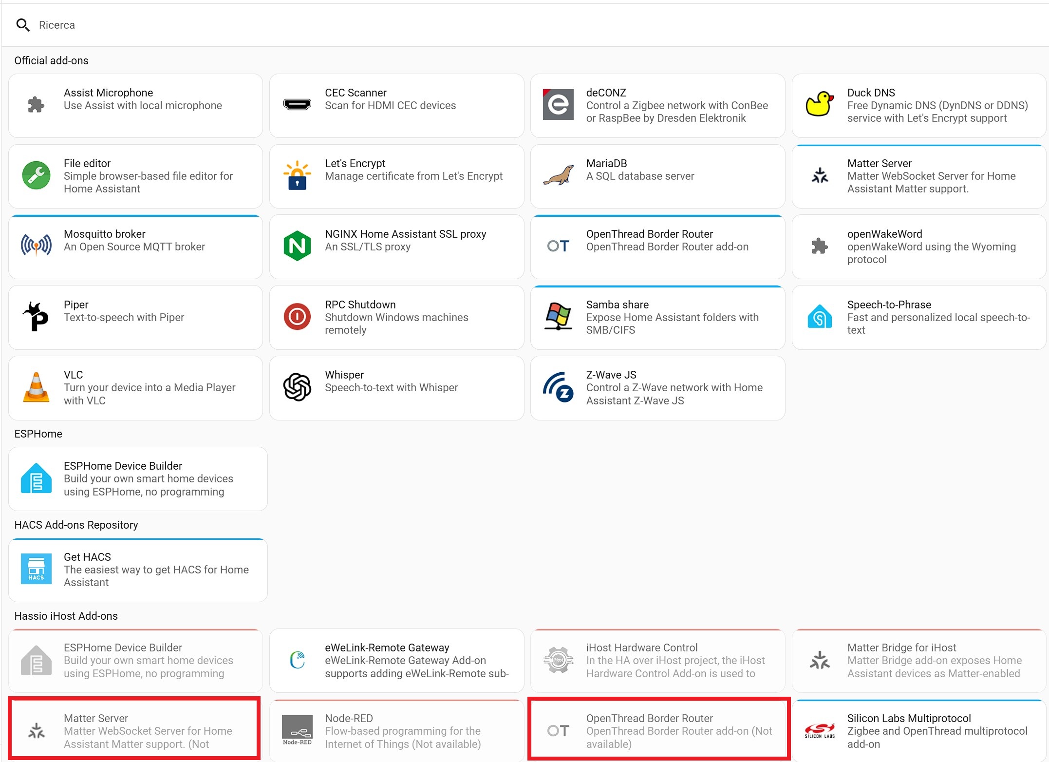

In Setting → addons → Add Addon → There are in Light grey: “Matter” and “Open Thread Border Router addons”.
and if i click on it, it Says: “This add-on is not compatible with your device’s processor or the operating system installed on your device.”
I assume they are different add-ons than the ones I already have installed, but I’m not sure. some one can explain to me?

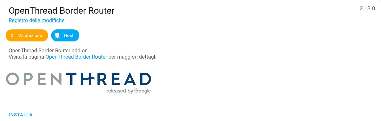

Issue B:
on Settings-> Addons → Add Addon i search “open thread border router” and appears the addon to install:
have I to install the addon “open thread border router” in addition to already having the auto-configured integration installed in Settings → Devices and Services → integrations? or is it not necessary? I think is not… because the addon should be for other configurations, and in this case the integration is configured automatically… i don’t know…
if Yes, What settings should I set?
when i installed the addon “open thread border router” it works for few minutes and after it stops. it’s not working properly.
also starts to compare a warning:
2025-08-01 13:46:29.192 WARNING (MainThread) [homeassistant.components.otbr.config_flow] Failed to communicate with OTBR@http://81bc2df9-hassio-ihost-silabs-multiprotocol:8081:
i tried to disinstall the addon and the warning seems resolved after restarting HA.

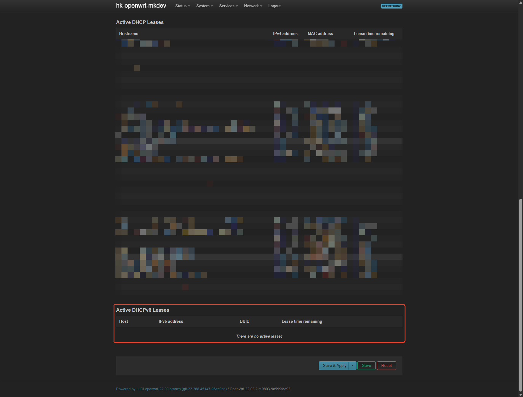

I configured on HA IpV6 as automatic. How can i configure my modem router parameters to work with Matter?
How can i get updated the integration of “open thread border router” and “Thread” ?

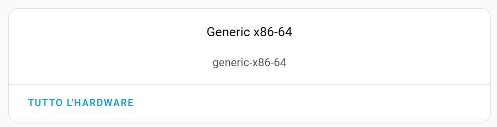

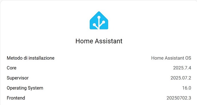

Second do you run a 32bit HA? This has been set for deprecation in one of the latest releases and will go around new year. Many addons do not work with it, because many of third party libraries needed are not available in 32bit.
Ha on a 64Bit pc
But is HA 64bit?
You can run a 32bit OS on a 64bit machine, but not the other way around.
Very intresting! i never thought about this issue. maybe this is the problem of some warnigs i have…

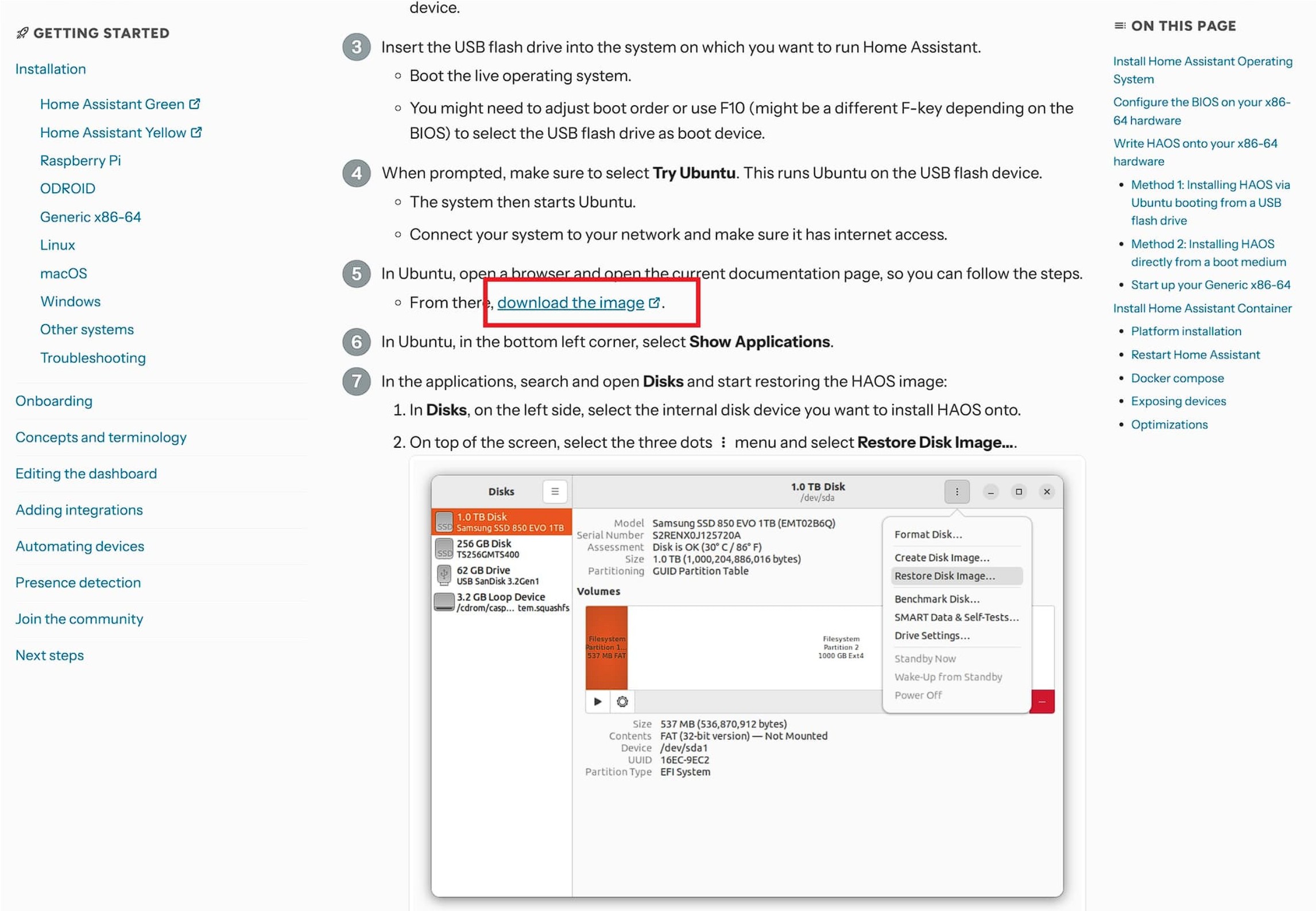

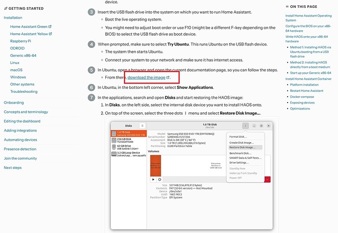

i Download the HA image from Here:
at this link:
On installation information HA reports this:
Issue A: The Matter Server, OpenThread Border Router Add-on (and other gray add-ons) under Hassio iHost Add-ons are supposed to run on Home Assistant OS over SONOFF iHost which is based on 32 bit SoC.
Since you are running Home Assistant OS on 64 bit PC, you can’t install them. But there are corresponding 64 bit add-ons with the same name, you should be able to find them on the Add-on Store page.
Basically, you can just safely ignore these gray add-ons.
Issue B: You should not install OpenThread Border Router add-on if you are using Multiprotocol firmware because the Silicon Labs Multiprotocol add-on you have installed earlier automatically creates an OpenThread Border Router by default, and that OpenThread Border Router will be automatically discovered and enabled by intergration OpenThread Border Router and intergration Thread.
You should install OpenThread Border Router add-on if you are using OpenThread firmware of ZBDongle-E.
Issue C: I don’t think you need to adjust your Wi-Fi router’s IPv6 settings in order to use Thread network. I believe the default settings should just work. I have even completely disabled the IPv6 function on my Wi-Fi router, and all Matter over Wi-Fi and Matter over Thread devices still work.

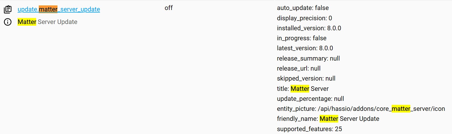

Settings-> Developer Tool → States
Auto update is “False” → and Doesn’t appear in: Settings → Addons → Matter Server the option to autoupdate the addon
Does Home Assistant notify you if there’s a Matter update available? The same goes for Silicon Lab Multiprotocol that does’t have an autoupdate on:

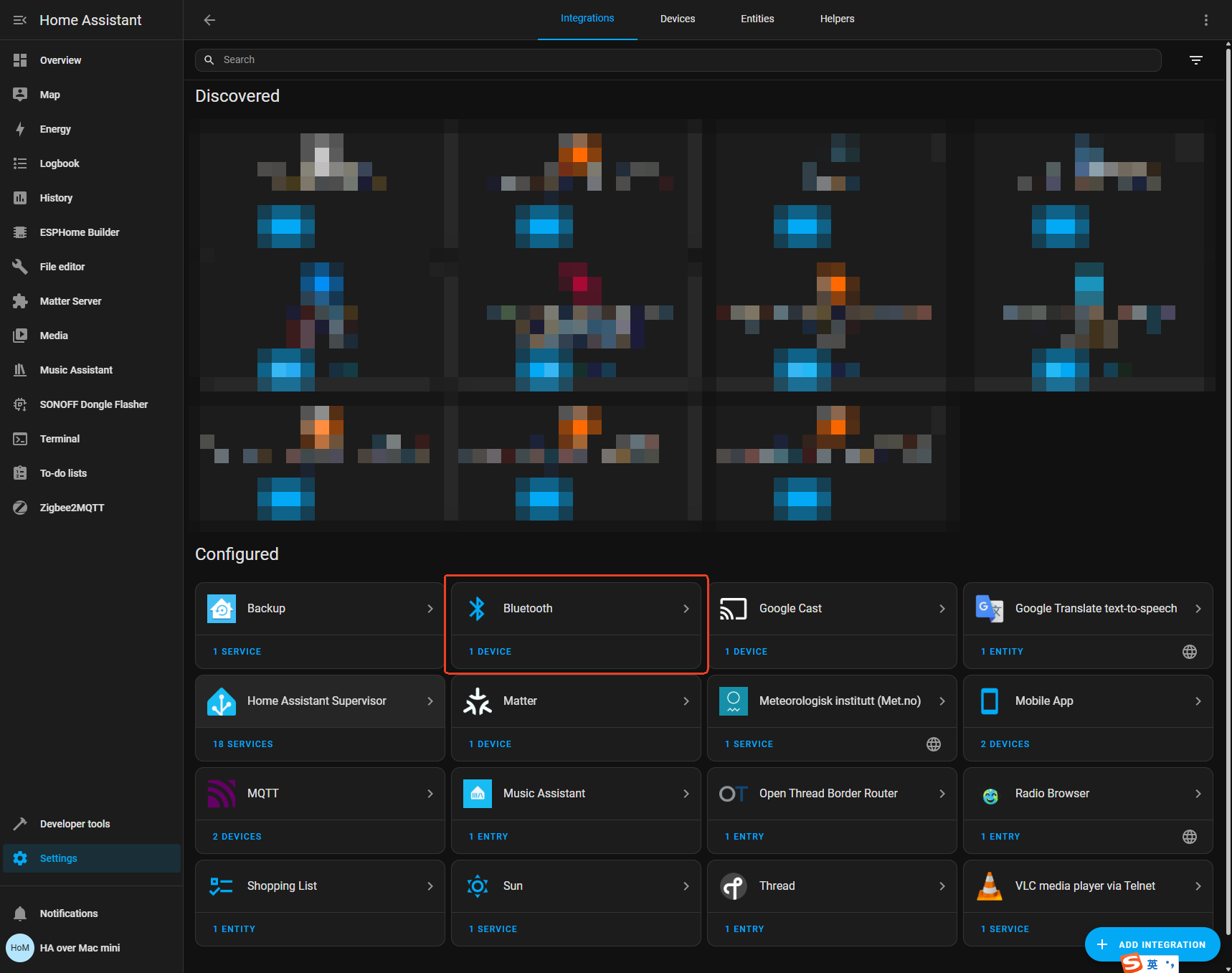

If you see Bluetooth intergration already enabeld on Settings -> Devices & services page, then your current bluetooth adapter is good to go.
Having said that, you don’t need to have bluetooth adapter if you are going to add Matter over Wi-Fi devices through Home Assistant Companion App. The Home Assistant Companion App will use the bluetooth adapter on your phone.

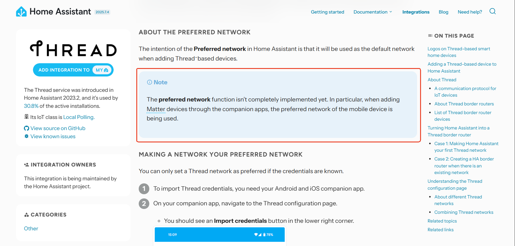

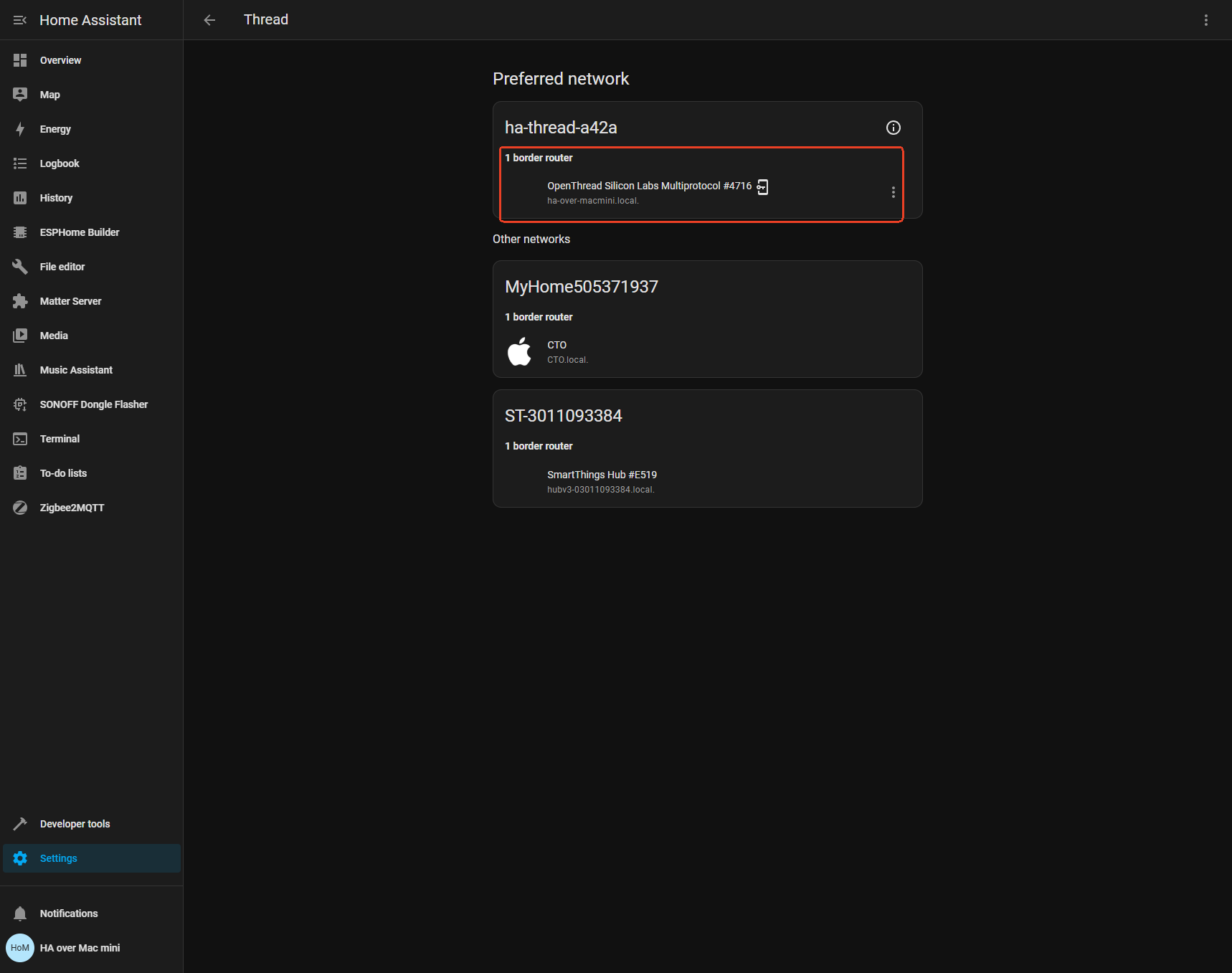

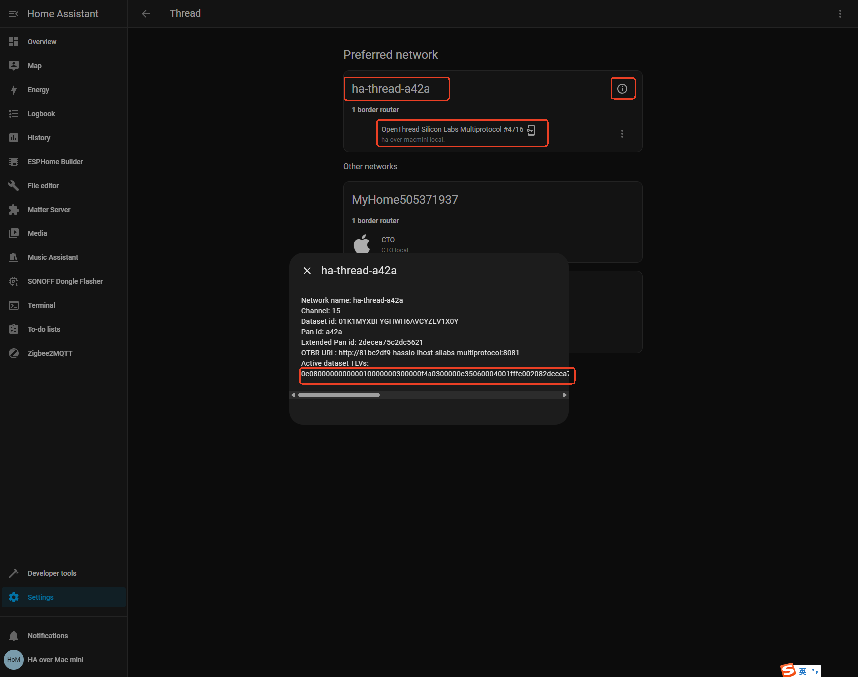

Note: you can’t add Matter over Thread devices to the Open Thread Border Router provided by Silicon Labs through Home Assistant Companion App because Home Assistant Companion App will always use the Open Thread Border Router provided by your phone vendor (Google or Apple). Please refer to Thread - Home Assistant for details. Correct me if I am wrong.
So now, If you want to add Matter over Thread devices to Silicon Labs’ Thread network, you can only do it through the WebUI of Matter Server add-on. It looks like this:
If the Commission new WiFi device option and Commission new Thread device option are both gray, then you haven’t specified the Bluetooth Adapter ID on the Configuration page of Matter Server add-on. The ID should be 0 if you have only one bluetooth adapter.
You can, but you need to get the credentials on the phone.
If HA can see the network, then the companion app can copy them in.
If HA can not see them, then you need to find another way to get them in.

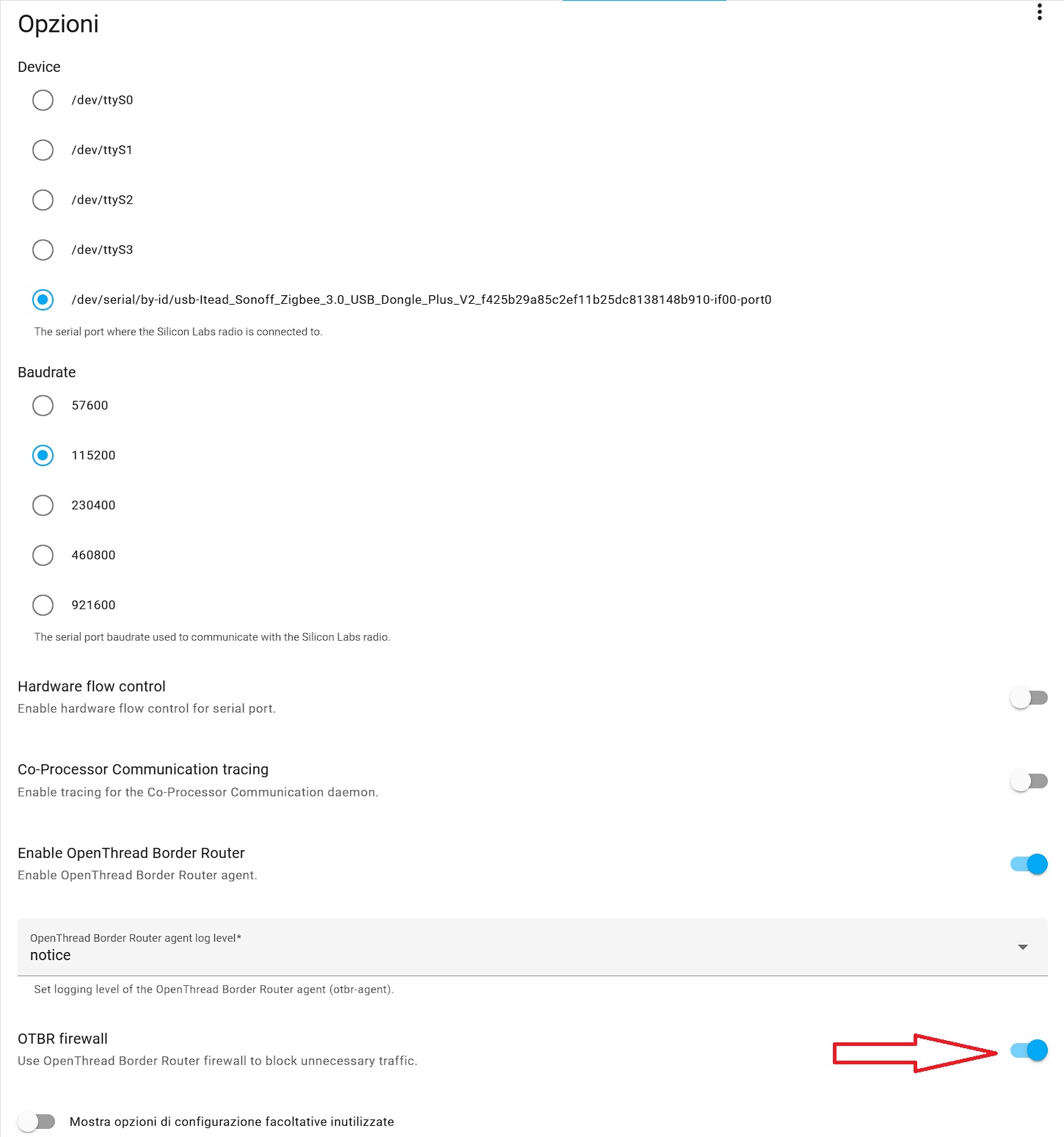

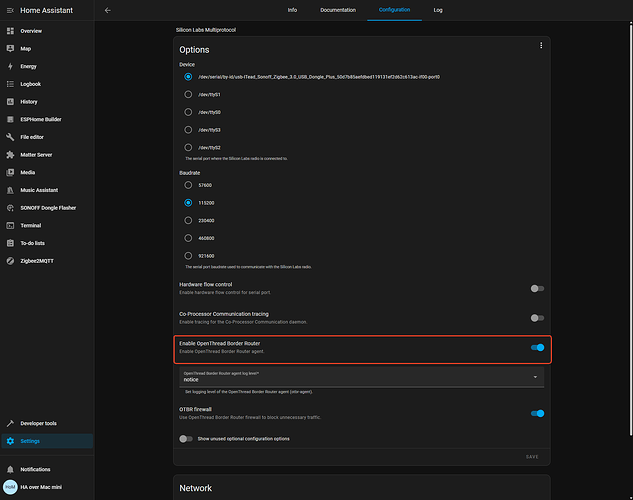

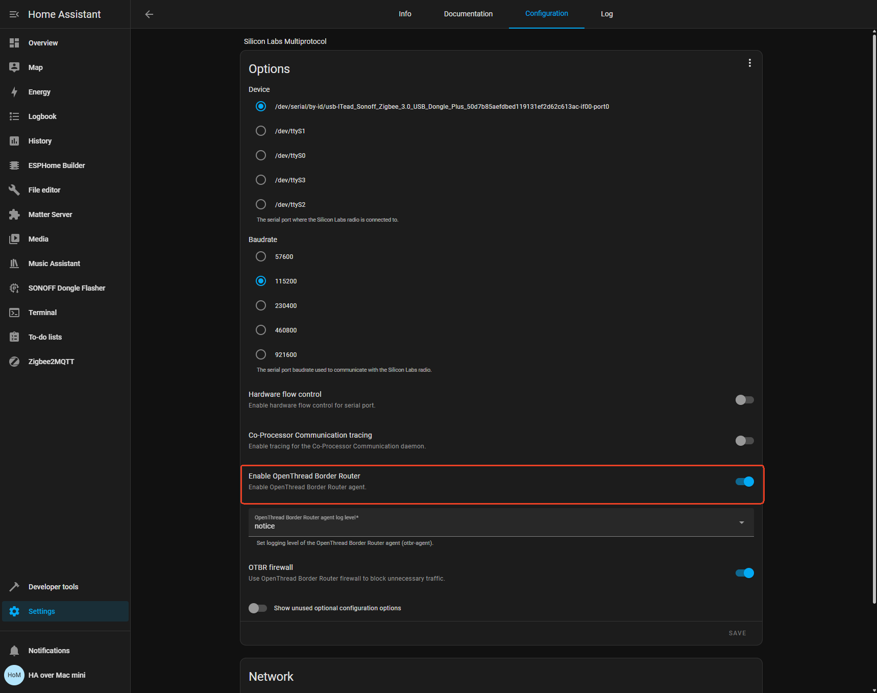

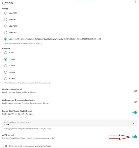

In the configuration page of Silicon Lab Multiprotocol addon there is a check:
“Enable OpenThread Border Router”

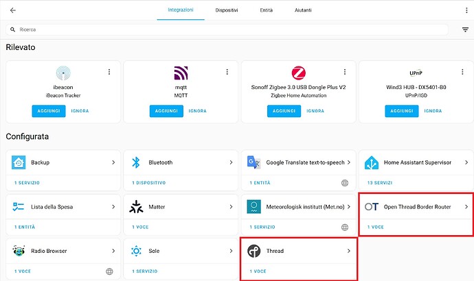

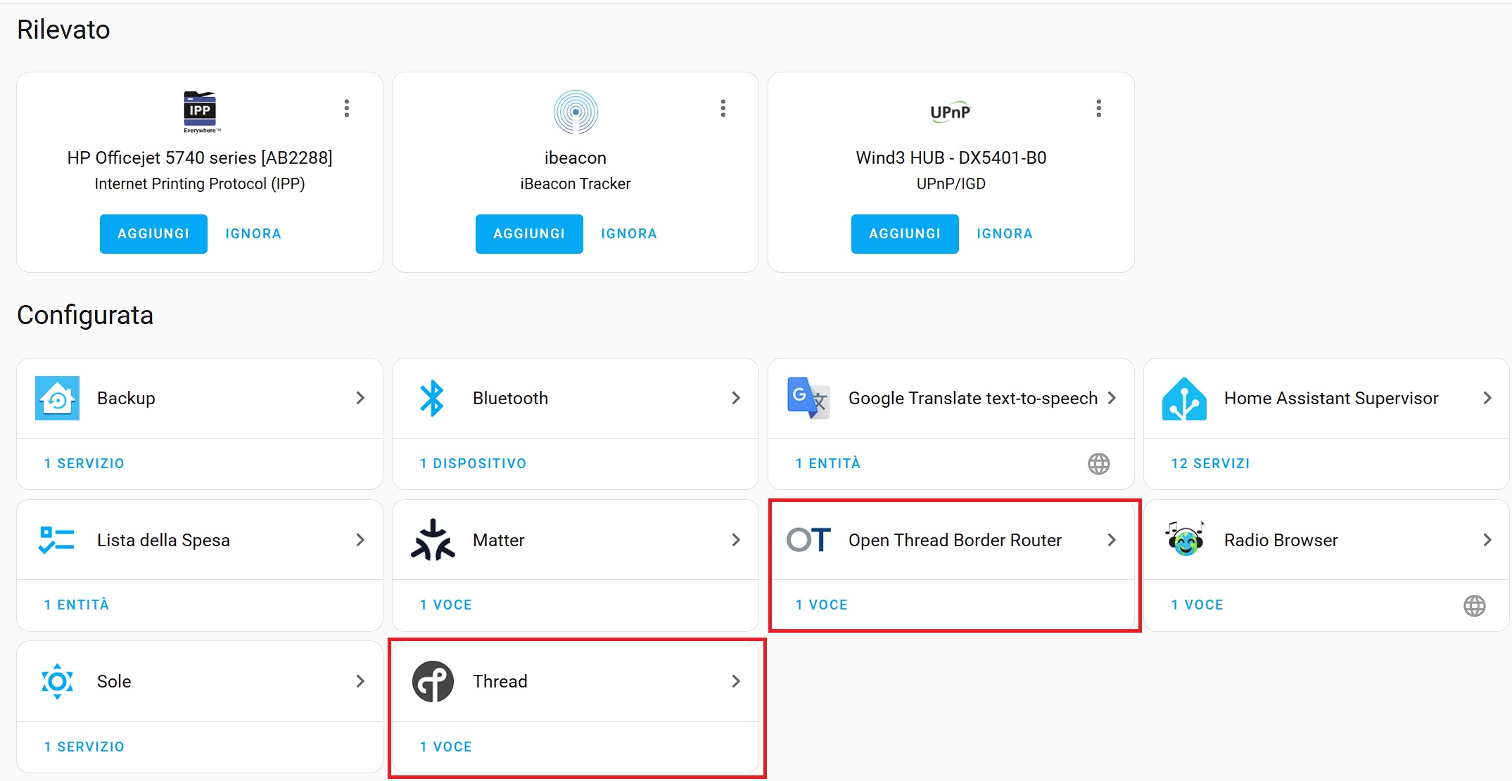

I Think this is the reason why compares “OpenThread Border Router” and “Thread” Integrations atomatically and setted automatically by Silicon Lab Multiprotocol addon with near no way to configure these.
infact if i restart the Silicon Lab Multiprotocol addon restart also the “OpenThread Border Router” i checked it on the logs
[20:46:51] INFO: Starting otbr-agent...

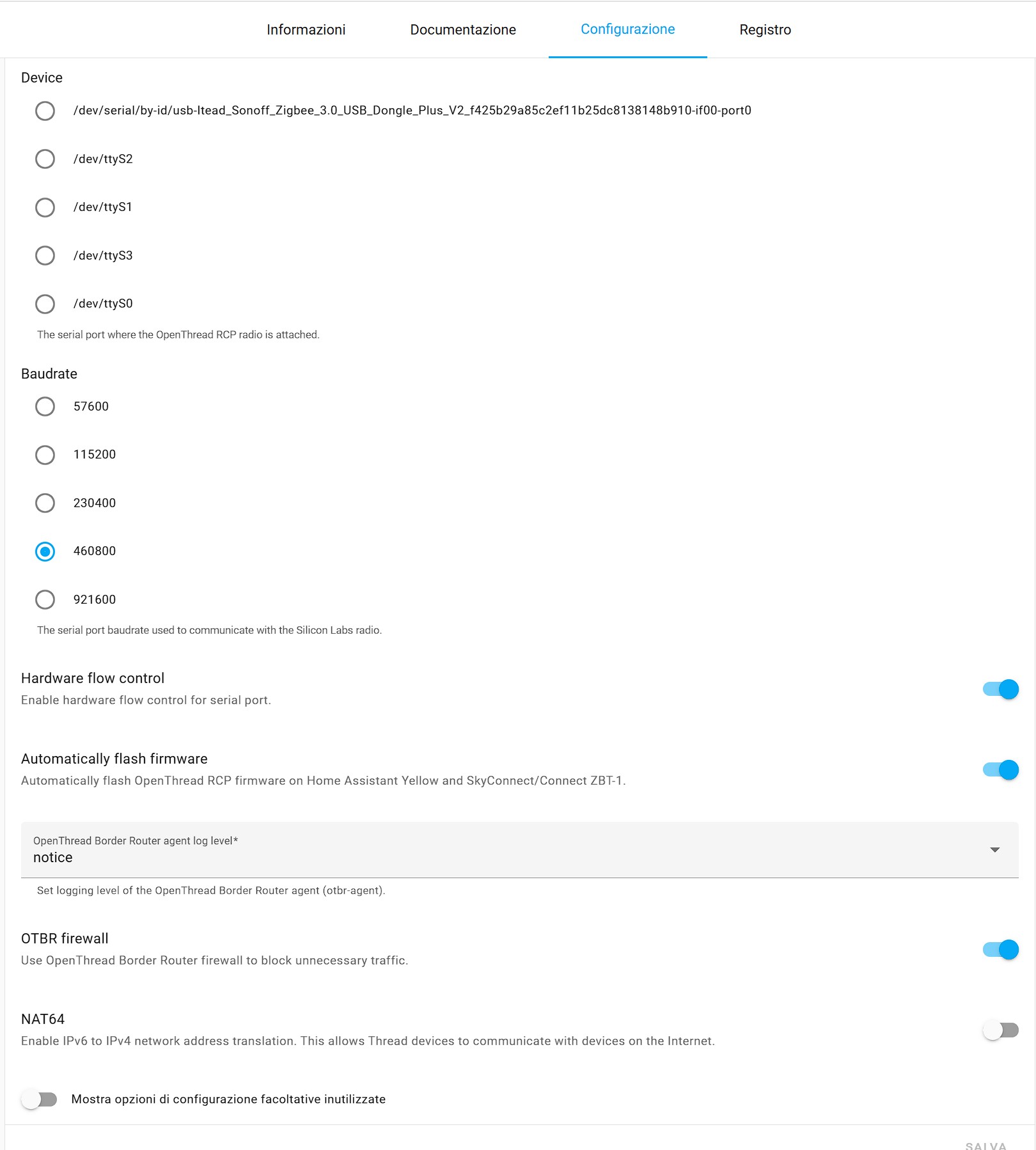

in the configuration of “Silicon Lab Multiprotocol addon” i have OTBR Firewall:
if is turned on i have no errors on the logs of Silicon Labs Multiprotocol addon
if it turned on i have this log:
otbr-agent[289]: 00:00:34.081 [W] Platform------: Firewall - failed to update ipsets: Failed
otbr-agent[289]: 00:00:34.128 [W] DuaManager----: Failed to perform next registration: InvalidState
ipset v7.10: The set with the given name does not exist
otbr-agent[289]: 00:00:34.135 [W] Platform------: Firewall - failed to update ipsets: Failed
otbr-agent[289]: [NOTE]-BBA-----: BackboneAgent: Backbone Router becomes Primary!
otbr-agent[289]: 00:00:34.849 [W] Platform------: Firewall - failed to update ipsets: Failed
otbr-agent[289]: 00:00:35.132 [W] DuaManager----: Failed to perform next registration: NotFound
otbr-agent[289]: 00:00:35.771 [W] Platform------: Firewall - failed to update ipsets: Failed
otbr-agent[289]: 00:00:36.130 [W] DuaManager----: Failed to perform next registration: NotFound
otbr-agent[289]: 00:00:46.963 [W] Platform------: Firewall - failed to update ipsets: Failed
otbr-agent[289]: 00:00:47.125 [W] DuaManager----: Failed to perform next registration: NotFound
i have disabled ipv6 on HA and on the Router as humingchun told to me

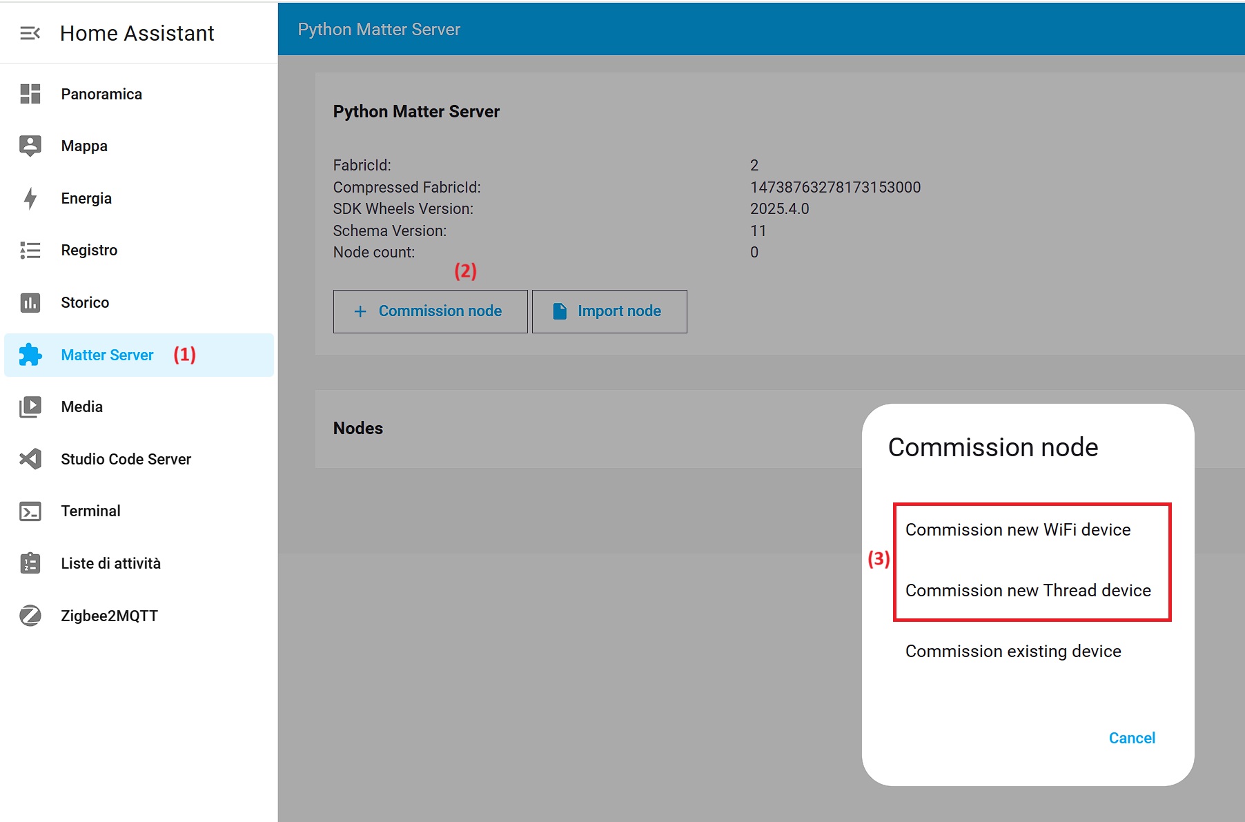

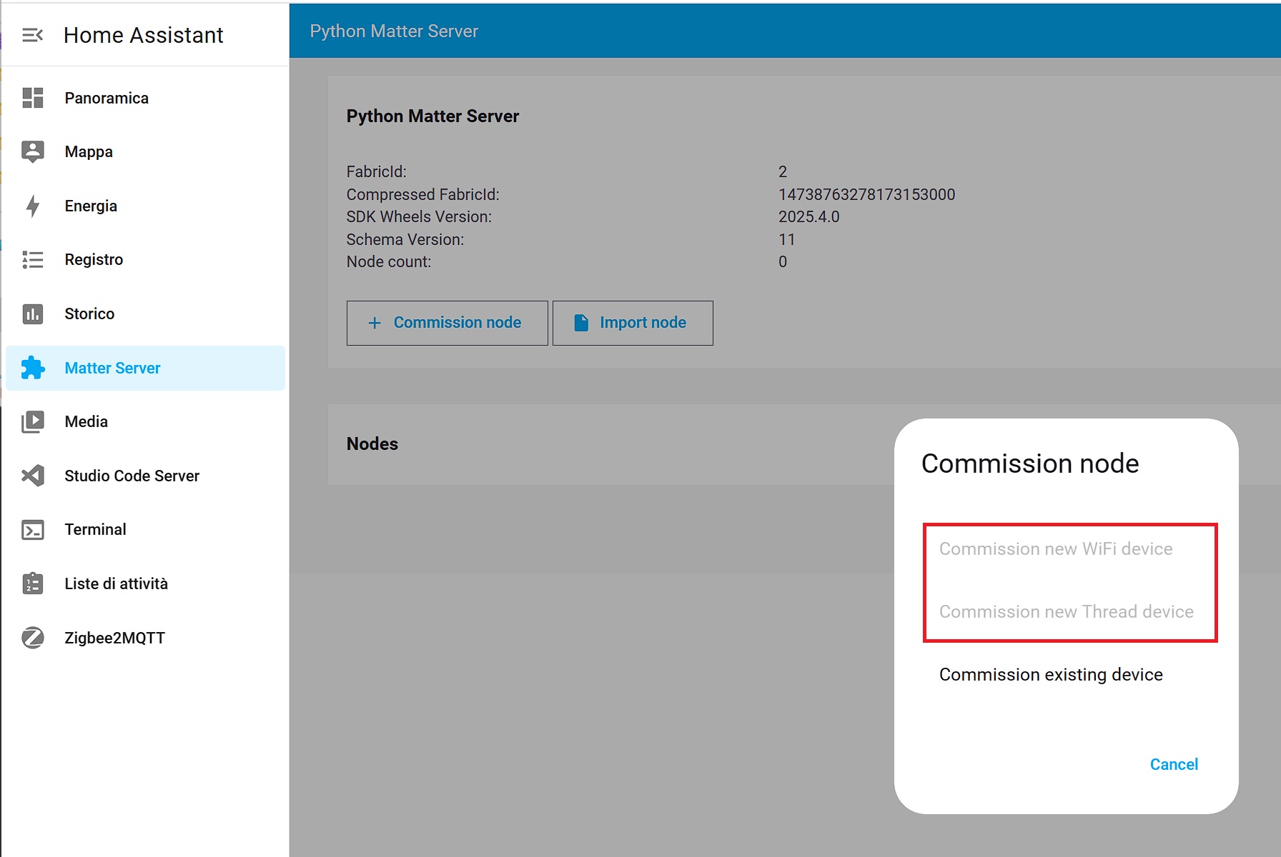

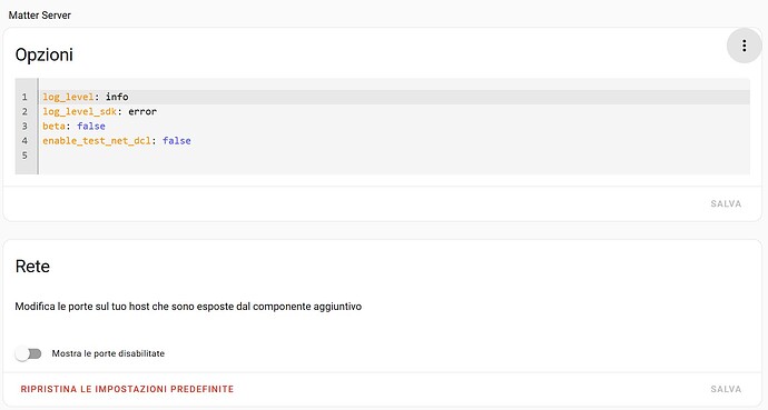

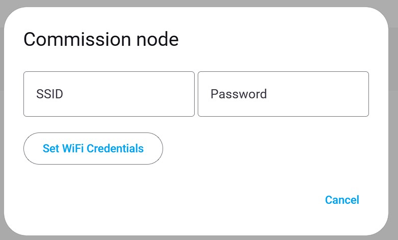

Matter Server Configuration:

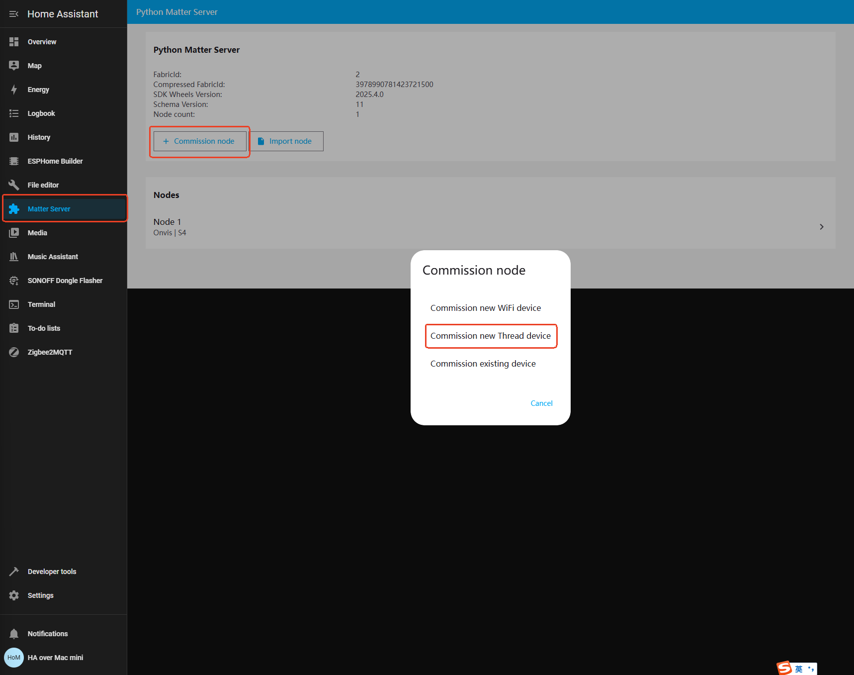

in the WebUI of Matter Server add-on the Commission new WiFi device option and Commission new Thread device option are both gray

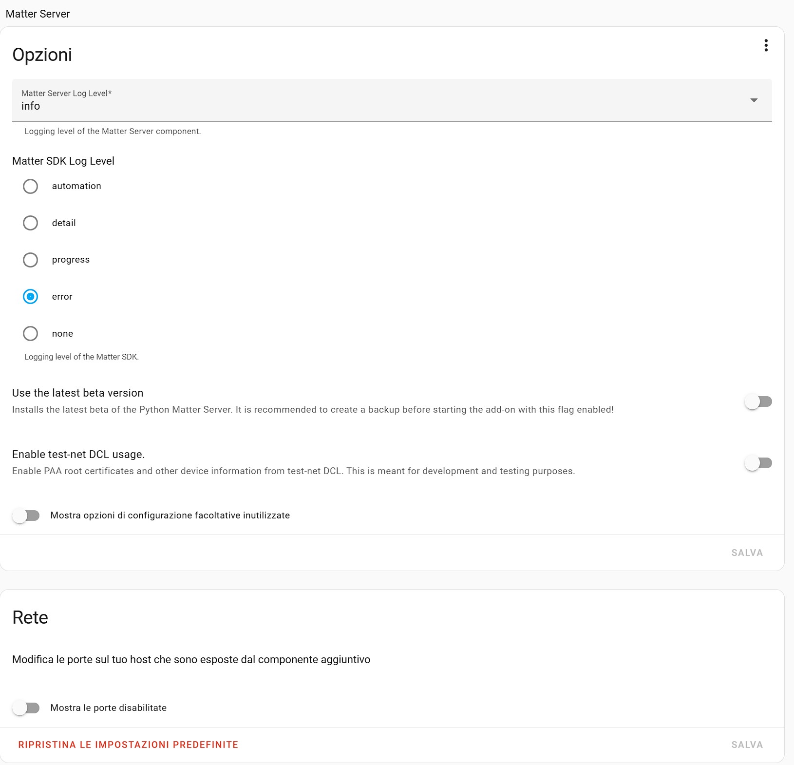

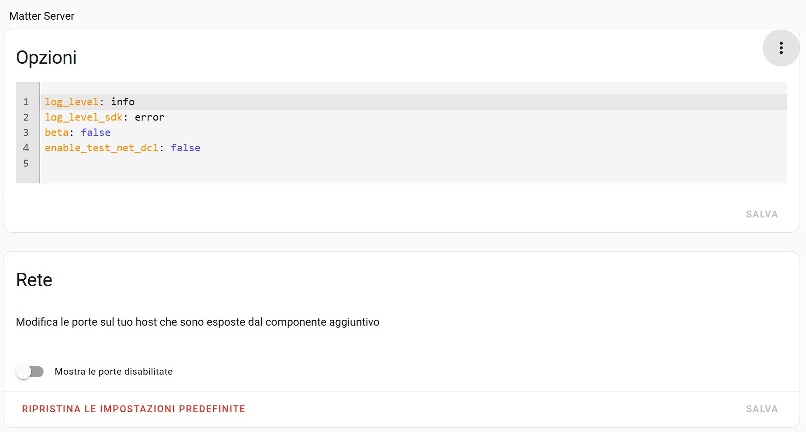

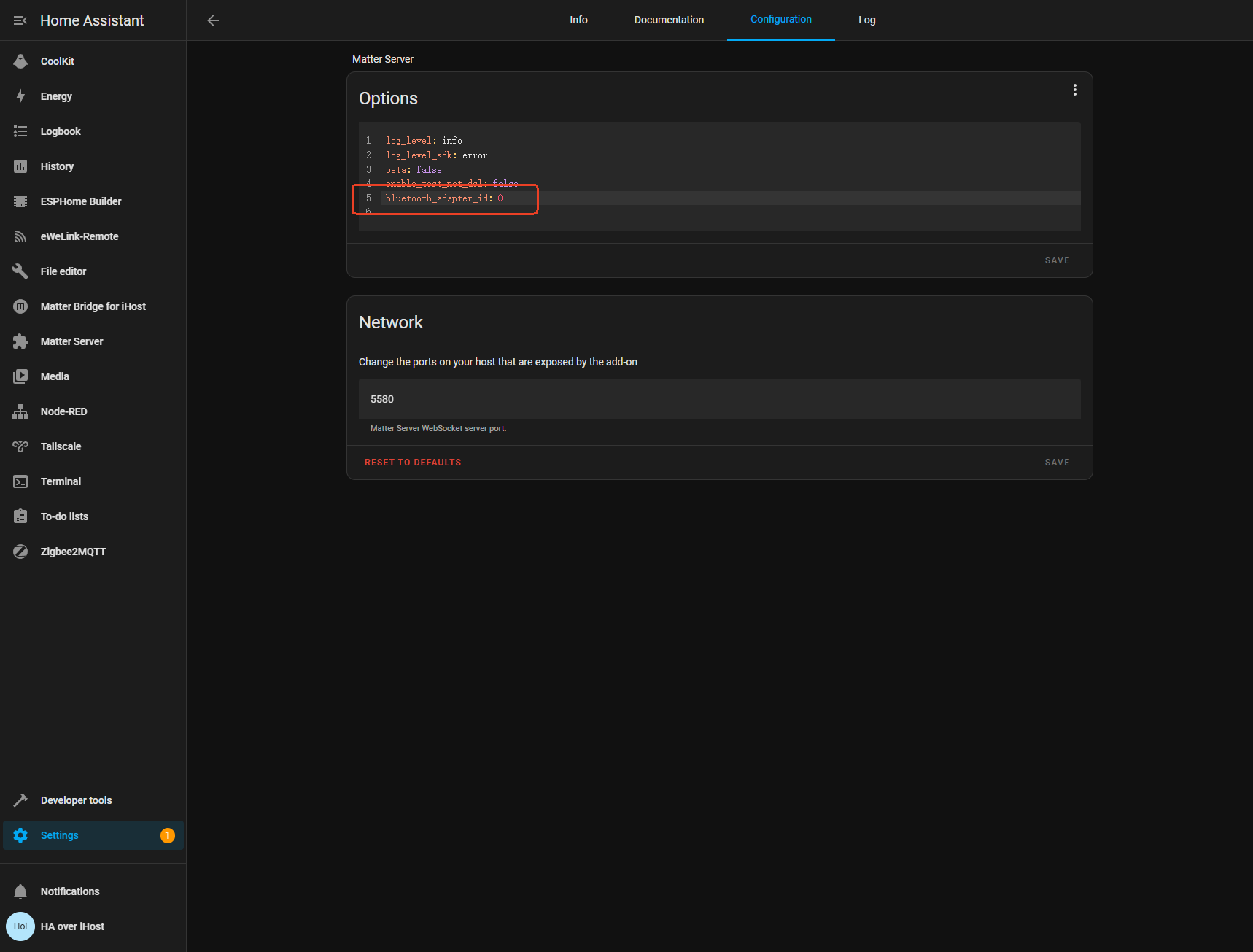

On the Configuration page of Matter Server add-on appear this screen:
After Click “Modify in YAML” compare this screen:
and actually nothing appears regarding the Bluetooth adapter device
I added “bluetooth_adaper_id: 0” to the YAML configuration of the addon
And Now in the WebUI of Matter Server add-on the Commission new WiFi device option and Commission new Thread device option are both dark and available

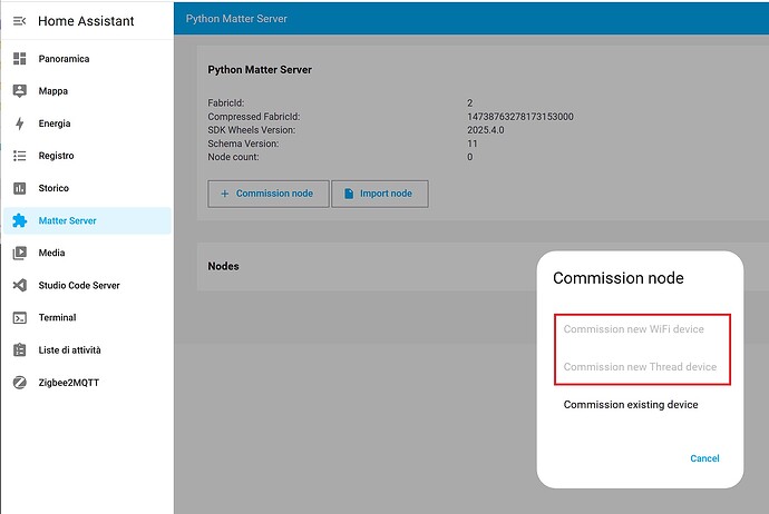

Now how can I add a Matter Device? if it is possible?
if i click on: “Commission new WIFI device” compare this screen:

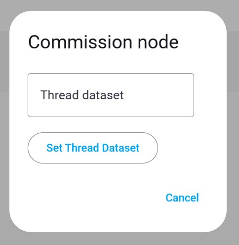

if i click on: “Commission new Thread device” compare this screen:

i think if i update the Silicon Lab Multiprotocol addon it updates also the Open Thread Border Router Integration and Thread Integration. what do you think?
But i dont know how to update the Silicon Lab Multiprotocol addon and as well the Matter Server Addon
i download HA from Here:
at the official link:
i read somewhare x64 on the logs… Can you confirm to me if this image is a 64Bit or a 32Bit? in case, where should I download the 64Bit HA image?
You are already running the 64-bit version as confirmed here.

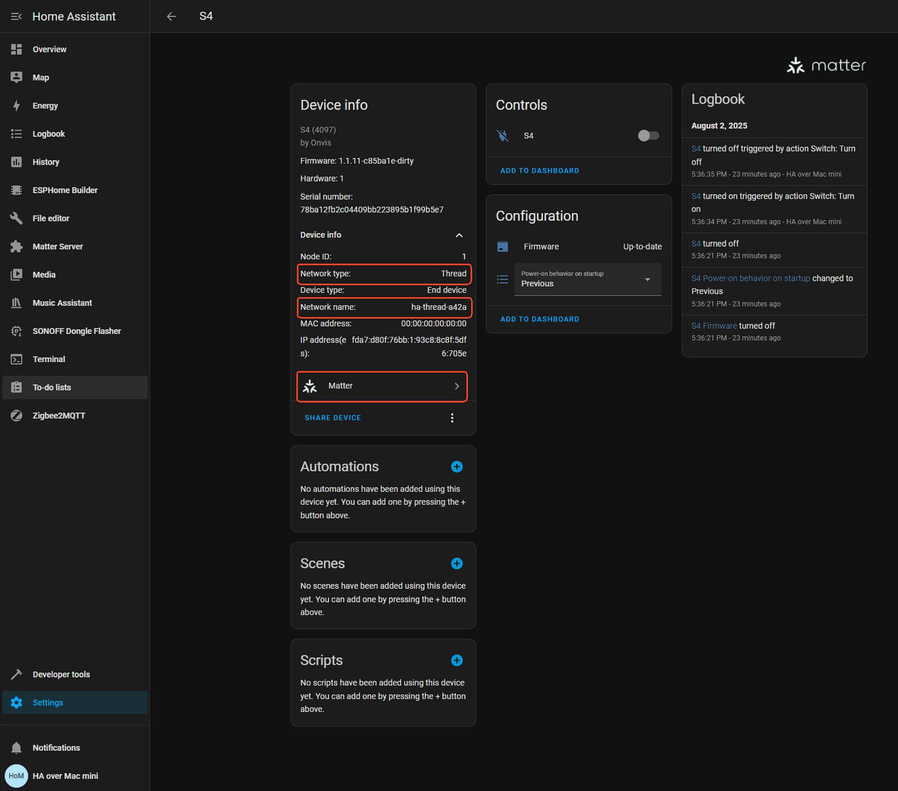

You can not commision a device directly from the Matter addon web page unless your HA server have a bluetooth adapter connected exclusively for Matter, ie. it can not be used for other stuff.
Congratulations, you are ready to go. Just add Matter over Wi-Fi and Matter over Thread devices by following the instructions on the Matter Server WebUI.
When you commission Matter over Wi-Fi devices, you need to tell the device your Wi-Fi SSID and Password, right? That’s why you must specify them on the Matter Server WebUI.
The same goes to Thread dataset when you commission Matter over Thread devices. You can get the Thread dataset from Settings -> Devices & services -> Thread integration -> Configure button -> Thread network information button of Preferred network.
The rest is a standard pairing process: Input Matter Pairing Code, etc.
Have you really tried that? I did, many times, it didn’t work.
Goto Settings -> Companion app -> Troubleshooting on your Home Assistant Companion App, and click Sync Thread credentials, you can sync the Thread credentials. You can also click SEND CREDENTIALS TO HOME ASSISTANT button on Settings -> Devices & services -> Thread integration -> Configure button page.
But as I mentioned before, Home Assistant Companion App will use Google’s Thread network on Android phone, and use Apple’s Thread network on iPhone, not the Thread network provided by Multiprotocol add-on.
