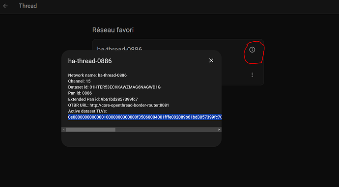

I had the exact same issue with my installation.
The only way to resolve the issue is by following @agners procedure Fix for issue of credentials sync
I succefuly paired the smart window to my HA…
I also did it using the Matter server UI (you go to comissionning, write the matter code and it should add itself without the phone)…

I was able to follow your instructions but now struggle with the Thread credentials. Which elements do I need to use from the Thread information panel to enter as Thread data set and Pairing ID?
ha-thread-12dc
Network name: ha-thread-12dc
Channel: 15
Dataset id: 01J94CK28HE8B0S6BR74RKSZ3N
Pan id: 12dc
Extended Pan id: 9aca06c1268c0804
OTBR URL: http://core-openthread-border-router:8081
Active dataset TLVs:
this one :
Excuse-moi, je comprends vite, il faut juste m’expliquer longtemps :slight_smile:
Seriously, the dialogue is asking for two entries, the Thread ID and the pairing code. If I understand you correctly, the TLV is the pairing code. What is then the id, the Pan id?
please respond in english (yes i’m french too), but it’s more respectfull if everyone understand what we say … :slight_smile: no problem we are here to help.
no no you are 50% correct.
-Thread ID : “Active dataset TLVs” for example : 0e080000000000010000000300[…]etc
-Pairing code : the matter code on the device such as : XXXX-XXX-XXXX (associated with QR code )
Pairing code must be writen without the ‘-’
for example :
