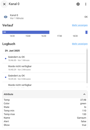

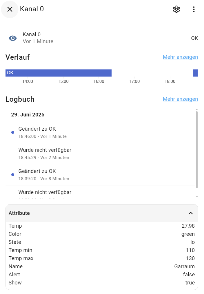

Is it possible to get min/max or segment values from a attribute of the entity? I was able to do it for the actual temp but not for those.
I have a entity that has multiple attributes:
How can I use the temp_min and temp_max for the gauges segments? Tried different syntax but nothing is working. This is what I have for the current temp:
type: vertical-stack
cards:
  - type: entities
    entities:
      - sensor.kanal_0
    show_header_toggle: true
    state_color: false
  - type: custom:auto-entities
    card:
    card_param: cards
    filter:
      template: |-
            'type': 'gauge',
            'entity': 'sensor.kanal_0',
            'attribute': 'temp',
            'name': 'Garraum',
            'needle': true,
            'min': 0,
            'max': 350,
            'segments': [
              {'from': 0, 'color': 'red'},
              {'from': 110, 'color': 'green'},
              {'from': 130, 'color': 'red'},
Use state_attr instead of fixed values like “state_attr(‘sensor.xxx’,’some_attr’)”.
Cannot give a ready code, away from pc.
Thank you, that information was enough for me to fix it.
