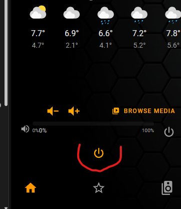

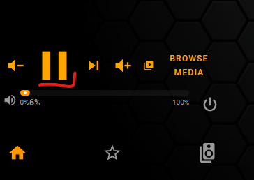

Hi everyone, I have been using this card for a while now and I love it.
I need to tweak it a little bit to fit my needs, and I also noticed a few glitches with the card.
  1. When player is idle, i see extra “power button” just under the volume slider. There is another on the right side of the volume slider as well. Wen the media is played that extra button disappear.
I tried to uses card_mode style to get rid off this extra button, but I have really hard time to achive that.
2. When media is played the PLAY/PAUSE button is exceptionally large. I like to have the same size a the other buttons on the control board (i. volume icons)
here is my styling with the card_mode:
          card_mod:
            style:
              mxmp-player$ mxmp-player-header$: |
                .song {
                  font-size: 0.2em; !important;
              mxmp-player$: |
                mxmp-player-header, .artwork {
                  display: none;
              mxmp-player$ mxmp-player-controls$: |
                .icons * {
                  color: orange;
              mxmp-player$ mxmp-player-controls$ mxmp-volume$: |
                ha-control-slider {
                  height: 8px;
                ha-icon-button {
                  --mdc-icon-button-size: 2rem !important;
                  --mdc-icon-size: 1.5rem !important;
                ha-card {
                  background: transparent !important;
                  box-shadow: none !important;
                  border: none !important;
                  width: 100%;
                  left: 0%;
                  top: 0px;
                  --rgb-card-background-color: false;
Please, can someone advise how to fix those two issues? (I know it can be achieved with card_mode but I’m probably getting the nesting incorrect :frowning: )
Thank you.
