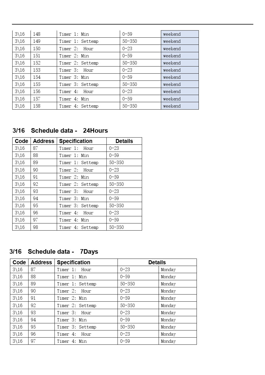

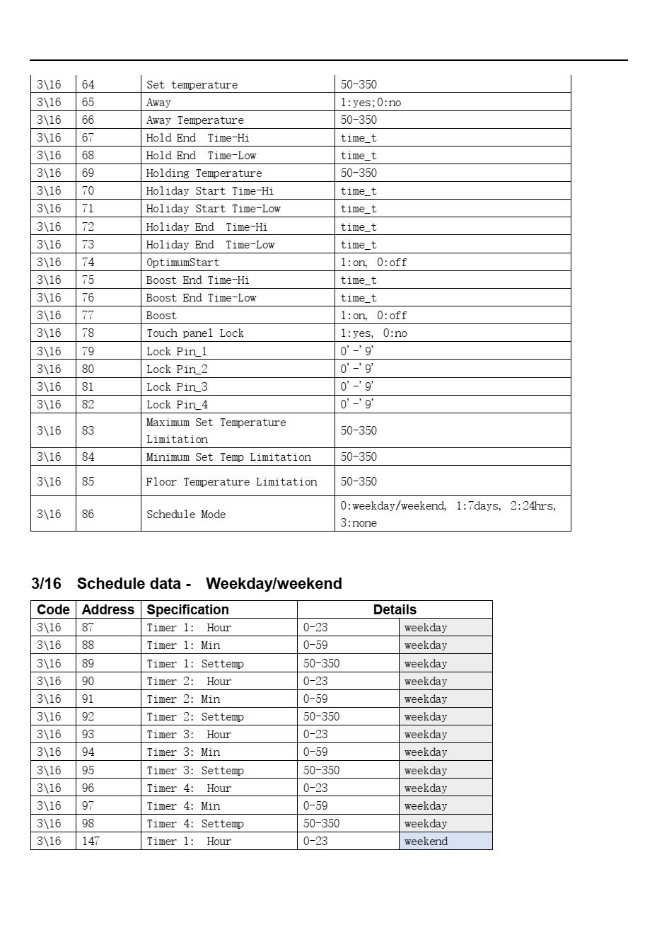

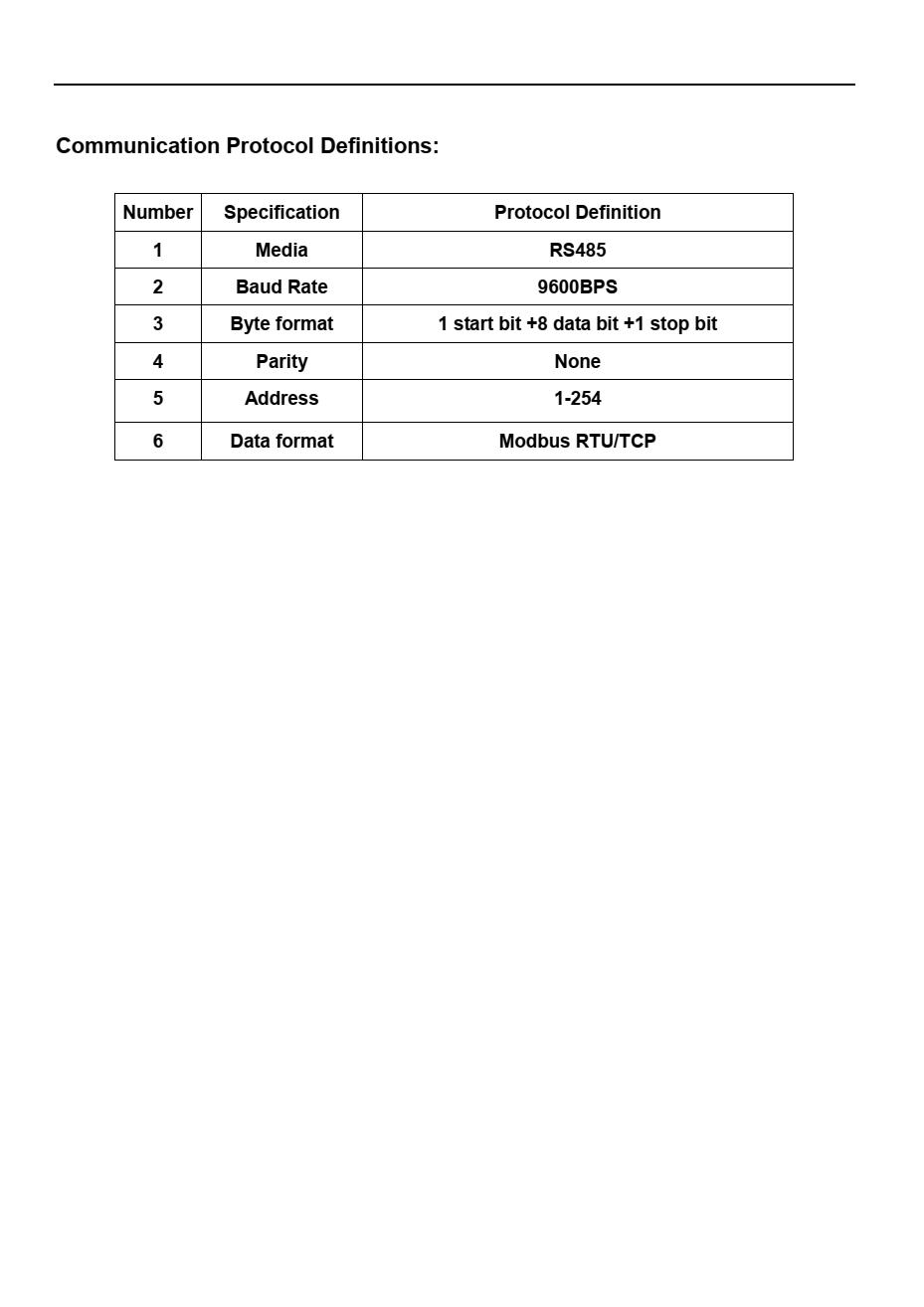

Many thanks! I found the PDF with the ModBus codes but I dind’t find the process to activate it. That really helped!
I am currenty dealing with the configuration in Home Assistant. For the moment, I am not able to get the data from the thermostat. If I get it I will publish it

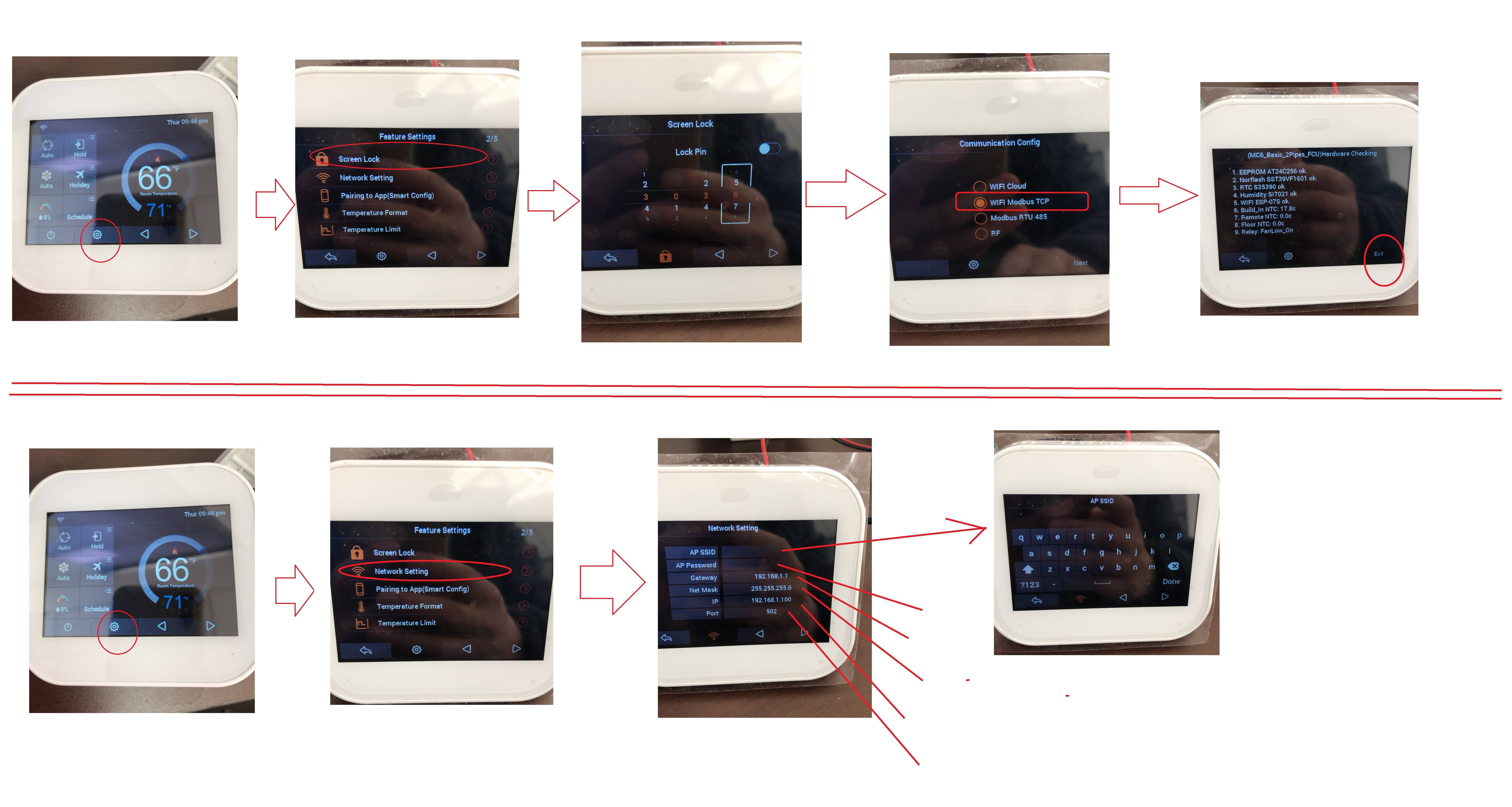

Hi Tiziano. I cannot enter the hidden menu or lets say when I enter it I got the specs window only and if a touch the screen, it reboots to the home menu(looking at your pics, it jumps from pic 3 to pic 5 missing the network menu. Any idea ?
Grazie
You need to push lock icon to confirm
Bye
Thanks. However the point is that I am able to enter the hidden menu but rather than giving me the network options, when I press the lock icon it jumps to the hardware checking page and no other option buttons are displaied. Any further screen touch, resets the thermostat and clear the original settings… My fw ir on rel. 2.0
Is the same for me.
But after reboot you must go to the wifi menu, and specify a fixed ip address for the modbustcp protocol and ssid/password
