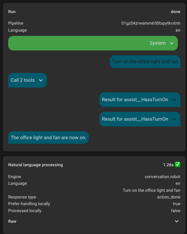

To try and provide some helpful feedback:
One thing that makes this more difficult for me is that it doesn’t look like the tool calls get added to the debug view in home assistant, which makes it more difficult to debug my tools and see exactly what the LLM passed in. For scripts you can use the trace feature but for other python based tools it is more difficult to see.
This is what I am referring to which is missing:
Great suggestion!!
Although I have tons of debug logging into the main HA system logs, I would love for the tool calls to appear within the voice assist debug pages too.
I’ll look into it and get it added! Thanks.
@crzynik I have now added the chatlog functionality for the voice assistant debug view you showed above.
Makes it much easier to follow what tools the LLM is using. :grin:
