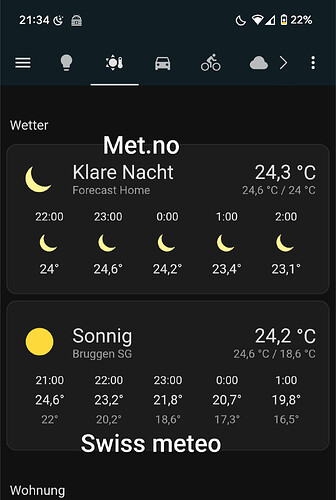

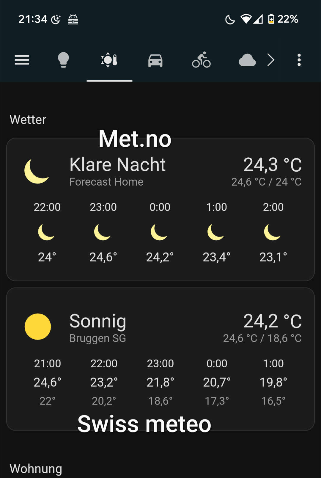

Hello everyone,
Just installed this fork and everything went well.
Two things are not clear to me
Met.no weather card shows the corrext icons, its actual night.
Meteo-swiss is always sunny and it shows three lines of numbers (time,temp,temp) what is the correct temp?
Is this a known bug (icon, to much temps)?
It’s not clear to me why that’s happening. Perhaps because the Swiss metro integration gives you the upper and lower temperatures of a time range. I know that the hourly temperatures do not get the icon because the information is simply not available through the API.
