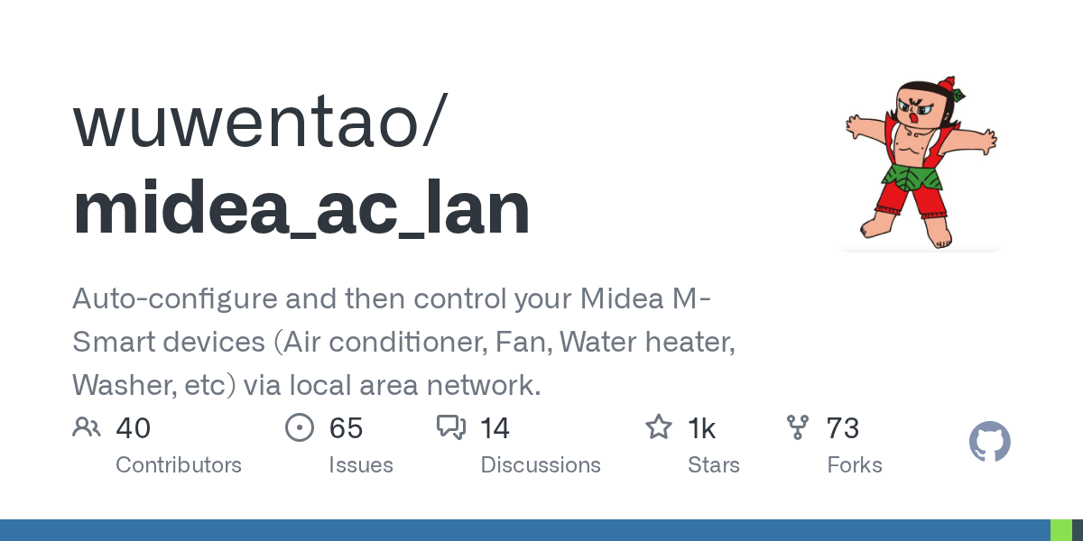

Hi sorry the the best at helping in tech language or a complete how to . I did fix by going into hacs and downloading from there. The old version does not work any longer.
good luck
I use the more up-to-date HACS integration I’ve linked in a post here

Are you using this?
