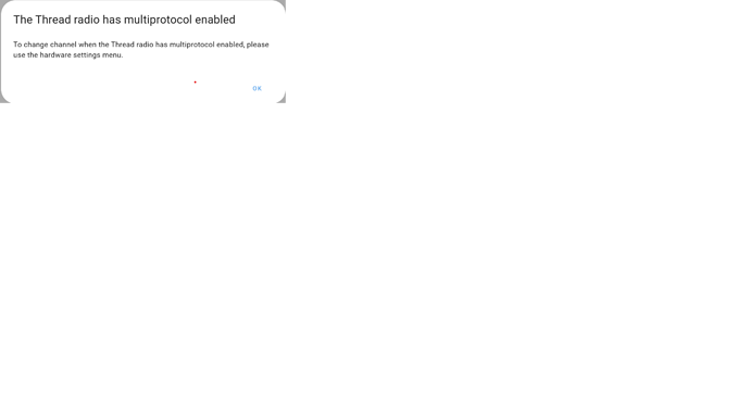

I see my ZHA is running on channel 25. Where do I change channel for Matter? When I tried changing it in the Thread configuration it tells me I have to do it in hardware settings menu. Not sure where this is.
The hardware settings menu is only available for the Skyconnect dongle and the HA Yellow :frowning:
See this issue for work-arounds :
Does
settings → devices & services → thread → configure → 3 dots → Change channel
not work ?
I did the same as your above screenshot, but I got a popup which said I have to change the channel in hardware settings.

I couldn’t change the channel in both zha and thread settings. Below is the message I get for thread, but I get a similar message when tried to change the channel in zha.

There is no easy solution to the channel mismatch right now, but you can change the Thread channel to match Zigbee via the api
Other work arounds are also mentioned in that thread.
