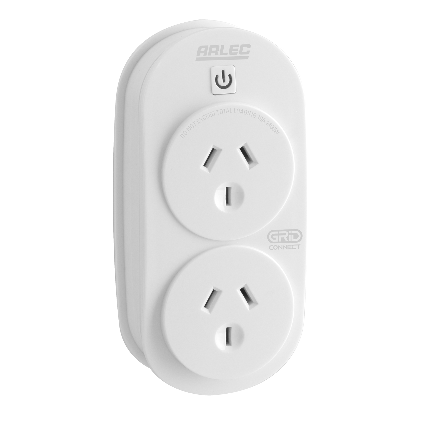

  • Arlec Smart Plug In Twin Socket. As stated above I could get this working easily. Just follow the instructions from “Kanga_who” above.

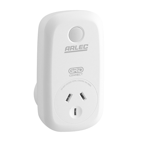

  • I have another “Arlec Smart Plug (single)” from Bunnings that I successfully flashed. I currently have an issue with it that it keeps resetting. So I set it up with all the correct settings (in Tasmota), update to the latest Tasmota .bin file and within a few minutes it’s gone. When I check for new wifi networks it’s back as “sonoff-xxxx”. This has happened a few time now. I think I need to do a “erase all flash” and see if that helps.
