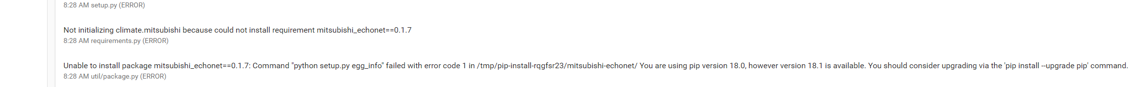

I had try the manual way first but got the following error
The new 0.1.7 version of your package doesn’t seem to help unfortunately

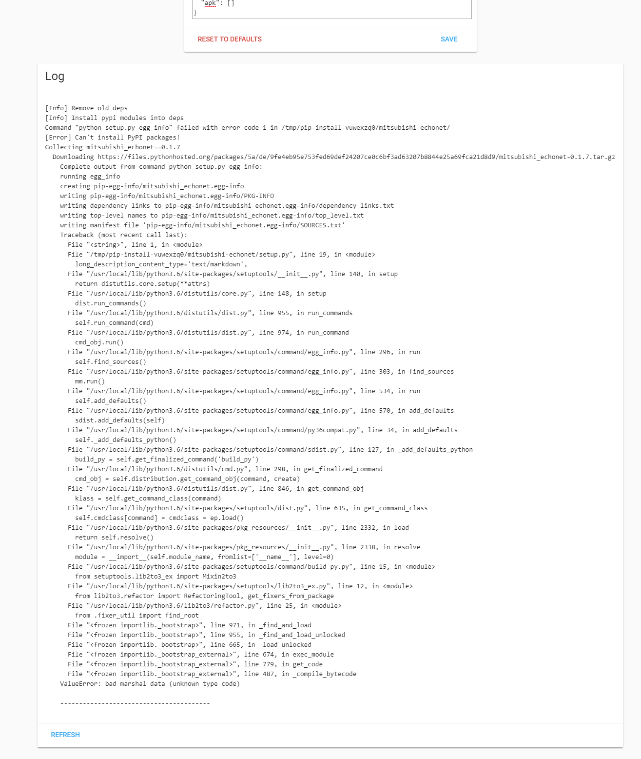

I ended up running up a parallel development environment on a VM to do some more testing. Basically the Home assistant built-in dependancy handling seems totally stuffed up. However I did manage to get it working again on 83.3 and HassOS 2.3
There is another way you can try - you can install the official hass.io add-on called ‘Custom Deps Deployment’ - this should allow you to install the library into the deps folder. Use the following yams in the config for the add-on
  "pypi": [
    "mitsubishi_echonet==0.1.7"
  "apk": []
This should install the library into the following folder - /config/deps/lib/python3.6/site-packages
If doesn’t work I have run out of ideas at this stage. Home Assistant is in pretty early development and a lot of behaviour like module installation simply isn’t happening properly between the different flavours of Home Assistant. I might give up and compress everything into a single library

Unfortunately, I run into the same error when installing using Custom Deps Deployment:
