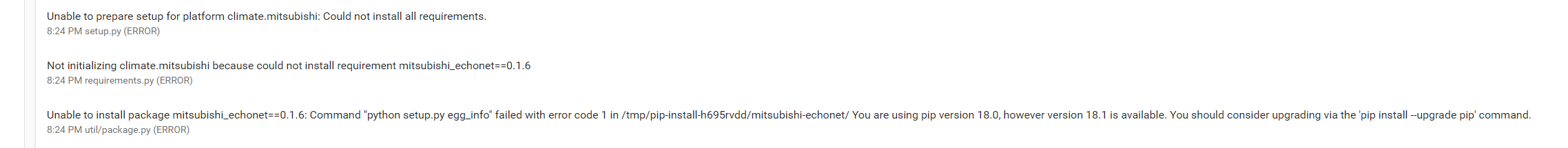

Would you be able to help clarify how to set that up from scratch for hass.io?
I have followed instructions and ended up with
|-config
…|-custom_components/
…|…|- mitsubishi_echonet/
…|…|- climate/
…|…|…|-mitsubishi.py
I hope that’s right?
When restarting, I get the following error:
Anything obvious?
