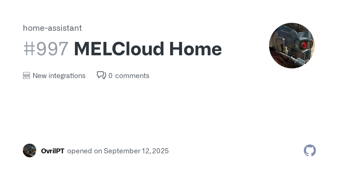

Open a support request via application in order to add new functionality. Maybe if they receive enough request they will do that :crossed_fingers:t2:
I’ve opened one now, thanks for the suggestion:

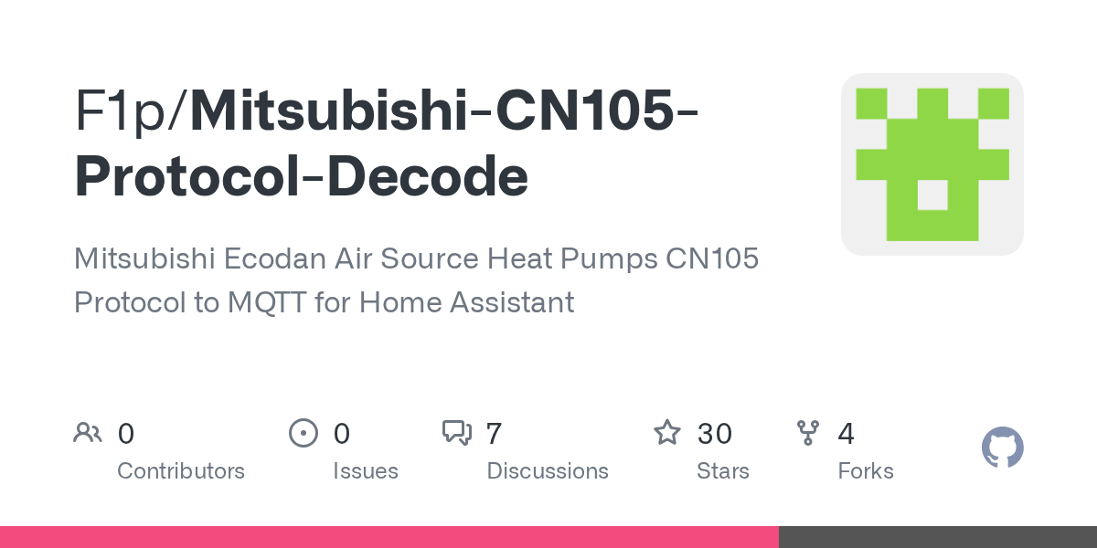

Just use one of the opensource projects for air to water.
Integrating with the new melcloud home will not be that straightforward.

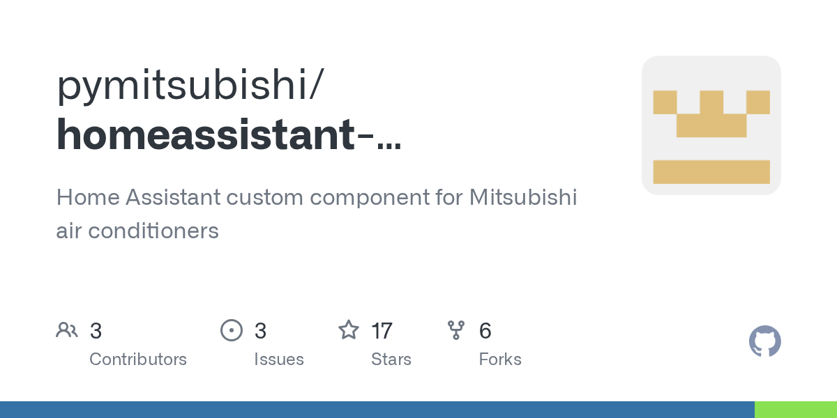

Hi, someone found a direct way into the Mitsubishi devices (local poll), and it just works (at least if your wifi “dongle” is the Mitsubishi MAC-577IF-2E )
maybe some refinement work still needed, but worth a try
Seems to working indeed but some units of mine have double entries where one doesn’t have entries but the other entity does. Do you have the same or know what it means? I’m using a multi split mxz-3f54vf4 with msz-ay indoor units.
Also should they be reset setup to wifi and not added to MELCloud Home or should they be added to MELcloud Home?
