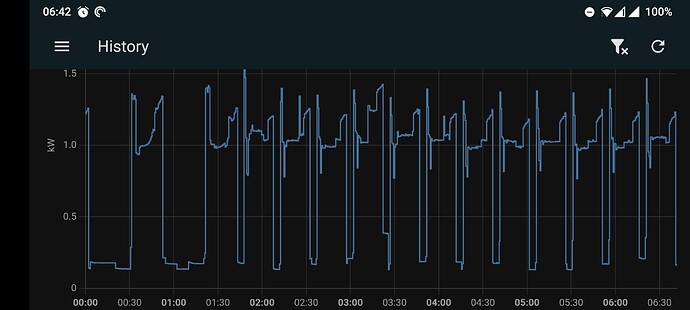

Funny enough, I too experience bad COP, I only get about 2. I’m actually calling my installer tomorrow, I think something is wrong with my pump. It turns on and off all the time. And its not defrosting.
Energy consumption for my entire house. Only heatpump and fridge running;

As it has nothing to do with Home Assistant this is not the place to look for information about that. But your flow temperature is too high or your heat pump minimum power is to high to be distributed in the house at this moment of your flow rate is too low.

Ah yes, sorry. I also believe the flow is a bit low, I only have 9-10l/minute on the max setting, 5. I also suspect that the pump is to big for our house /heating needs. I guess this means that the compressor will break quite quickly because of all the starts and stops.
