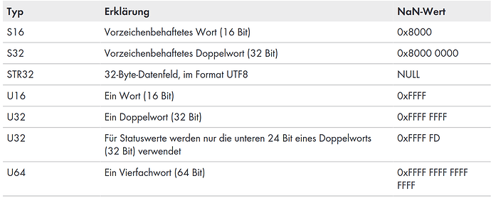

Please read the modbus documentation.
Some Numbers are reserved for NaN (not a number).
0xFFFFFFFF is equivalent to 4294967295 (assuming unsigned 32)
The inverter sometimes delivers such values (depending on the device type) when it is not producing electricity or is in standby.
