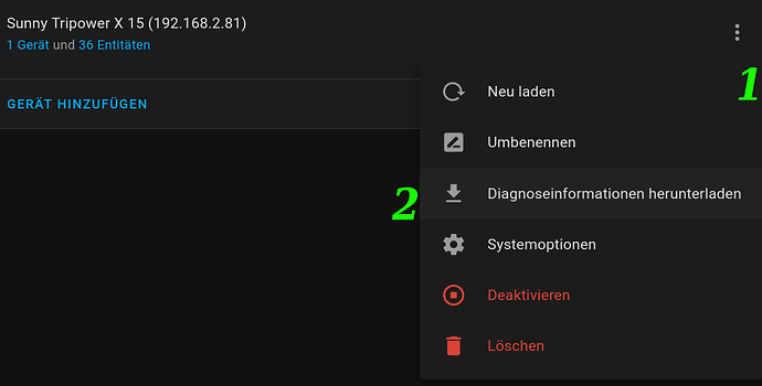

Users of SMA EVCharger or the SMA Data Manager
Since both devices are enneOS-based devices, support for the devices should be quite simple. But I need more information for this. Please add the device as a EnnexOS-based one and then send me the diagnostic information.
Diagnostic
In case of problems, please send me the available log files and diagnostic information.
To access the diagnostic:

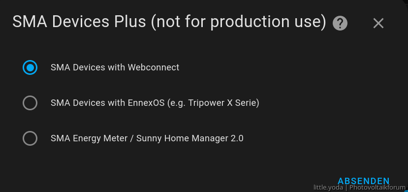

I don’t understand how to add the Tripower X as a device. It looks like this.
go to settings => integrations
press on “+ Add new Integration”
Select “SMA Devices Plus …”
and you should see selection menu
Thank you so much. Had tried that but it didn’t show when i searched only on “SMA”, but when I tried “SMA dev” it showed up. :smiley:
Chose “(eg Tripower X)” alternative but can’t get in. Used the ip-adress on my local network. Used the user password for the Tripower X given to me by the installer. It shouldn’t be my login to the SMA account and app right?
The second last field is incorrectly named. Instead of “group”, the user name should be entered there.
