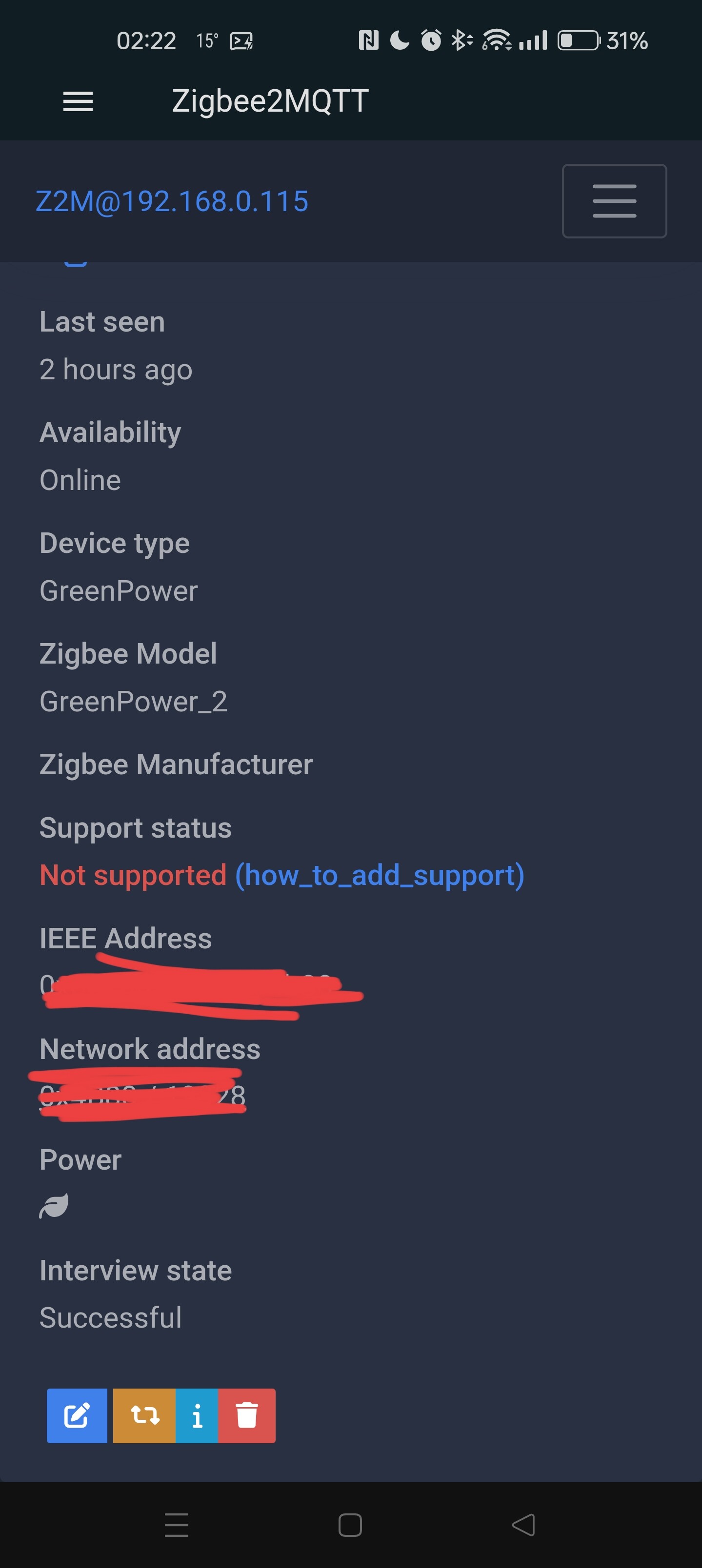

it’s paired but not recognized and z2mqtt informs that the device is unknown.

Exactly the same problem too with a ZT-LP-ZEU2S-WH-MS, a new device is detected each time I click.
I’ve added a custom converter using enocean_ptm215ze as a template (it’s also a GreenPower_2 switch), that fixes multiple-device creation issue and the device is paired, Then I got message ā€œcommand ā€˜33_0’ is not recognizedā€. I’m not familiar with that code, I’ve added extra code based on git example, but each time I press the button I got a new command such as 85_0 or 117_3 so it’s pointless.

I can pair the 3-gang Moes Greenpower switch but it seems to pair over and over with different Friendly Name identifiers in latest Z2M.

Z2M does support ZGP but not these Moes (Tuya) switches unfortunately.

I’ve just bought two of them, and they work quite well (albeit unsupported) in z2mqtt.
