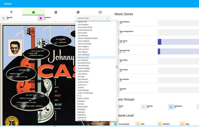

This weekend will be a good time for me to wrap it up and put on Github, I will post a message here after I do. As a sneak peek, here’s a screen shot:
You can now select zone and input independently … meaning I can select Spotify on Wifi and play on Deck and Hot Tub and Alexa/Pandora and play in Kitchen …

I have now added 1500 artist input select.
I have an Alexa jacked into one input on the Dax.
I can set either Pandora or Spotify and select an artist and play.
Through an automation it sends this …
