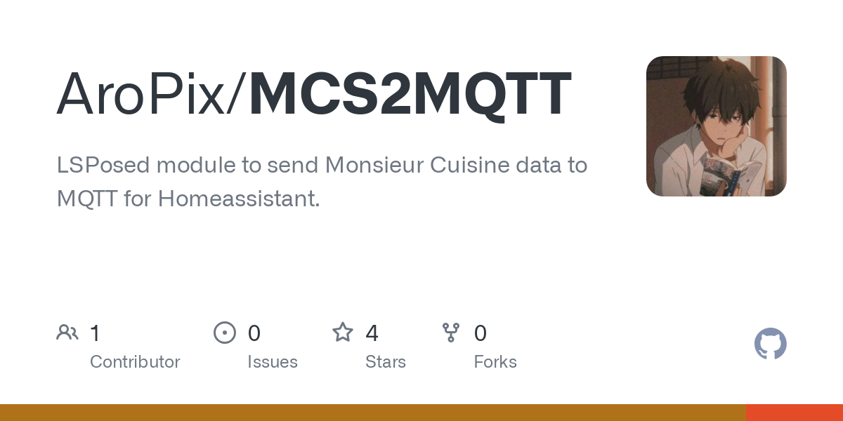

Im working on it, injecting the app and sending the data to MQTT. Thus far i was able to send the current serial data (temperature, speed, weight and so on) and the data of the current recipe (name and so on). You need to root your machine tho. :slight_smile:
This was my first time writing a App for Android and a LSPosed module tho, so be graceful:
